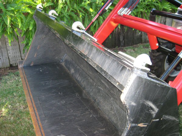

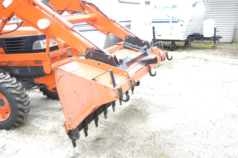

I installed a 3/8 thick 2x2 angle and 4 hooks on my 3215.
/ FEL/ Hooks #4

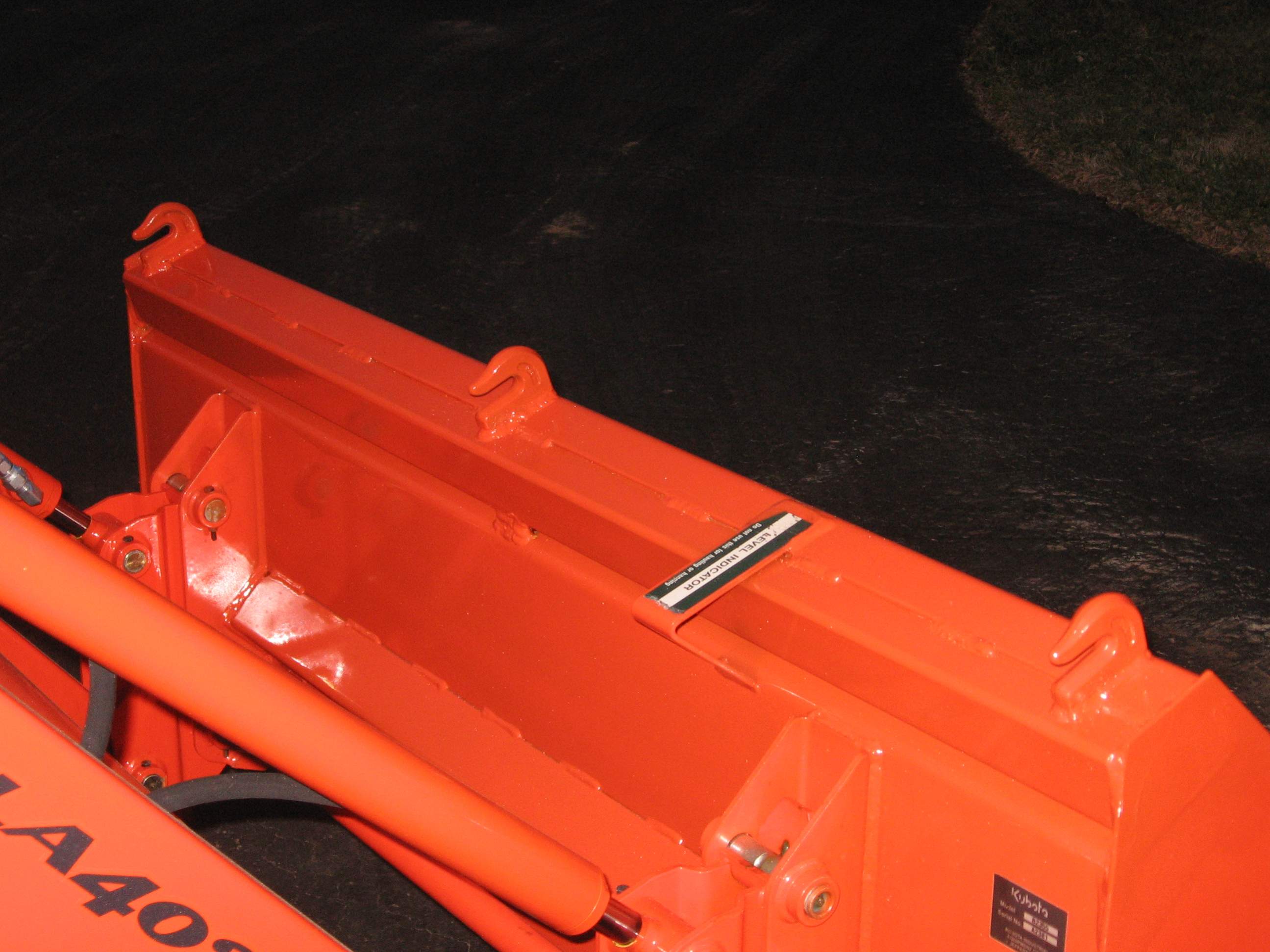

Reinforced bucket lip and used three weld-on hooks. Works great.

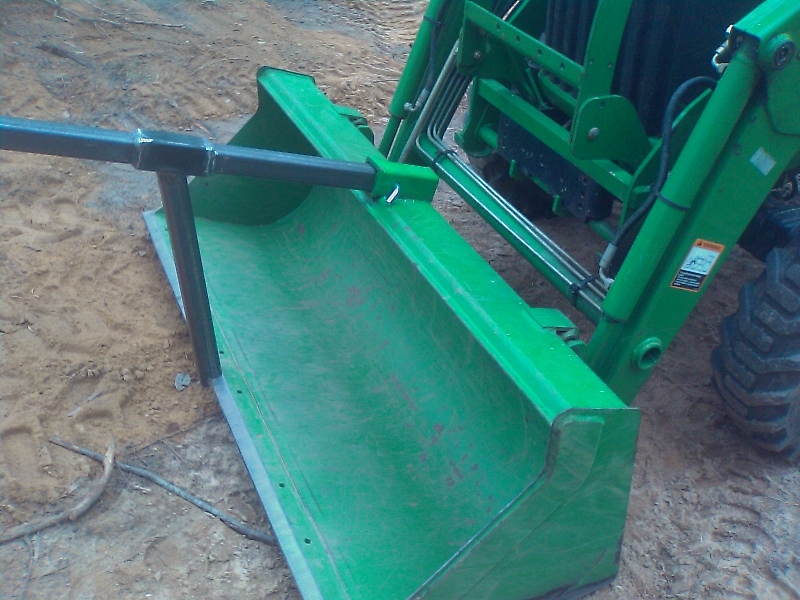

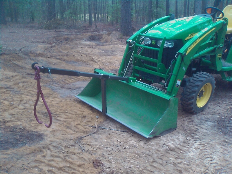

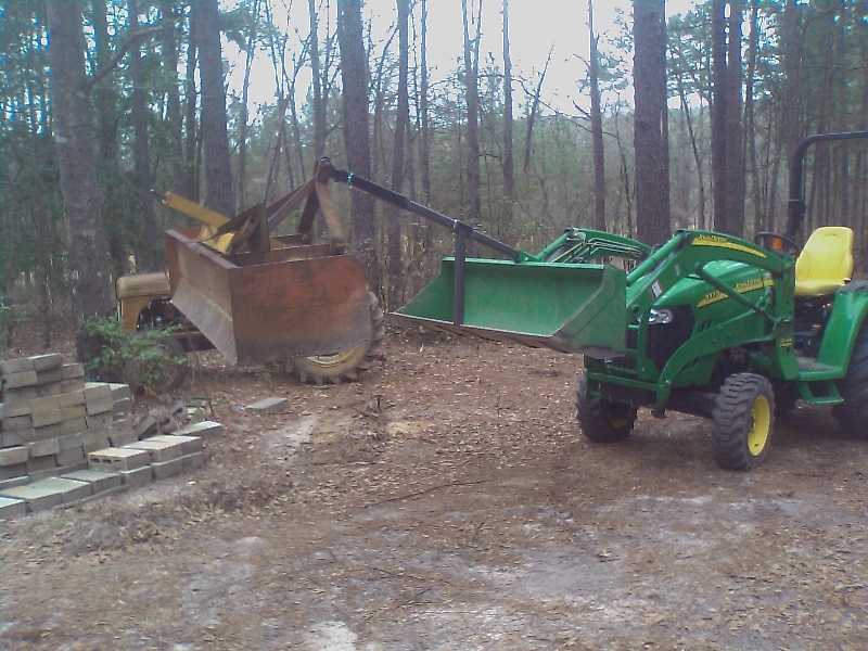

You need a Bucket Buddy. Do a search on the forum. Weld a two inch receiver on your bucket. You can use and make all kinds of attachments then.
/ FEL/ Hooks #10
I added hooks to my bucket and all I did was drill a couple of 1/2 holes for each hook. I may be the odd one here thinking that most of these small tractors don't have the power to lift an item that would pull out four 1/2 in. bolts plus the hook through the bucket.
I've tried :D

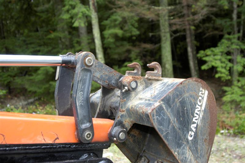

This is my setup, some might call it overkill but it works for me. The slip hooks let my chains level off.
The backhoe hooks are very handy.
