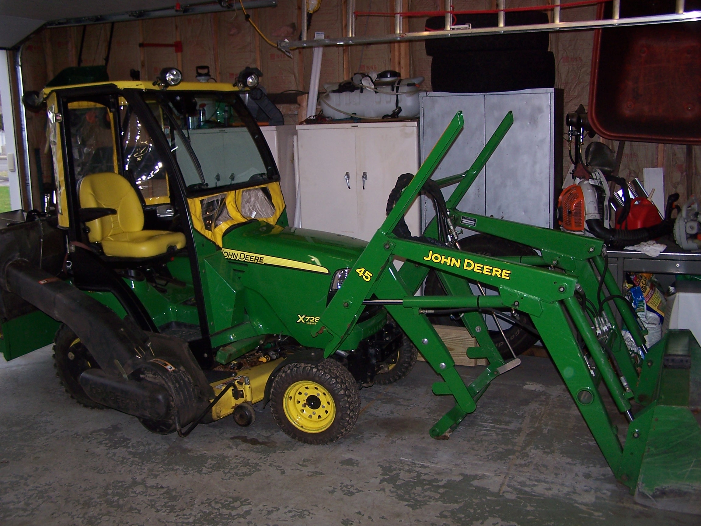

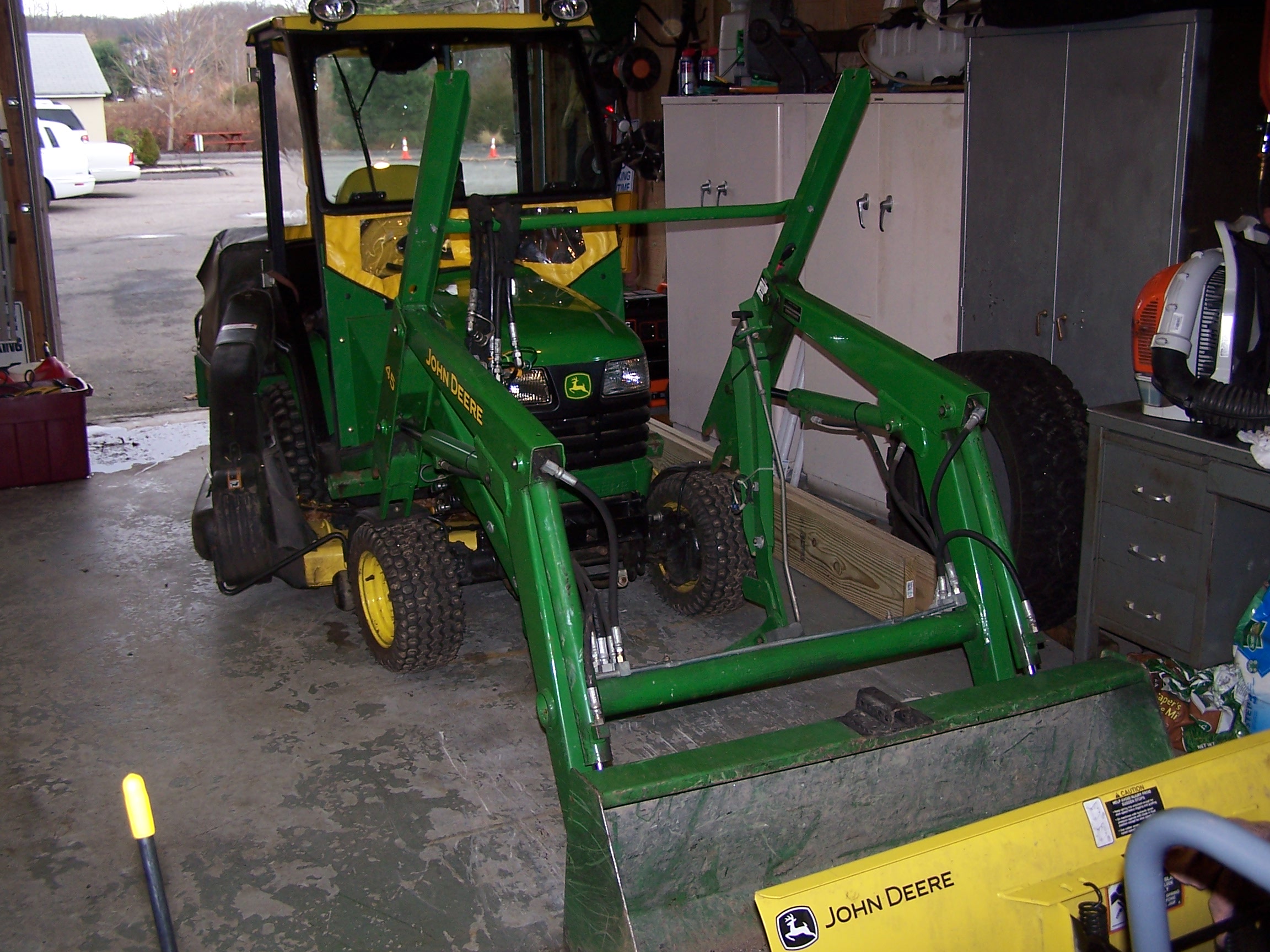

Superduty, I see in your pic that you have yours on with a cab. Do you remove the uprights on top of the loader mast to take the loader off, or just leave the loader on. Seemed like there was not enough room to remove with the cab frame in the way. Just curious, the friend I have with one just cut em off with a torch and mounted a lower side to side support so he could take off with a cab.
   / FEL For X748 #10
I didn't need to remove uprights, it's a close fit with Curtis cab. I enclosed a couple of pictures. 100_4320.JPG
