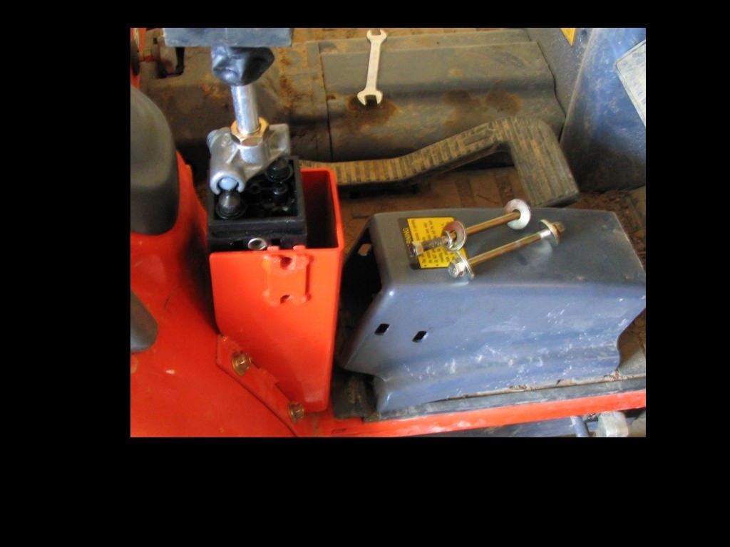

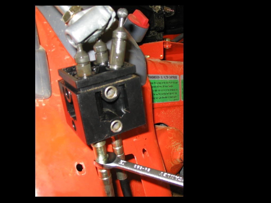

Being a PC geek I tend to call it a joystick, anyway whatever ya call it. It broke. It should not have... after looking at it closely I determined it was installed improperly at the factory. It should have lasted mucho longer then it did.

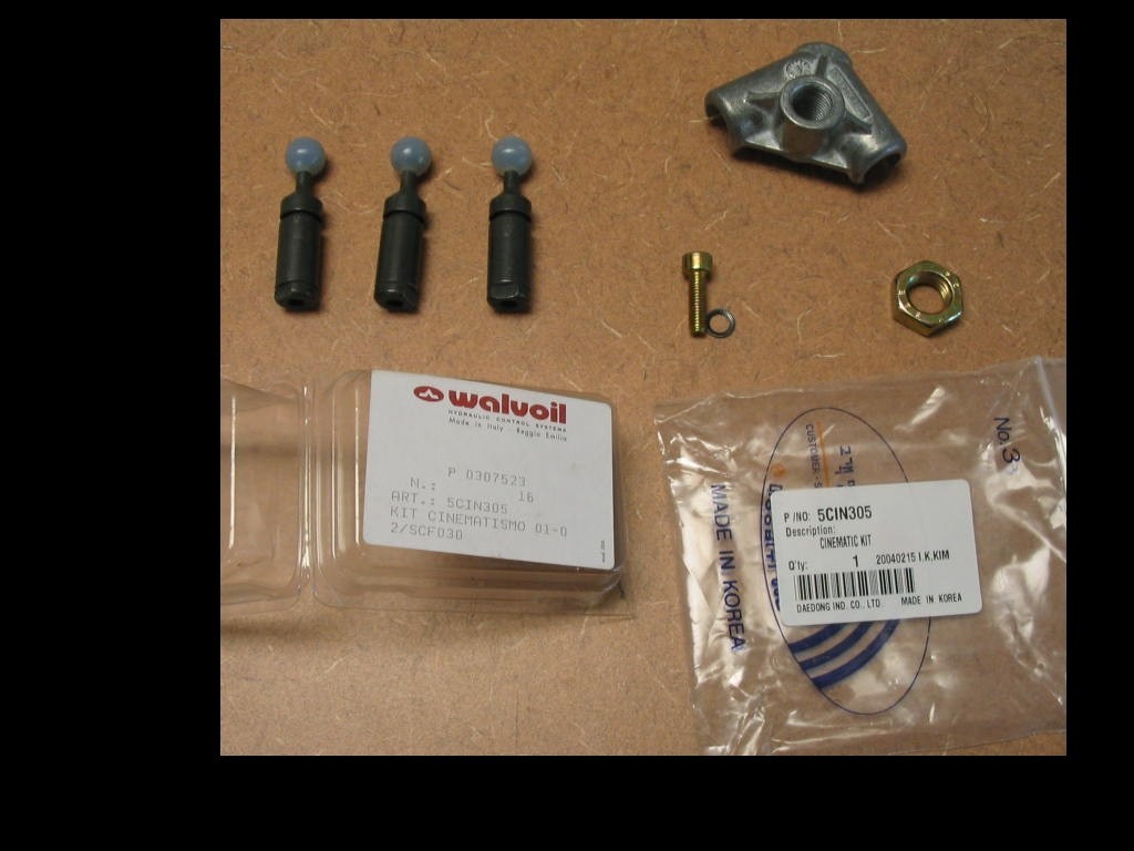

So I contacted Carver Equipment.com and they sent me these new parts. It took 5 days and cost me nadda... warranty is kewl. However, I would like to point out that Terry at Carver was a great help!

So here I go to replace it, first the cover
   / FEL Controller Replacement
Now the hard cover

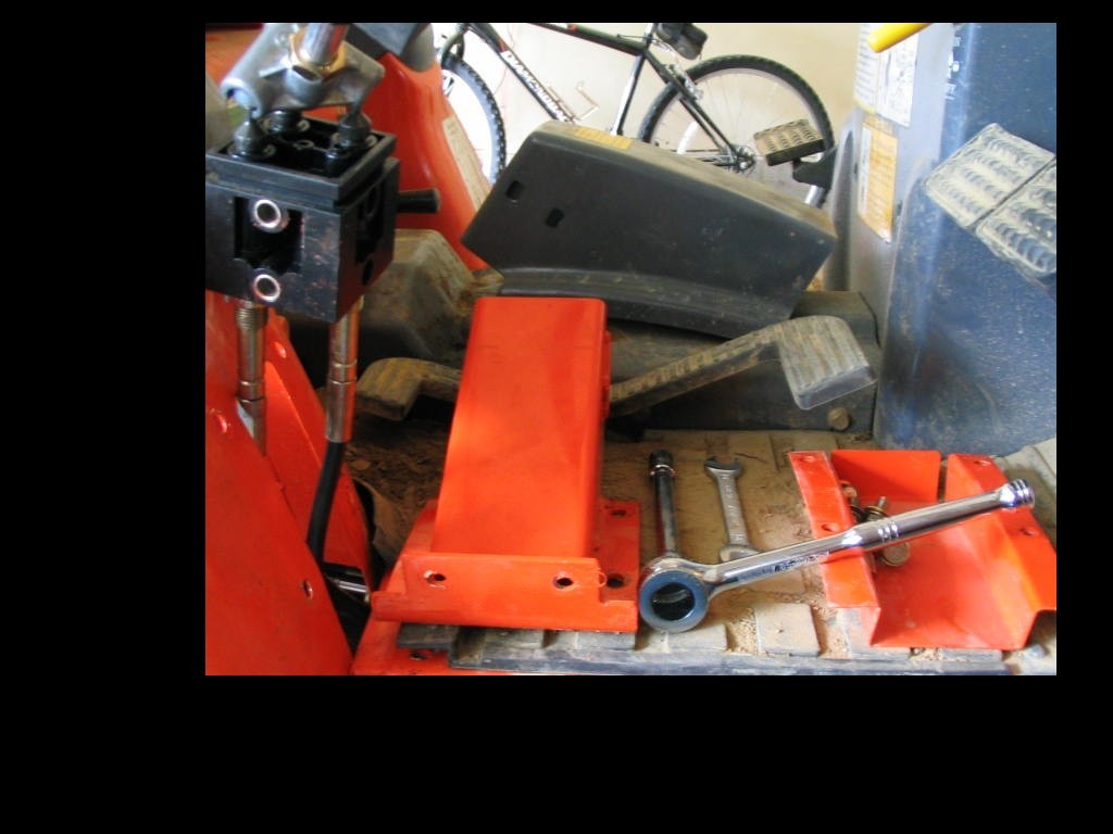

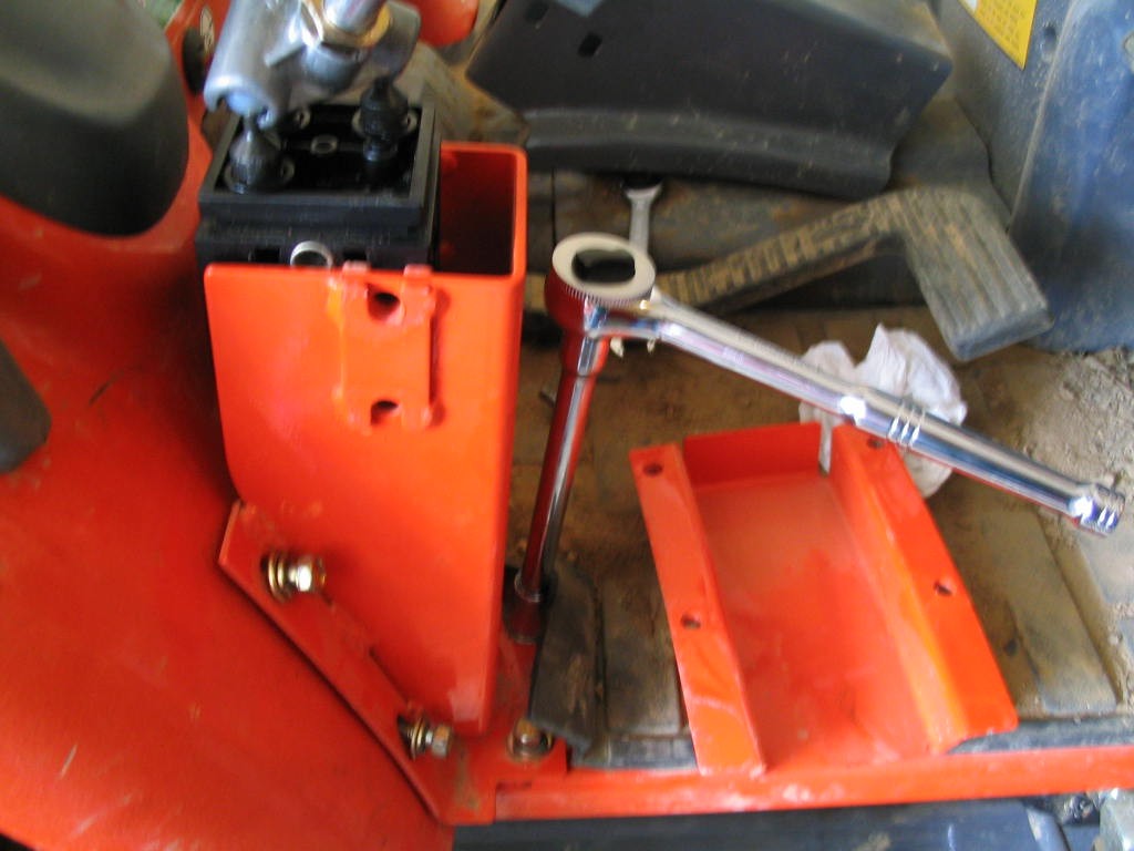

This is a shot of the case and metal cover off

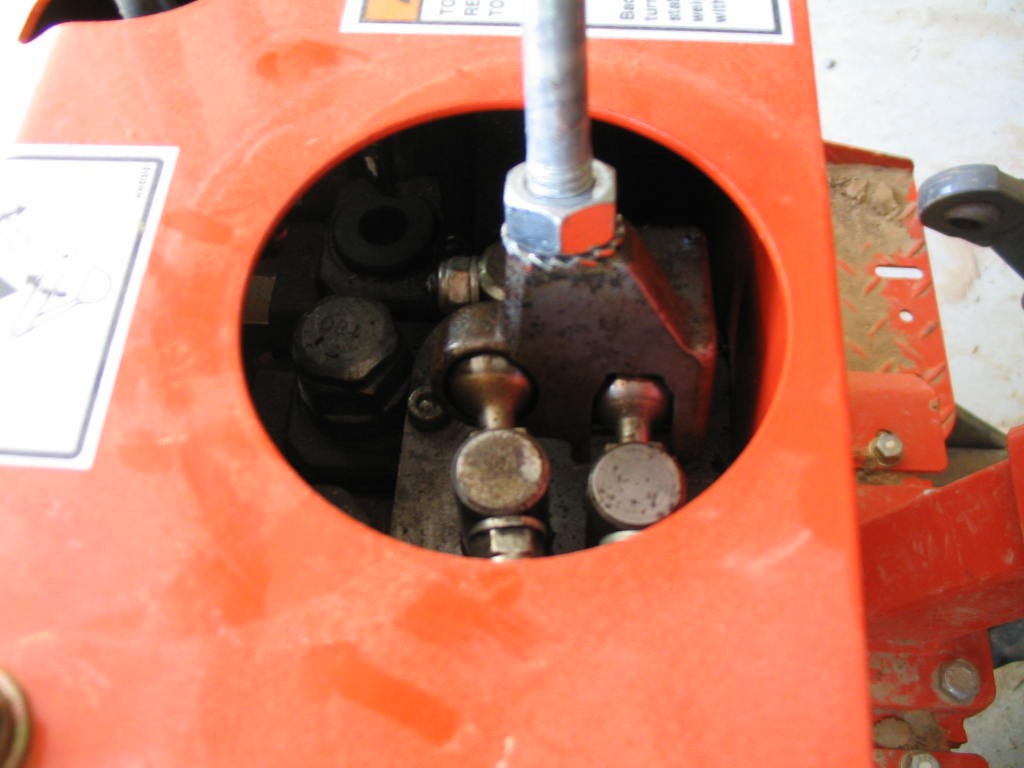

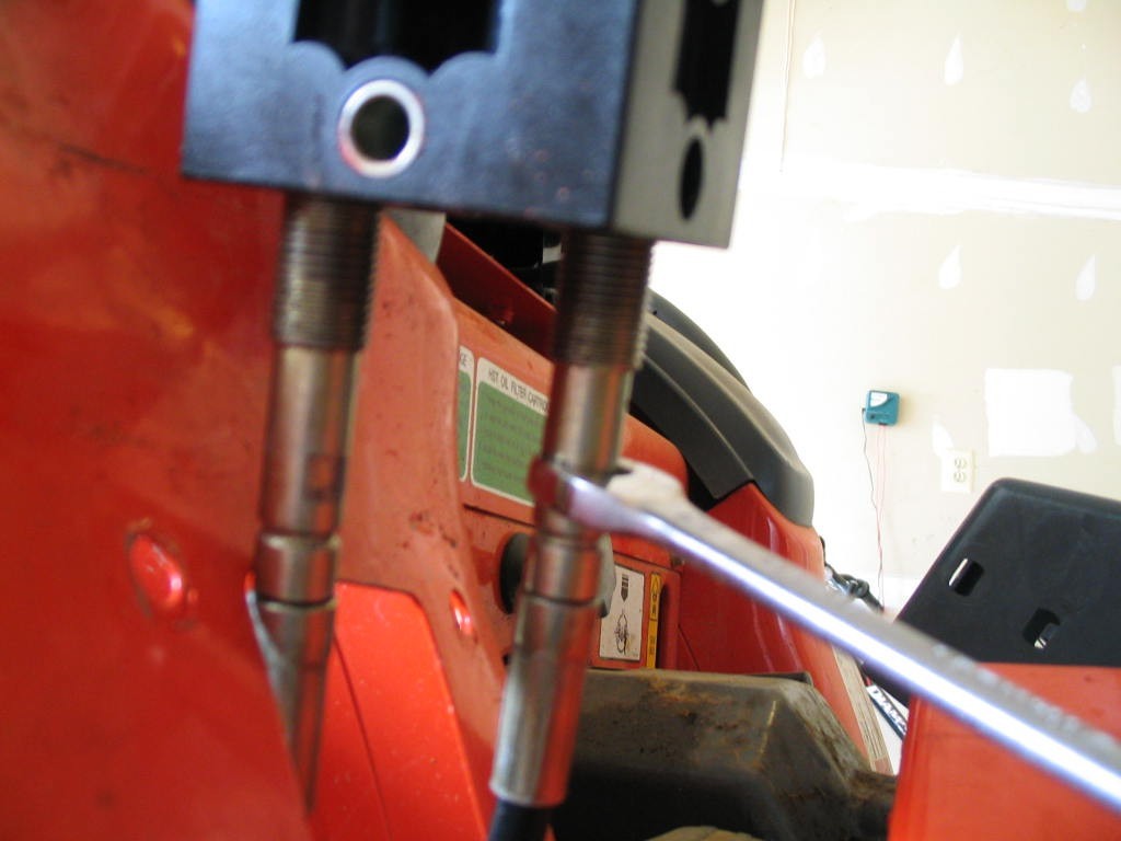

Loosen the cable nuts

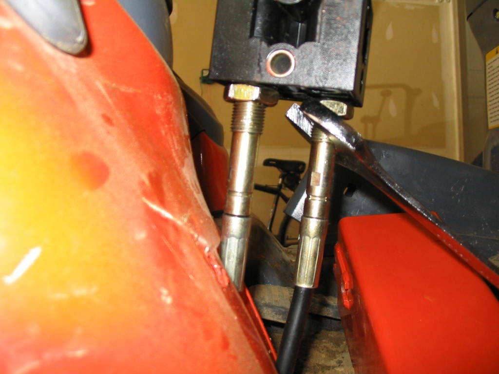

Now tighten the cables so that they protrude upward

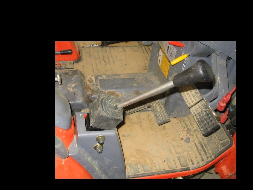

Once they are elevated the pivot pin can come out and that will free up the controller handle

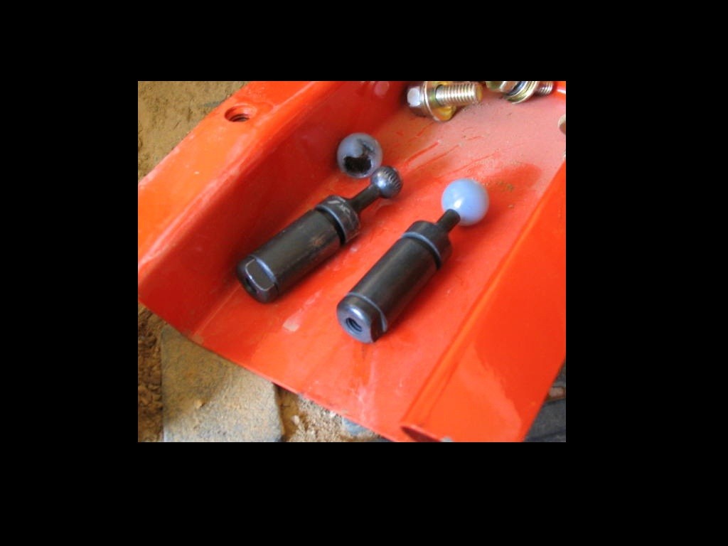

#9
comparison... as you can see it's broke... however a closer inspection reveals that it was forced on during installation... maybe a disgruntled employee, lol
If it were up to me it would look the BH pivot pins... here's a look of what they look like... metal not plastic
