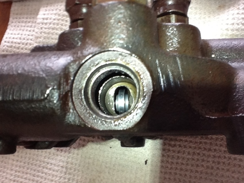

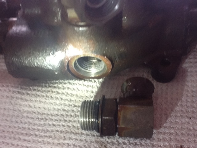

Ok, I would like to thank everyone for their help trouble shooting the valve. The issue is there no power beyond adapter installed so the out port and pb are sharing the same plumbing.
The valve manufacturer is out of business and I'm having trouble tracking down the fitting/adapter. So I may just end up replacing the whole valve. What do I need to look for when shopping for a new controller?
Or, is there a way to 't' the line into the FEL control that would basically select power for the loader control or the 3 point hitch? I could just plug the pb port on the loader control in this scenario...

Have you told us the manufacturer of the valve?
#1 Find a PB sleeve for your valve.
If you cant find a PB adapter for the valve, you can do this, but is not recommended as you will be using the OUT port as the downstream supply, and cyl fluid dump.
The OUT port normally has a pressure rating for about 500 psi. Back pressure from the 3pt could raise it to 2500 psi.
#2 Plug the the PB port with a short plug so as to let the main galleries and the cyl fluid exit the out port.
Then feed the remotes or 3pt using the OUT fluid from the FEL valve.
#3 option, replace the FEL valve with something like this.
This is a 10 GPM joystick valve with float.
Surplus Center - 2 SPOOL JOYSTICK BRAND LV22TSTKAB LOADER VALVE

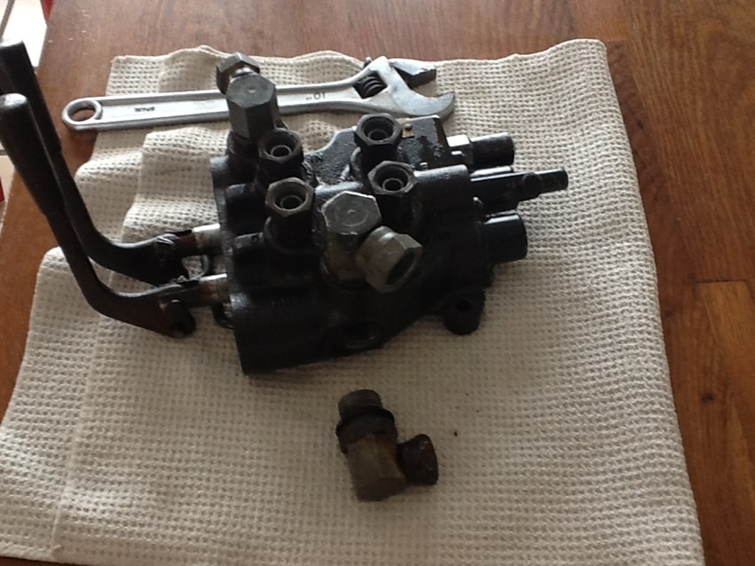

Hey Neil , want to part that puppy out if your upgrading? I'd love to track down this part rather than upgrade...

Unfortunately mine doesn't have the PB port.
This is what mine looks like.
/ FEL Control Question #30
Your valve doesn't have load checks, you well not mess it.
/ FEL Control Question #31
load check? (had to google it)...
hmmm... Is it the "lack-of" load check that causes the bounce I've been experiencing if I don't baby the control valve?
/ FEL Control Question #32
I would think maybe it could. Without load checks if you just move the lever real slow and just a little the load could go all the way down. They catch and hold the load when you go from down to up.
