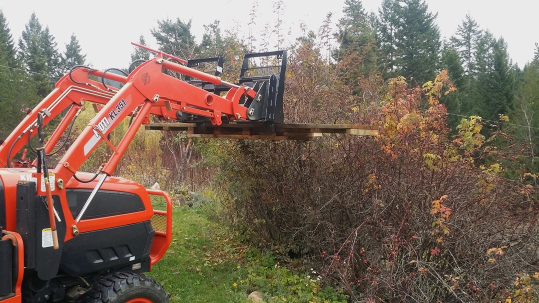

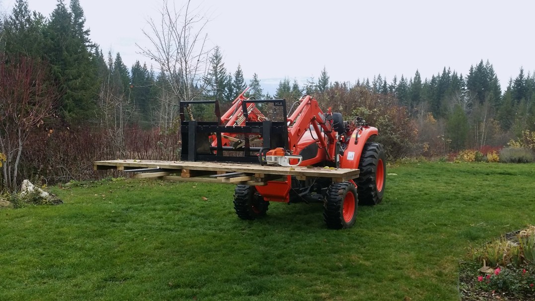

I also use the front end loader as a work platform. I agree there are risks but consider it less dangerous than trying to work from a ladder. I climb onto my platform by going over the hood and loader arms. I do want to get a ladder to avoid that, and I do agree loader lock arms are a good idea. The Buhler loader on my previous Kubota L275DT had a loader lock device that fit over the rod. Here is a link that shows it:
http://www.tractorbynet.com/forums/safety/339061-f-e-l-failure-fatality-post4220825.html#post4220825
One possibility might be to fabricate an adjustable ladder that acts as a lock while spanning between the grill guard and the loader cross member near the end of the loader arms.
I worked from the bucket until I got pallet forks this year. While doing renovations this summer I removed a section of our sun deck and I ended up with a handy 2' x 10' section that makes a great platform. I used it today to trim shrubs:
