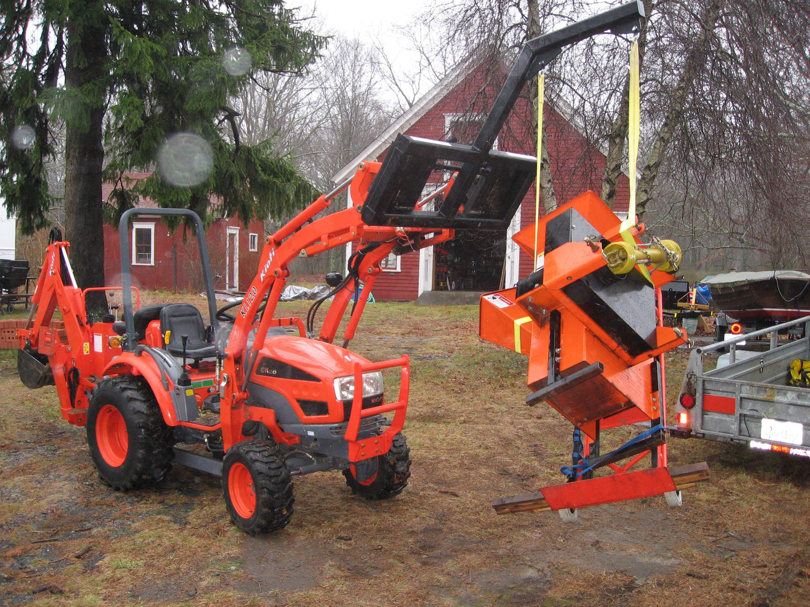

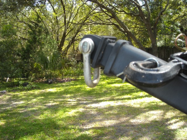

On my tree boom, there are two shackle/clevis attachment points. Works well as you can either secure a chain directly or thread either chain, rope or tow strap through the shackle. I don't have a chain hook mounted on top but that would be convenient to secure the chain after it passes through the shackle. I don't have shackles mounted in the photos below but that is how I usually have it rigged.

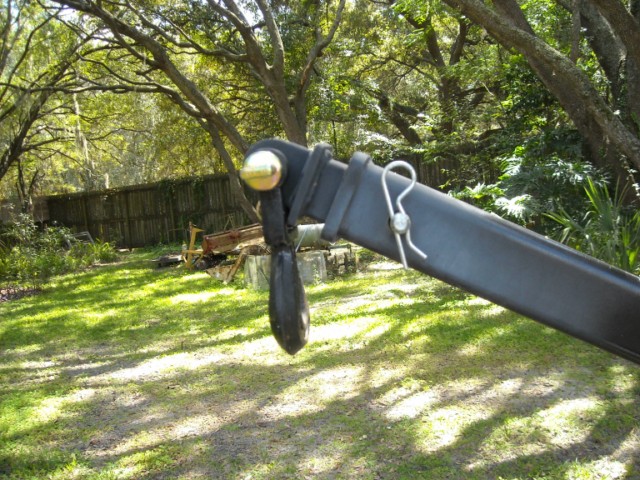

As mentioned earlier, sometimes the angle of a fixed hooked position could result in lifting chain, strap, etc, to slip off, it only takes a few seconds to remove the hook and add clevis.
This is why I like the receiver at end of boom, it allows a multitude of options with little effort to change them.
whiskywizard, keep that open mind, I think you're doing a great job and when complete, keep heavy items as low to ground as possible and front wheels as straight as possible.
Once you get the feel of your tractor and how it handles, you might go back and tweak a few things.
Good luck and keep up that positive attitude :thumbsup:
You also picked up about 300 pounds of extra lifting capacity by not having to lift a bucket as well. With that size tractor, perhaps the OP should build a rig like yours or utilize a boom pole off of the 3 pt. hitch. You can get plenty of height and the 3 pt. will lift several times as much as a pole going out from the end of the FEL bucket.
I've been there, done that and have the scars and broken bones to show for my learning curve. I have to agree that a cheapo engine hoist from ole Horrible Freight would be the way to go and a safer way. But, since I certainly bear the injuries from trial and errors, I also understand the 'I can build that' desire. With that, I'll just wish the OP to be safe and consider buying or renting the correct tool for the job. I've just gotten to where I no longer like pain. It really starts to hurt after a while. ;)

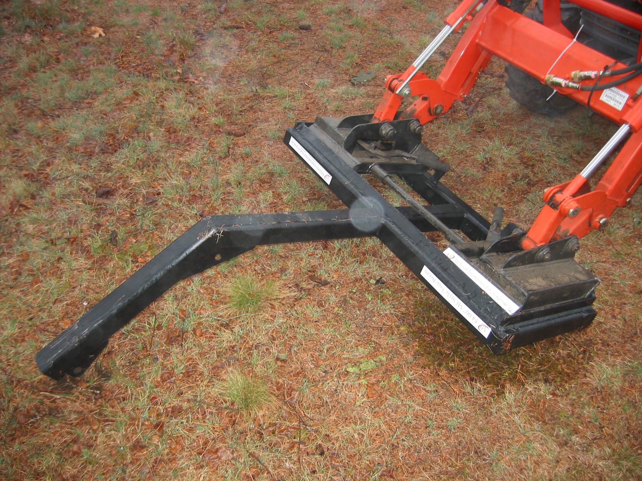

Yep. The tree boom I posted photos of was not real expensive though I forget the exact price. The other implement I have is shown below. I don't even know what it is called but it allows you to mount either a 3PT attachment or 2x2 receiver hitch items on to the FEL. Just a 2x2 pole with perhaps even a ratchet strap reinforcement from the end of the pole to the topping lift point would be plenty strong for a 500lb lift.
Nice!! that's a slick setup if I say so.
   / FEL capacity with a boom #60
I got it from Rick Wallace. Don't know if he still carries them, whatever they are called.
I use mine primarily with my landscape rake as shown in the photo. Very much more precise than dragging the rake behind the tractor but of course useful mostly for small areas.
