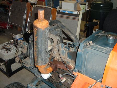

I'm going to turn the muffler 90 degrees and point it toward the front. I think it is in the way sticking up. See pic as is now.

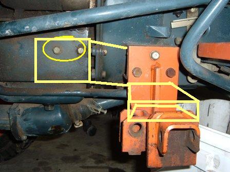

My plan is to strengthen and add steel to the existing brackets. They are currently bolted to a bracket that is welded to the bell housing. That looks too weak for a fel to me, so I plan on adding steel to this bracket to allow it to also be bolted to the frame forward of the bell housing (see yellow paint on attached pic). Then I'll add more steel to the top of the bracket to provide more strength and a place to mount the fel towers.
My drawing is crude but I think I would use 3/8" steel to make the additional mounting plate to the tractor frame and probably 1/2" plate for the bottom of the towers welded to the top of the current mower bracket.
Does that make sense? Sound OK? Looking for advice on the bracket. Thanks.

Still hoping to get some advice/feedback on my plan for the bracket modification from folks. Ideas/comments?

Thanks Scarlo101. I remember looking at your build a few months ago. Took another look at your web site tonight. Nice job. It's encouraging. I was out in the garage doing more figuring and some prototyping with 1/4" hardboard. I'll keep scratching my head and will come up with something that seems strong.
I just don't trust the mount to the bell housing. It is 1/8" steel welded to the housing and then a hefty bracket for the mower bolted to that. Fine for a mower but just doesn't seem like enough for the loader stresses.

Thanks GP and MX. GP I agree with you about the strength of the bell housing. About 5 years ago I built another loader frame on an old farmall. Some of the bolts bolted onto the bell housing and I was never too comfortable working it too hard because I was afraid breaking something.

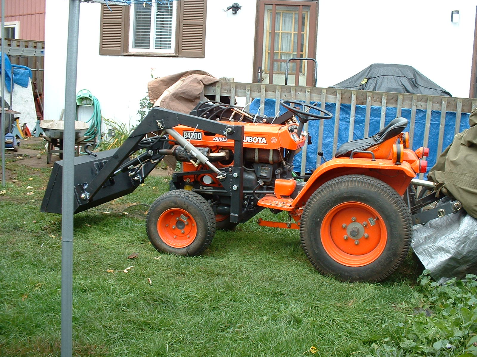

As your B6200 is a bit bigger then my B4200. Anyway this picture will give you a better idea of what your up against. I have broken the welds at the transmission Bell housing. As I don't use the MMM that came with the tractor I ended up extending the mount so it is supported at the front bumper, Transmission, and MMM mounting location not shown in this early picture. This build used no plans but has worked hard for me for about 7 years.

I need to add as well that these mini-tractors can be overwhelmed quickly with a loader so while I know the MMM is about 250 lbs, you might want to consider a counter weight or rear blade to make the tractor more stable. Without my rear blade it will lift a rear wheel easily and becomes unsafe. My kubota has only a hydraulic filter screen. Perhaps an external filter would be a good addition.
