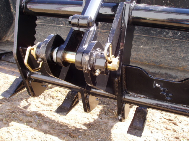

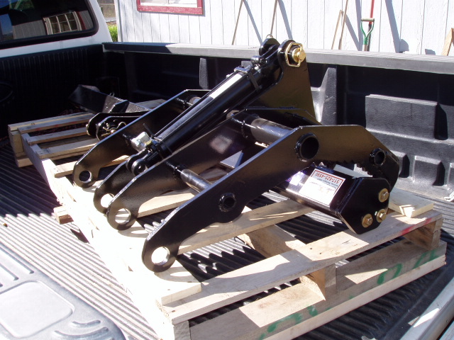

From the design to the freight depot to the bucket mounting:
2002 New Holland TC40S w/ 72" standard bucket.
Michigan Iron and Equipment MIE LBG-72, a 24" grapple with a 10" cylinder stroke.

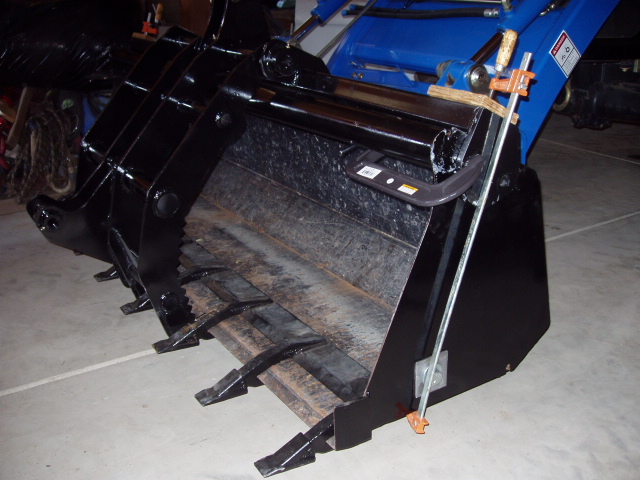

I did a lot of reasearch on this type of FEL grapple and landed on MIE to do the build. Their approach to me was quite effective as they were the only company to ask for a full size loader bucket side profile which I did in cardboard, Exacto Knife cut into five or six pieces and marked edge to edge (puzzle style) so they could re-assemble what I sent to them in an 8x10 envelope. The side bucket profile was then handed over to their engineer and I was then sent an engineered pdf to approve-I did make a few small dimension changes and then it went into production. All of this was because they had not yet built one for my model of tractor bucket.
The grapple came with a well written owner's manual/installation instruction booklet and a set (2) of plate steel load bar drilling templates-I did not use them but elected to fit/mock up the load bar with my shop clamps and then drilled the bucket holes to my findings. Do notice the zirk grease fittings!
Today I had the last set of hoses pressed from the grapple to the torque bar so I am done with the hydraulic fabrication phase but several more posts to follow including custom built (hacksaw, grinder and file) bulkhead fitting brackets cut out of standard sized steel pieces, routing, etc.

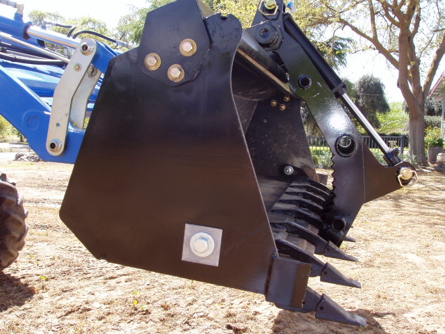

Nice looking grapple. It seems like a lot of force to be going to the bolts tho.. I bet you end up welding it on eventually.
/ FEL bucket grapple installation
Hello jake98,
Before I received the grapple, I asked MIE if the bucket mounting bolts were supplied or do I need to buy them myself and the answer was that they were supplied so I took it no further as to the size required. They are 1/2" grade 8 and I too think they should be at least 5/8" even better 3/4" and I have plenty of room to drill them out, the side ears of the box beam are 1/2" thick. I intend to start out tender and work up to some stump carrying. This is not by a long shot their first grapple build, just their first for my NH bucket style. Thanks for your observation.
/ FEL bucket grapple installation #6
Good observation on the bolt size...
It's by design. Every piece of equipment needs a designed in "Fail-Safe", i.e -shear bolts on a PTO drive-line. On our bucket grapples, it's the side-wall bolts. The design of a bolt is governed by 3 criteria, shear / tension / and bearing. With the thickness of the bucket side-wall, we decided to size the bolts a 1/2" Gr 8. In straight shear, the combined sidewall bolt capcity exceeds the cylinder pin shear capicity. Since the bolts have an eccentric load, the pattern is designed to shear the front bolt before the cylinder or the cylinder pin are damaged. Easier to change out a bolt than deal with an expensive repair to the grapple or the loader bucket.
We have never had a bolt fail ...that we know of.
Just our design approach, it has served us well.

Glad you came in to the 1/2" bolt question-saved me a phone call. I would not had done any drilling without running it by you first.
I'm down to final tightening on the hydraulics-so far so good-It's been a long process but I am very pleased with the outcome.
