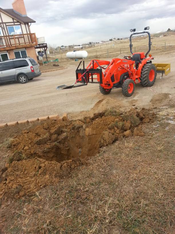

Always enjoy a good fabrication story. Got a quick spade to try years ago. Handy planting some fruit trees. Most handy for reaching near or under fences to cut or remove trees or brush. Could reach where grapples or bucket couldn’t or cause collateral damage. Surprised how thick a root it could slice through after sharpening the edge. Had to reinforce the bucket on the Kubota B20 after bending then straightening the bucket cutting edge. Will not fit the current double cutting-edge B26 HD bucket. Also fits pallet forks but haven’t tried that feature.
If transplanting always prune back heavy for best results.

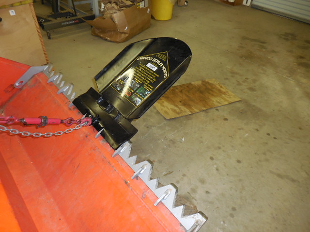

I don't want to rain on anybody's parade - yet... but I just bought one of those clamp on shovels for my Kubota L3400. So far I'm having trouble justifying it. Its been raining here for the last month or more so I haven't really had a chance to give it a decent try.
Thinking that the Piranha tooth bar wasn't letting it sit solid on the bucket, I cut out two slots on the buck to let it sit flush. That looked pretty good, but not a totally flush surface for the shovel to sit completely flat. First timeout with it I broke the tie-down chain holding it in place. Next try I took the Piranha tooth bar off and mounted the shovel on the bucket - as intended by the manufacturer.
The shovel may prove out to be worthwhile, but with my 10 minute use, I'm having doubts. Hopefully next week we'll have enough dry days that I can give a better evaluation. For sure though, I don't expect to get the same fantastic results as the guy in the first message video has.

   / FEL Bucket Clamp on Shovel #19
Durabilt Underlift Ratchet Chain Binder — 6600-Lb. Load Capacity, Model# LDR-UR-38 from Northern tool.
Using a chain binder like this is handy attaching a quick spade to smaller height buckets.
   / FEL Bucket Clamp on Shovel #20
Little Massey in the video did a great job of removing that bush. I suppose one could rent a power shovel/hammer and screw with it for an hr of backbraking work. Could maybe rent a small towable hoe if one was available, not as efficient on that kind of job though. Bucket shovel to the rescue. Now on my list of things to build. We do have a Case 580 Extenda hoe here for serious ****.
