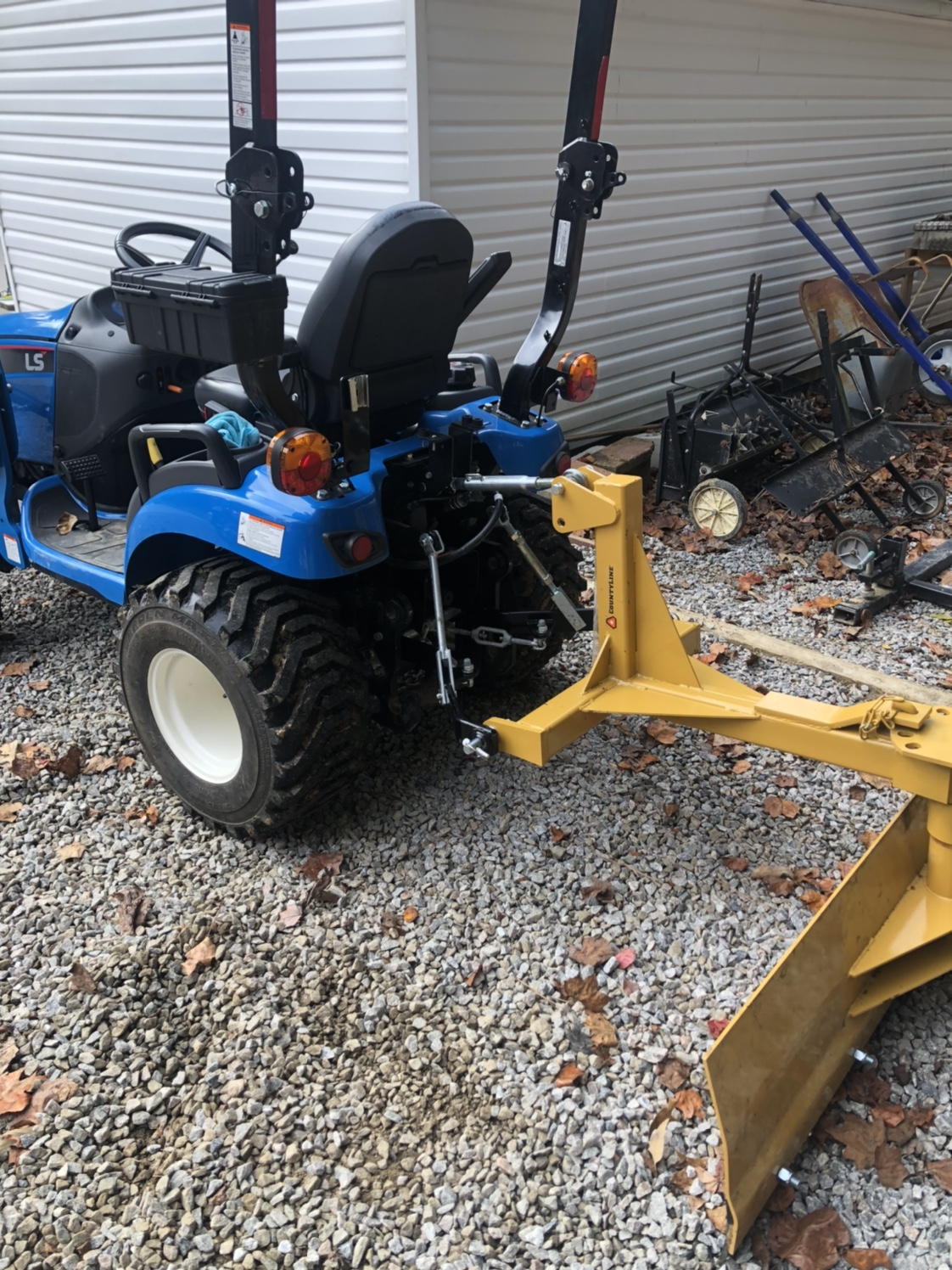

I installed the County Line 5ft grader blade today. I was a little concerned that the blade would not lift high enough, but it raises 15in from the ground. Played around the yard a little to see how well it handles. Messes a lot of yard up, but I will have fun fixing it. What is there out there that I can but on the blade for snow removal? I’m afraid the medal blade will damage my asphalt drive way.

You could get a poly edge to bolt on for a cutting edge.

I ran a slightly wider county line lightweight blade for years behind my L3410. It was fine on pavement with the steel edge, and great for pushing snow backwards into the grass without damaging the turf.
Currently I use UHMW polyethylene edges on heavier blades. The heavier front and rear blades with steel edges will mark up pavement, but not real damage.

If anyone buys the 5 Ft blade from Tractor supply, I would suggest also buying a new top link that is slightly longer than the one that comes with the tractor. There is literally no tool for adjustments.
