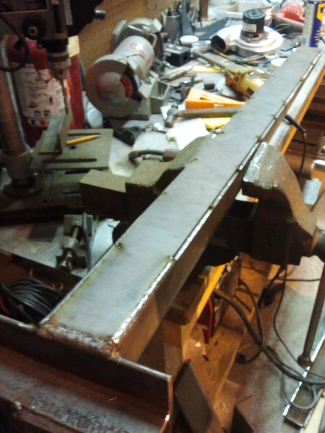

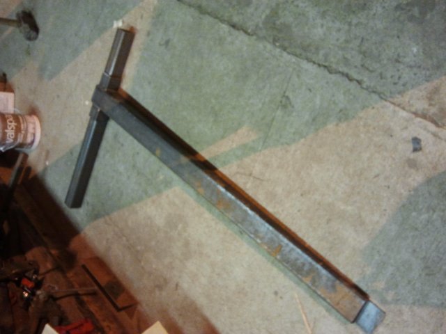

I started construction Sunday afternoon. Progress so far:

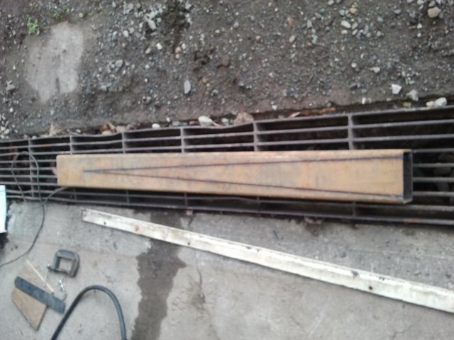

Forks cut from a 3"x5"x0.25" box tube. 3" wide 48" long, 2-1/2" at the big end tapered to 5/8 at the small end. (Love that plasma cutter!)
Notched to to fit over 2x2 frame rail

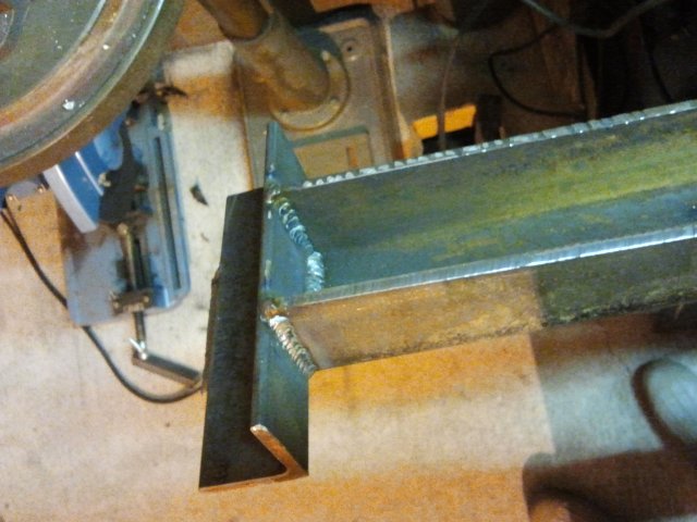

1.5 x 1.5 x 7" angle welded in the notch to reinforce the "big" end end, and will keep the forks aligned perpendicular to the frame.
Boxed with 0.187 cut from plate. (Welding out the boxing tested the dutycycle limit on my MIG... DOH!)
Then it was time for supper...

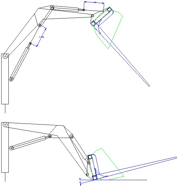

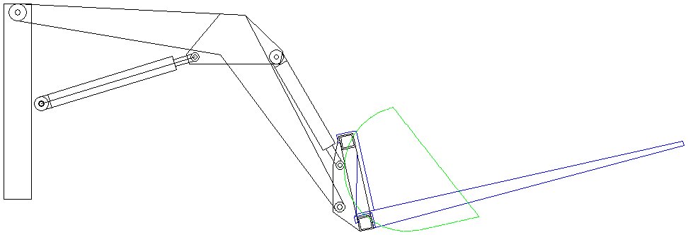

   / FEL/3pt pallet forks build
Design sketches showing angles at extremes. I tried to spread the loader arm end to curl cylinder end as far apart as possible to get as much "curl" force as practical when the forks are level. They should tilt up 15 degrees and down (loader lifted high) to 45 degrees. We don't have any hills steeper than 15 degrees, so I shouldn't loose anything off the front :D
I think I've figured out the fork root to vertical member... sure would be easier if they weren't removable! The downside is the load will be 2" further forward than if the forks were welded/integral to the frame.
