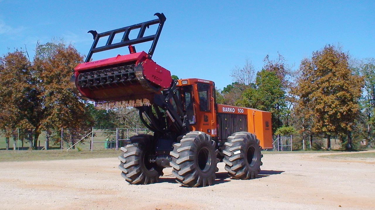

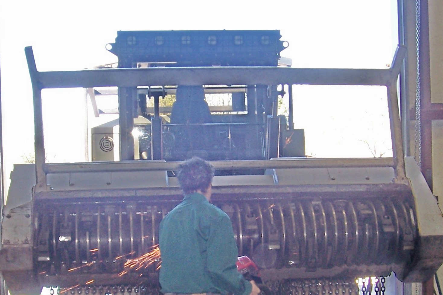

Get one of these and you can mulch the Gyrotrac! Notice the smooth drum in a Fecon housing.

3. Barko makes a BAD tractor! If you would like to see the most productive mulching monster made put one of our heads on that barko and get out of the way. I hope to have one mounted on a Prentice 2864 soon and can give feedback. 100" cutting width, twin hyd motors, 85 GPM @ about 5000psi. I have seen one of these units personally mulch 3 12" hardwoods at once and not bog down, that was impressive.

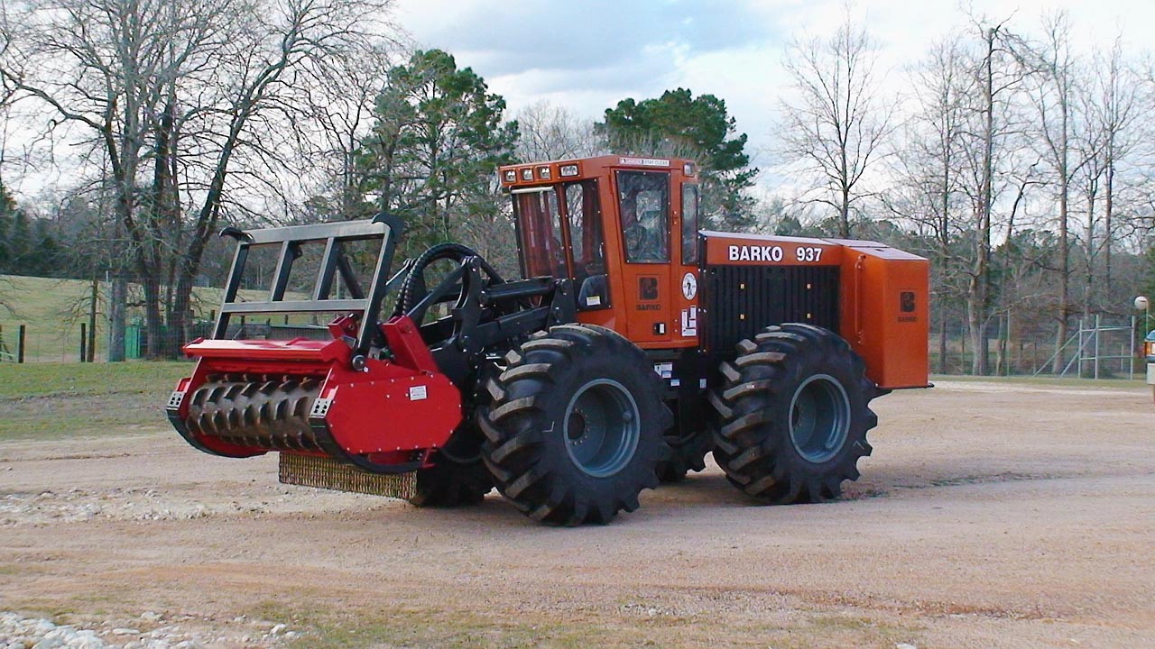

Yes a excavator is more efficent. Jon is right, turning a level turret is much easier than moving a 10k machine on 6' of tracks while raising the head and running it. You mulch on the down swing with an excavator so all your driving hyd is the head. Your only opening the sylinoid(spell) to let off pressure to boom down.
Also here is a picture of our big boy. A DAF-250Ex

I sure do love the looks of the Barko, they had some overheating issues on the early machine but everyone says that they have fixed that and it is now the best tractor on the market.
