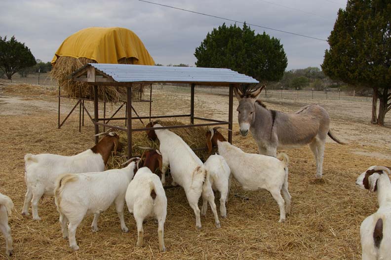

Hey Jimg, before you go spending your $$. Here is a square bale feeder you can easily build. The tin roof is to protect it from the rain, huh? What is that? I have forgotten.
Feeding cattle, you would probably have to use heavier steel. This one is built with 1 inch square tubing. You can't see them but it is bolted to landscape timbers so it can be skidded around.
Take a look.

Thanx for the pics! Was planning to build rather than buy. I like your setup w/ the roof. Would modify it a bit so the cattle would have to put their head into the feeder to get hay. That way they dont pull it out and onto the ground. Thanx again!

Looks like those goats would rather have it on the ground. :D
   / feeding square bales #20
You are right, Willl. They would rather have it on the ground for bedding and a soft landing area for their solid and liquid bodily wastes.
It stays in the feeder.
