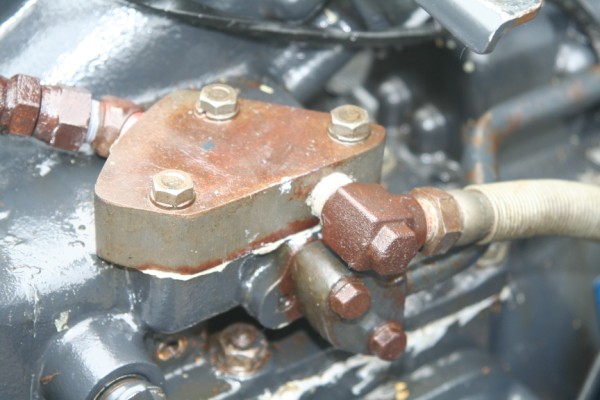

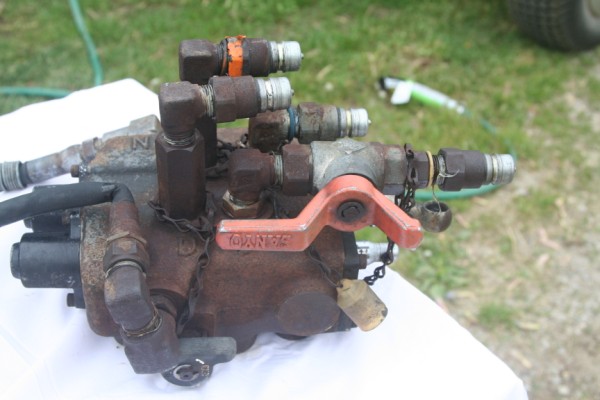

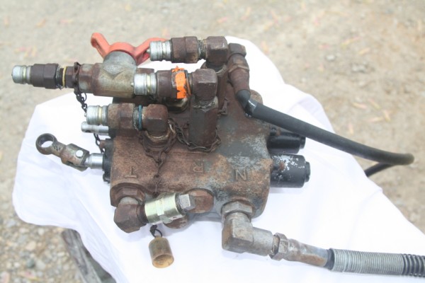

Hi I have put a line as I said in the previous post on the manifold. The 3pt is still not working. It will raise slowly if I run the tractor at full throttle but even then only sometimes. I guess its time to pull the cover off and have a look at the valve. Is this something I can tackle-I'm talking about a basic pull it apart to see if its a broken/stuck O-ring etc before I call in an expert. Already had the cover off the piston- there is very little flow from the outlet that feeds the 3pt piston even at high rpm. Also checked the piston O-ring, it is okay. Also here are some pics of my valve and the manifold on the 3pt housing:

Should have mentioned: the 2 lines marked "N" and "T" are the ones going to the manifold, T being the one going to the side above the pressure line coming from the pump and N going to the back of the manifold. Any ideas on which one is power beyond. Thanks. Gerry
/ feeding loader valve with remote valve #10
What is inside that one labeled "R"? It has a plug on it. If it has side channels as well as a channel at the bottom, it could be a power beyond port ... not sure though. If it is, you would need to get a power beyond sleeve to use it. As I see it, it looks like your valve on has 6 lines working right now, and "R" could be the 7th.
Also not sure why there is so little flow to the 3pt? I wouldn't hurt to take it apart and check the "O" rings to see if everything is in good working order. Again, not sure about this since I am not familiar with that valve, but if "R" is a power beyond port, you could feed the 3pt from that port I think.

I strongly believe that that the line just above the pressure line from the pump (T) is the feed from the pump and the line (N) is the PB returning from the loader valve. The floppy looking hose (whose letter designation is covered up) is the sump return line. Lines "R" and "L" are work ports and "D" and "U" are the other set of work ports. (Where did they come up with these letter designations? What language were they speaking?)
The "manifold" is an addition that re-directs the flow to the loader valve and returns it to the 3 pt, therefore, connecting the 2 ports with the loader valve out is the right thing to do. In fact is is the thing that you MUST do if you do not want to severely damage your pump or something else.
Hyd oil is not compressible and running it with the line to the loader valve plugged does not allow the oil to go anywhere and the pump will stop. If the pump stops and the engine does not then something must give. Usually that is the pump shaft, the key or splines on the shaft, or the pump housing. In your case I suspect that the splines or key is sheared already. It is slipping when you try to get any real pressure, but still has enough friction to give prodigious flow at low pressure. That is my first guess from a distance.
