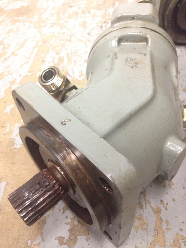

I started doing some work to my bh85 this weekend and had a hard time removing one of the hydraulic drive motors. It was seized, so I have to remove it with the spindle shaft on it. With some heat and a hammer I got it apart and found that the splines were really worn out. Especially on the one that was seized. So I need to replace the spindle shafts with the female spline and the spline output shaft on the Rexroth motors(1-3/8 - 21 tooth)
Those splines have a lot of stress on them and I have put a thick moly grease on them but when ever I check them after about 500 hours they are dry. Has anyone had any luck using another type of lube there?

Castrol Optimoly Paste White T
It won't completely stop the fretting and corrosion but it will sure slow it down.

I was told that DuPont Krytox may be good for splines also. I want to use something that will help the spline to last longer. Im getting prices for new shafts for the Rexroth motors and my first price is 1600. each. That's a lot more than I expected

APS,
I believe on the Rexroth A2FM bent axis motors that the shaft includes the complete rotating group so that would explain the $1600 each. You may want to ask your parts supplier to confirm this.

Hi, I'm the Service Manager for FECON for future tech support or service needs please call 800-528-3113. We use anti-seize to prevent corrosion on the two spline shafts. This should solve your issue,

Thanks Skidplate, what kind of anti-seize do you recommend? They make a lot of different types now. The new Fecon shafts with the female spline look like they have a little copper anti-seize on the splines.

That's it the copper base anti-seize. A light coat on the male and female splines.

You can buy the female spline end as a replacement part, cut the old one off and weld the new one on. Much cheaper than buying a new shaft unless you want a spare. When you replace the shaft on the motor the rotating group and bearings have to be replaced as well so you end up with a fully reconed motor at about half the price of a new one. Its been suggested to me that I drill a hole through the spindle shaft and fit a grease zerk in the bolt hole where the pulley sits and give it a pump of grease every so often. Got to better than pulling motors off especially when you're busy.

Hey Tony, I knew you would chime in. You have been through it all. I thought about reworking the spindle shafts with a new female spline but called and found out they were not that expensive. He also mentioned the new shafts are one piece now and not welded.
I also talked to an engineer from Loctite and they said that the best way to stop spline wear is to bond them together with cylindrical lock, like #680. You just won't be able to pull a motor without the shaft coming with it. I just did it with the one that was seized so it's not too bad of a job. With a little heat the loctite will soften up to remove it. To replace the motor splines with parts and labor is coming in at almost 2000.00 each.

The last shaft I purchased was AU$1100, the billet end was AU$85 plus fitting so for me it's worthwhile as long as the shaft is ok where the bearings run. A good bloke with a lathe and welder can knock the job over in a couple of hours.
