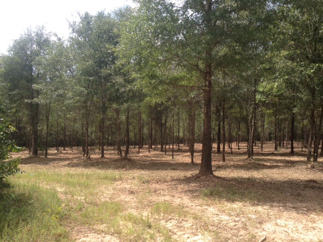

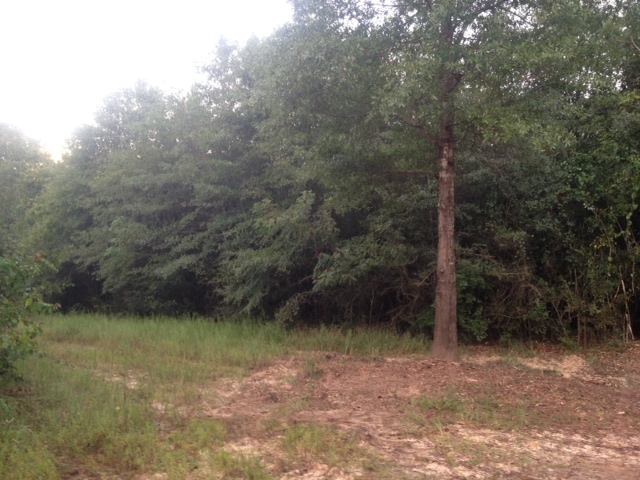

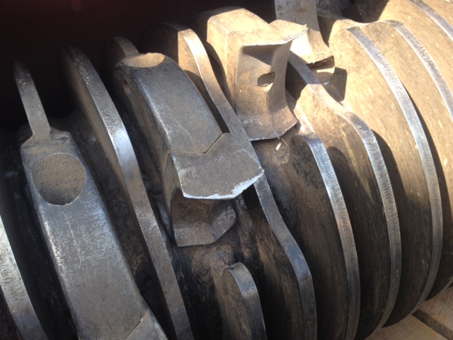

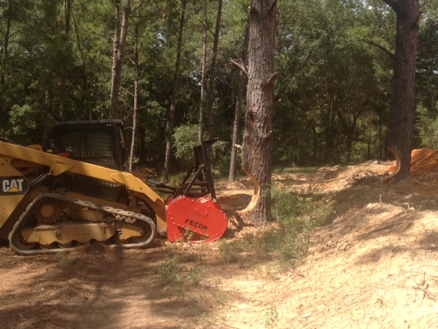

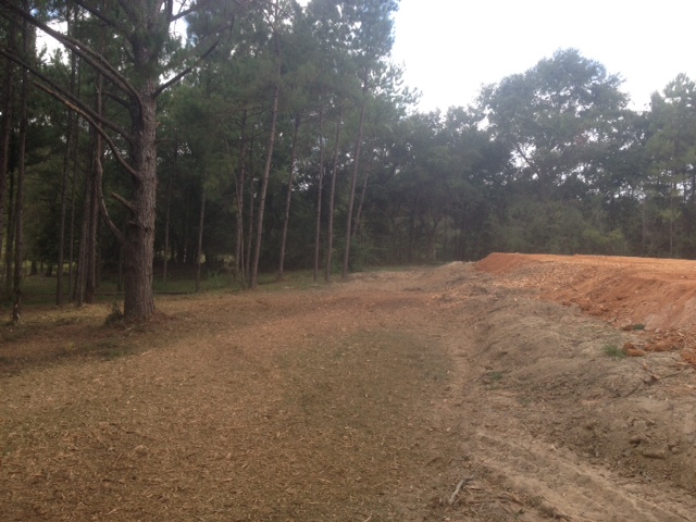

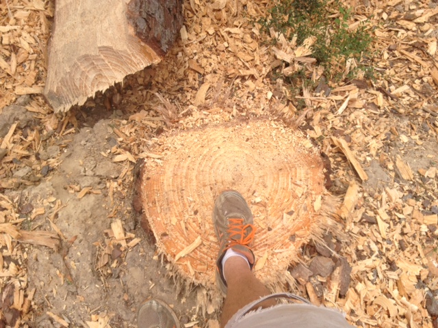

If you know me you know Cimaf is the only cutter I will run until now. Don't get me wrong, I love the Cimaf, but got to give Fecon a pat on the back this DCR is awesome. I have been running a Fecon Dcr for 50hrs now and I'm highly impressed. So Far I haven't found anything she won't cut, on larger trees it seems to cut with ease. I think its mainly do to the larger rotor diameter, doesn't seem to loose moment as fast as other heads I've ran it the past. The 2 pines in the picture were 28" and 31" at the stump the smaller one was processed in 16 minutes and the larger one took 18 minutes. I'm hoping to get 60-80hrs per side on the teeth (120-160hrs on set) so far there is 51Hrs on the teeth now in the picture. I've sharpened them 3 times so far worst time took me 20 minutes which ain't bad if you ever sharpened teeth before. I'm located deep down south an I don't care what you do down here sand is you worst enemy. When it comes to teeth, as fast as these rotors turn you don't even have to get the drum in the dirt. The rotor will lift sand into the drum like a vacuum which cause teeth to wear faster so I'm very happy with the results so far. I would suspect guys further north in heavier soil to see even high wear hours may 80-100 hrs per side. The DCR process even with dull teeth thanks to the counter teeth, so far no complaints extremely happy with it. Give the guys at Fecon a call, tell them the Cimaf lover sent you LOL!

What did you sharpen them with?
How much is a DCR head?
I use a Honda 2000 generator and 7" angle girder with 40 grit flip disc, Give Bob Candee with Fecon a Call he can either sell u one or put you in contact with your nearest dealer (513) 490-0061

Do they have tungsten teeth for these rotors? Where I work has about 80% rock and so over changing teeth on the old style rotor, can't use a rattle gun.
Tonyoz, I won't see y u couldn't it's basically the fgt rotor but it has depth control rings welded to it. Should be able to run the fgt series carbides on it.

impressive and very nice work pics too.
What's the specs on that 299d? Is the Fecon a variable torque head?
