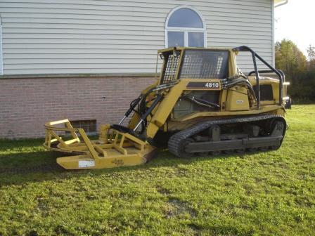

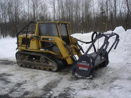

My new 63” Loftness Carbide Cutter arrived today. Coincidentally, I was at Mabie Brothers in Syracuse NY the same time as Mark, whose review started this post. We alternated testing the two cutters. I completely agree with Mark’s summary, I could not find a performance difference between the Loftness and the Fecon. In the end, I purchased the CC because:
  • No sharpening required (I hope)
  • Spiral pattern of cutters on drum.
  • Better mount for cutters, countersunk bolts.
  • Fixed cutters, rather than swinging hammer design.
  • Mounted pressure gauge, no additional cost.
  • No doors and extra hydraulics to deal with.
  • Spring loaded hose holder
  • Claw hooks on tree pusher bar, no additional cost.
  • I prefer different motors than changing pulleys & belts.
The pricing was identical, until the dealer applied a $1000 discount from Loftness. From the dealer’s perspective, Loftness is easier to sell because they provided demo units free of charge and with different motors. Fecon charges the dealer for demo units and different pulley & belt setups.
I ‘m replacing a Davco 705 rotary cutter on an ASV 4810 with the CC. Although the Davco performs well, it leaves a lot of uncut material on the ground. I‘d rather mulch the debris than use a root rake to cleanup later. I’m very happy dealing with Paul Mabie in Syracuse NY. In Buffalo, NY there are other dealers in my backyard, but the knowledge & support is better with Mabie Brothers. Traveling 3 hours to Syracuse was worth the trip.
I did a significant amount of research into brush mulchers. While there might be other cutters, finding a dealer to demo & support near Buffalo NY was a problem. I was not interested in the Timber Ax because I plan on hitting the ground frequently.
Research Notes:
Pictures attached of my ASV 4810 with Davco & CC. The 4810 has 30gpm high flow, which is marginal for any mulcher. Loftness sized the hydraulic motor according. A new RC100 would be nice, but not in my budget.
As a side note, I hate my ASV 4810 track controls. Has anyone ever run across a joystick modification kit to replace the two steering handles for the older ASV’s ?
Thanks for reading, being my first post to this forum. Everyone’s advice has been very helpful over the years. The new CC will sit for a few months, we have 3 feet of snow, with another 2 feet expected tonight.

ASV 4810 with Davco 705 Rotary Cutter
ASV 4810 with Loftness Carbide Cutter
