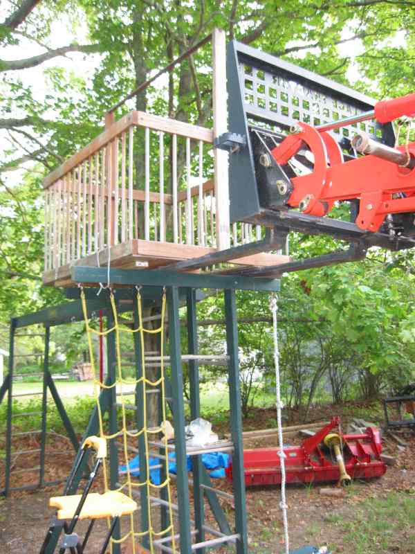

Tree booms are quite useful and are certainly not limited to moving trees. I have used one to lift heavy implements in and out of the back of an SUV to avoid needing a trailer. Unlike with a set of forks, you can angle the tree boom so you can set the load deeper into the vehicle.
Forks are great but don't buy forks that are excessively heavy duty for your size loader. Even the LA1000 size loader is pretty light duty as far as forks are concerned.

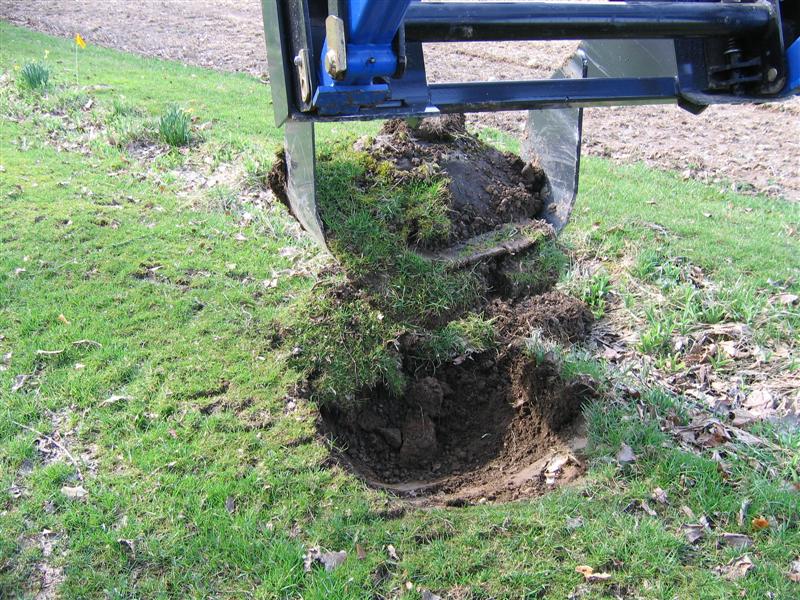

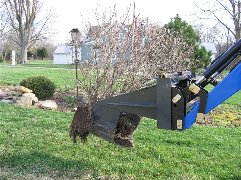

I use forks and found a digging implement that attaches to the adjustable forks to be a very handy tool that saves me from needing to mount the BH frequently and actually can do some things the BH cannot. QuickSpade is the name of the device. (photo below)

Interesting! IslandFord, you always come through with more information. The quick spade is clever, a poor man's backhoe. As I do not have a backhoe, I could probably find a use for this. For instance, we have some roads where water pools and obviously a backhoe to trench it and a dozer to re-grade or make some water bars would help. Since we have neither, coud a small trench be cut with the spade to divert the water and then graded or smoothed with the bucket or box scrape? Many places need just a little trench dug to divert the water, but more than I could do with a shovel. What types of work do you do with the quick spade? It also doesn't appear to be a costly tool.

I like that Quick Spade!
If you already have a set of stout and adjustable forks, it is pretty much a no brainer. I recall it cost about $125 or something of that order. It is essentially just a shovel on steroids which means it is quite a different tool than FEL or BH. It is for example great for digging out a plant/shrub etc and then moving it to a prepared hole (also with the quick spade). It is lots faster to mount than a BH but also has the advantage that you are digging from in front of the plant not trying to come over the top and dig from behind. It digs more than 4ft down so is quite adequate for digging or cleaning a ditch/trench etc.

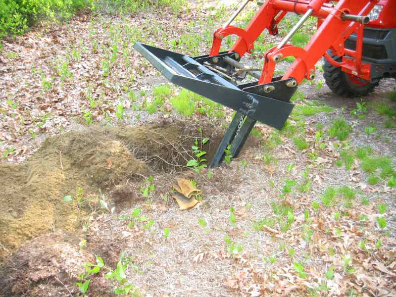

Had to jump in on this one. One of my most useful QA tools is a thing called a U-blade. This thing is great. :D I also have forks, and this works along the lines of the quick spade only larger. It is amazing the rocks I can dig out of my fields and then carry off with this thing. I have used it to dig rocks, ditches for culverts and plants of all kinds. Both for the planting hole, and to move large shrubs for replanting. Have to say that it is much more useful than the bucket for these tasks as it does not dig as big or wide hole. Tips can get under deep rock and pry it right out. Poor mans back hoe. :p
