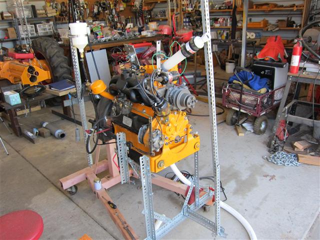

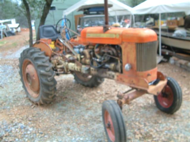

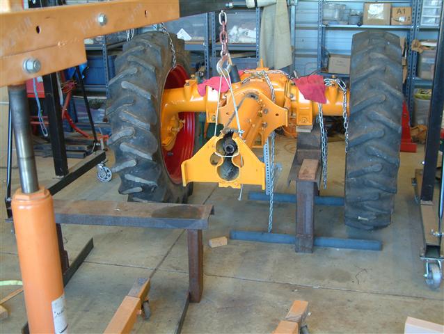

$1500 for a tractor paint job? Maybe, but unlikely. However, it's very possible to sink a lot of $$$ into a vintage tractor. I'm doing a complete restoration now on a 1951 Minneapolis Moline BF tractor (about the same size as a Ford 8N or 9N). Paid $1100 for the tractor off craigslist, non-running (no compression), invested $1600 for engine rebuild ($800 parts, $800 labor). Figure I'll have at least $4500 invested before I'm done in another year or so. The engine now is on a run stand being checked out (if I ever get some time for this), all parts are painted and ready for reassembly. Got the rear end assembled so far.
DSCF0018 (Small).JPGDSCF0088 (Small).JPGDSCF0091 (Small).JPGIMG_0401 (Small).JPG
You probably don't want to get this involved in tractor restoration. My advice: get a running 8N or 9N, service it (points, plugs, fluids, etc). New gauges, maybe. Repaint it--paint should cost $50-75 with spray gun/air compressor; a little more with spray cans (a rattle can restoration).
