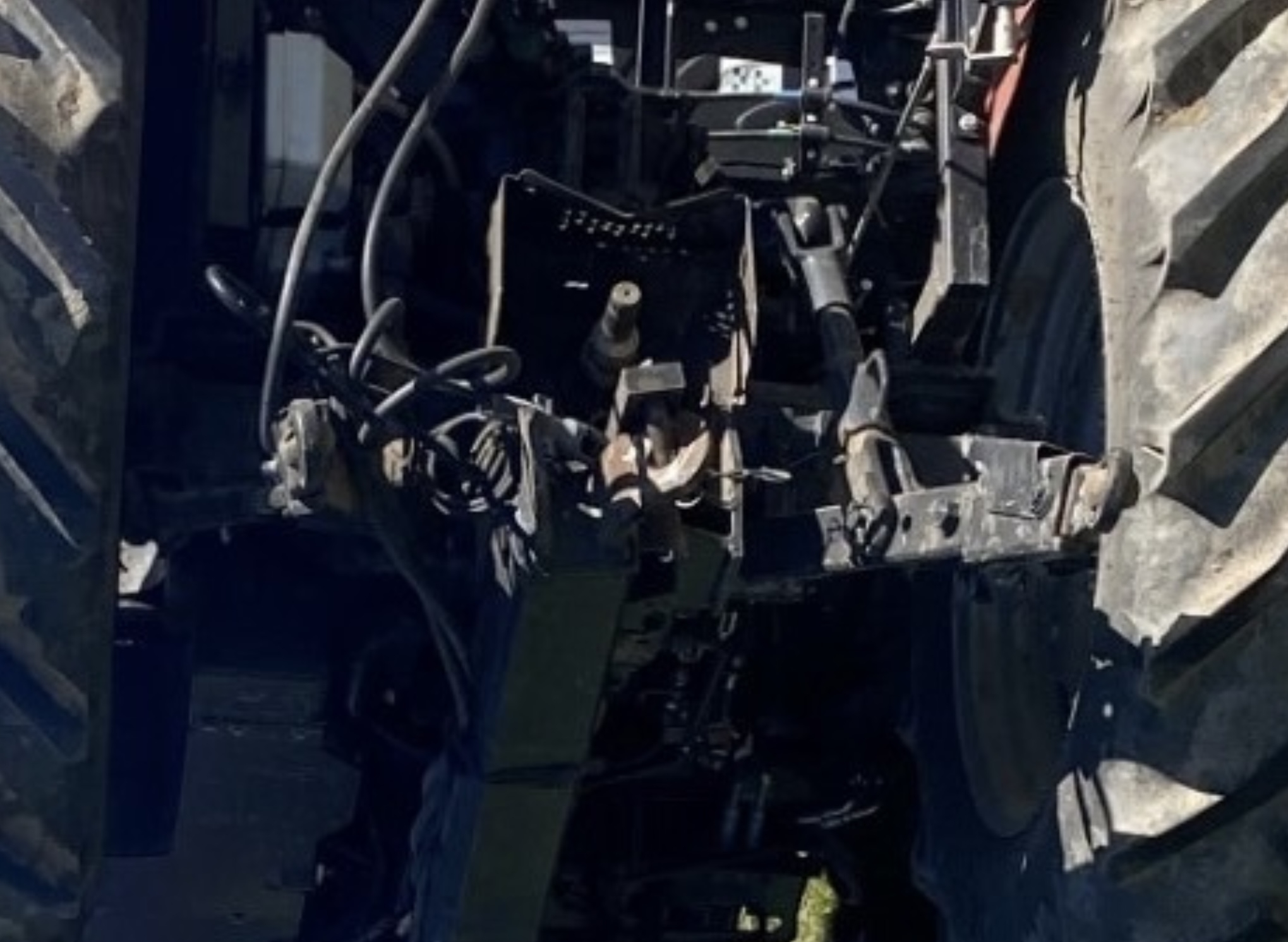

All the larger tractors will run at least 18 mph, many will limit out at 25 mph with front suspensions some will get up to 35 mph.
Per the article the equipment got to fish tailing and he lost control.
"CASS COUNTY, Mich. — A 23-year-old died in a tractor crash on Saturday afternoon, according to the Cass County Sheriff's Office.
Sheriff Richard J. Behnke said deputies responded to a farm tractor crash on Garrett Road, north of Middle Crossing Road in Silver Creek Township around 12:05 p.m.
Deputies said an investigation of the crash showed that a tractor pulling a farm implement lost control and jackknifed, causing the driver, 23-year-old Nathan Scherer, to be ejected from the cab.
The tractor then rolled onto Scherer, and he was pronounced dead at the scene, deputies said. "

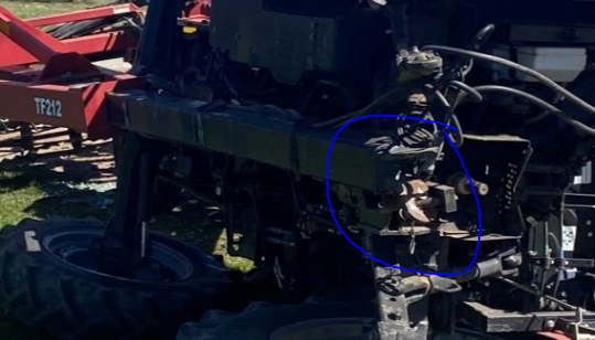

Soil conditioners are pretty well balanced. The tractor probably does not exceed 25 mph. Most of the smaller ones which it looks like it is still maxes at 18-20 mph wide open. 2 possibilities I see. 1. Not his fault entirely. Accident due to inexperience. On coming traffic and he moved over some and it dropped off the edge and the tail started wagging the dog and he was unable to correct properly. Instinctively over correcting and getting back on the road instead of staying off road and easing back on.
2. On his cell phone and lost control. Entirely his fault. My cousin had an employee drop his on the floor of tractor and ran off the road while towing a sprayer and tangled with a tree.
Without knowing model of tractor it is hard to say if he lacked the correct size of tractor for implement.
Specs for implement. I would suspect support wheels for wider wing width but may also be an option. They have extremely long tongues and once they start weaving it will take a lot of experience to bring it back under
control.

Seems odd the tractor looks to be turned around laying backwards. Going to fast and the implements Blades don't look to be in the position to be mowing. No uncut pass so he may not have been mowing. Hauling !!! down the Rd.? We've all pretty much BTDT. My BA. F-250 They Chipped the motor. True. How do I know. 3500rpms. 4th lockup. 373 they kill the Ing.. Frist trip to Fla. Int.75 late night. My father retired from ford and one of his dealers offered it to him. They window sticker states not to be used as a Emergency Veh... :rolleyes:

mowing? Before offering any opinion you better know what an implement is and what is going on. I even provided a link above that you could have looked at to educate yourself.

My guess the mower was lifted and he ran off the Rd. The weight offset the Front end and the kid lost control. JMO The blades are lifted so he wasn't using the mower at the time and the grass reflects that. Educate Your opinion that was mine. Didn't read yours.
