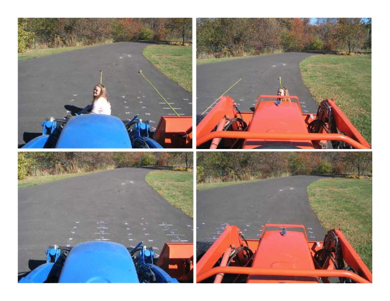

Well short or tall, fat or skinny, if working a lever requires you to reach under your leg, then that is a simply clear cut fact, and that would be bad ergonomics.
Again, fat, tall, short, skinny, if the the loader control blocks the ingress/egress to/from the right of the tractor, that too is fact, and that would be bad ergonomics.
Front end loaders have been discussed by MossRoad and how his view of his front bucket. Most people who have tractors swear their loader is great. But I have to tell you, if you use one with a better view of the material is it almost like a religious experience. I've got many hours of use on many brands of fork lifts and other types of equipment lifting loads and have used many brands of tractors to lift loads. I have to tell you, tractors are horrible for FEL work. They are slow, offer low visibility, and are not very manuverable. All 3 of those things are facts. So anything that can be done to improve those things will improve the ergonomics, and that is not grey area. In commerical applications, where money is measured in time & productivity, you see machines that are far better at lifting than the tractors we use. My best forklift is articulated just like MossRoad's Power Trac. It fits down narrow aisles and maneuvers far better than my rigid forklifts. My rigid forklifts are far superior to any tractor. Again that is all fact. So when it comes to tractor FELs there are a lot of design issues we can look at and compare and while it might be opinion that one brand is better than another, it is fact that more visibility = faster use, safer use, more efficient use . . . and I think it is opinion that those facts are "better" but it is also hard to dispute.
Now there are other NON-ergonomic issues that also can be used to differentiate between tractors, some of those would include things like having exposes hoses that project up over the top of the hood that a branch can snag. Or a bucket without a toplip that is reinforced with a tube or box steel that runs from side to side. Or a few dozen other issues that we can discuss.
I've posted the attached photo before. It shows 2 of my tractors in my driveway. Both loaders have similar specs. Which do you think is safer, easier, faster to use?
