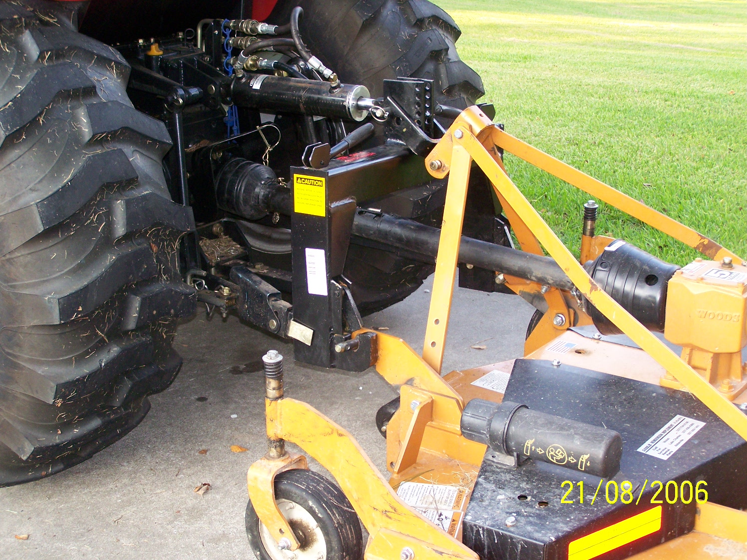

Off topic a bit, but can anyone tell me how the top link works with the plain hook that appears to be the upper attachment point on these hitches? On the website pix it looks like there's a bracket to receive the rear pin on the top link, that's fine. But if you have an implement where the relationship among the three points can change, I guess you need the U-bracket they talk about but don't include, right? In other words, if your upper implement attaching point isn't rigid, you need the U-bracket. Like, I run my brush hog with a chain for the top link, so I'd not be able to use this hitch?
Now I'm more confused than when I started.

I hope I understand your concern right. If you wanted to use your chain, you would need some manner to fasten the chain to the quick hitch, maybe by using the U bracket you are referring to. It is designed to be used with implements that have a flexible top link such as a brush cutter.
I couldn't find a picture of one being used with a chain, but here's a pic of the U bracket being used with a flexible top link on an RFM. Hope this helps.
Bottom line I guess is that a quick hitch is best utilized when hitching to an implement with a rigid top link pin such as a Box Blade, Rear Blade, Tote Box, Weight Box, etc.

Thanks for the picture.
I need to make an I-Match work with that same mower, and needed some help to visualize how a floting top link would work with the QH.
Woods makes a kit, but it's rather pricey. Land Pride makes an adapter similar to the Farm Pro, utilizing two plates. I don't see the Farm Pro "U" adapter listed anywhere though.
Jon

I believe you can purchase just the "U" adapter from Speeco or a Speeco Dealer. The part number is HF141145. Let us know how much it is.

had a welder make one up for me. charged like $15. works perfect. 2 pieces of 1/2"x1 1/4" stock. bent and welded together with a couple of holes.

Called Speeco this morning, and they refered me to a dealer - (TSC in my area).
Apparently they don't sell direct to end users. I'll check them out and see what they want to order one in for me.
I prefer this design to the Land Pride, as it is a one piece design instead of two plates whick would mount outboard of the QH top link. I feel that it should provide for greater utility in a wider range of applications.

OK guys, I finally got down to the TSC store and ordered the floating link. It was a little under $25, which included a $5 UPS fee. Should have it in about a week.
Looks like the grass will require one last cut this season to check it out. That is unless it's snowing by then....
Jon
