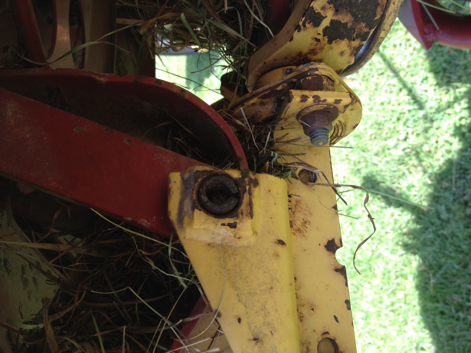

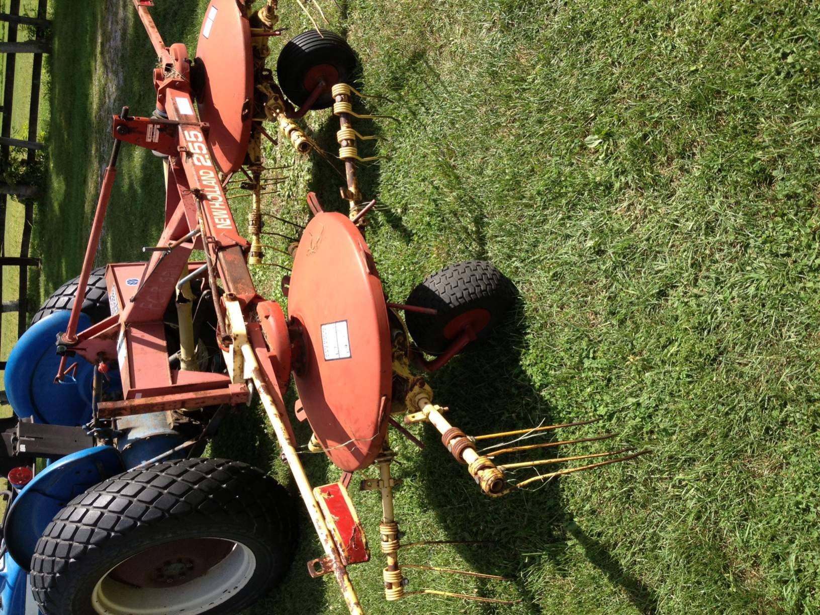

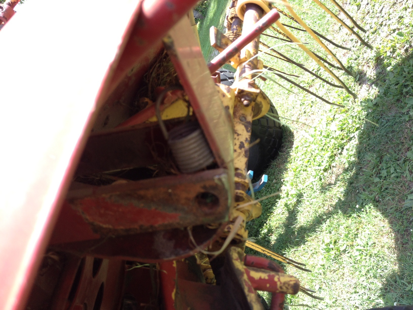

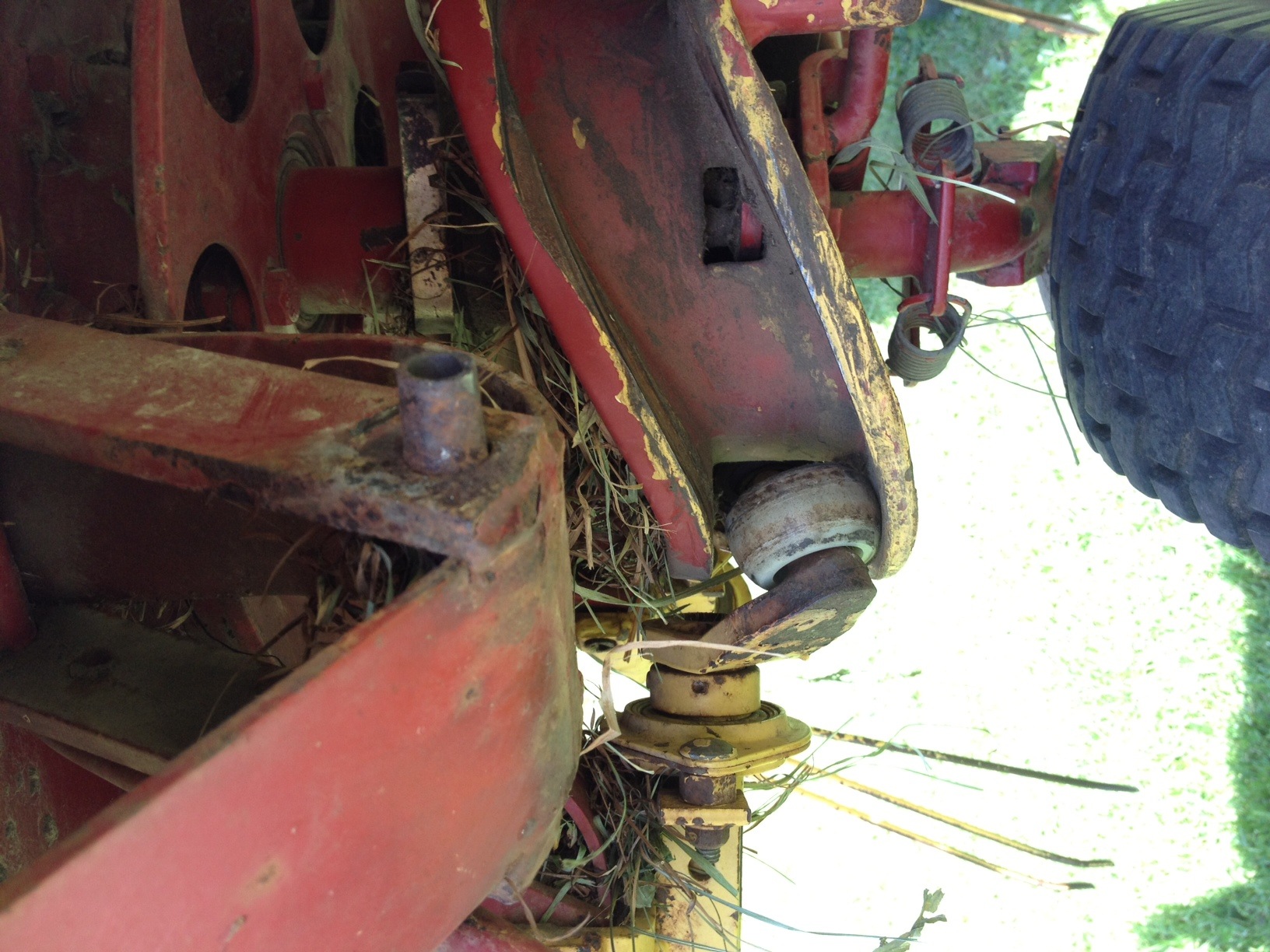

I am new to farming my 8 acre hay field which I use to supply forage for our horse farm. I recently purchased a New Holland 255 Rake/Tedder on consignment from my local CNH dealer. During the initial shakedown run, operating at about 350 RPM on the PTO one of the twelve arms which holds the tines flew off. Inspection revealed the "Split Tension Pin" (as I have subsequently learned they are called) holding the arm to the rotary wheel frame had apparently migrated to one side allowing the arm to detach. I have attempted to remove the pin using hand tools (Ball Peen hammer, penetrating oil, large channel locks in an attempt to pinch the pin and rotate it out) have been fruitless. I need to remove the pin in order to inspect it for damage and, if need be, replace it. I have enclosed some pictures of the problem, which my Mac wants to rotate horizontally instead of allowing me to change their orientation so feel free to rotate your monitor to view correctly.
The tedder/rake missing one of the left-sided arms:
A normal-appearing split tension pin for comparison (the tine arm is yellow, the rotary frame is red):
Bad pin which has rotated out on the right side of the arm which flew off:
and in on the left side of the arm which came off:
Questions:
How do you remove split tension pins?
Rusted pins are a guarantee. How do all of you deal with the added problem of these pins being frozen in place due to corrosion?
Is the process of reinserting a pin just the opposite of removing one?

Applying some heat to the outer member holding the pin will usually help break it loose. A Bernzomatic torch with Mapp gas applying the heat will also swell the outer member making it easier to get the split bushing/pin out. Wouldn't want to get the bushing/pin too hot though as it might lose it's temper but might be a good idea to replace it with a new anyway.

Thanks for all of the advice and the suggestions. THe roll pin punch sounds ideal, but the configuration of the implement, with 6 tine arms radiating from a central rotating head, makes it difficult to get around the arms on either side while using a 6-8 inch long roll pin punch as there is no space left to bring a heavy mallet of hammer to bear. It is an exercise in frustration.
I spoke with the CNH dealer and looked the part up online. They would be happy to order one for me. It is a 16 x 140 millimeter roll pin and they will sell it to me for $24.77! I nearly spit my coffee out all over myself. I asked him again, "Did you say twenty-four dollars and seventy-five cents?" He replied in the affirmative...before tax.
My next phone call was to a local Fastenal store. "We don't have metric roll pins in stock, but we can order one for you. I'll look it up and call you back on the price." He hasn't yet.
So...I may try taping a 16 mm socket to the exposed end of the existing roll pin and heating the rotating head which it is inserted into and then pounding on it. I'll let you know how I progress. I'll also look for a suitable roll pin online.

Update:
The problem is solved. Closer inspection revealed that the roll pin actually broke on the one end holding the tine arm to the rotating hub and when it did, the torque of the 15 lb tine arm actually bent the remaining portion of the roll pin in such a way that it was bent upwards over the top of the hole in the rotating housing that was meant to be pounded through. The end which remained sticking out of the other side (see pictures from initial post) was so rusted in place that the was no way to twist or pull it out. After 2 hours of various attempts to pry the torn end down to align with the exit hole which were fruitless, my neighbor (80 year-old farmer, been-there, done-that) suggested we try to cut the pin in place and haul it out in pieces. Neither of us had an oxy-acetylene torch, but I do have a Dremel and one 1-1/2" cutting disc on it with no spare...to be used against hardened steel.
The good news is that that Dremel disk cut through that steel roll pin like butter and once cut in half, it was easy to remove the rest of it.
30 minutes later we were finished and now I am back in business.
The lesson learned: Keep thinking. There are many alternative ways to fix a problem and always, always trust an old farmer. :)
