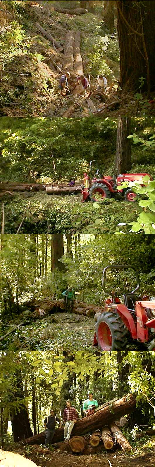

We spent last weekend pulling redwoods out of my buddy Mark's creek bed with my Farmi 351P and Kubota L2500. The top picture shows the mess we faced. Those logs are about 35 to 40 feet long, and the one on the left was about 26 inches diameter half way back. The far ends are the butts.
We cut the larger log (on the left) originally about 12 feet back and had a heck of a time pulling it up out of the creek. We re-rigged with a double line and pulled the next 12 feet out easily enough, then a ten footer. The log on the right we cut in half and pulled out in two pieces. There were a couple of smaller logs underneath.
Second and third pictures show the landing and tractor for size comparison. That's Mark hauling out a 100 foot coil of 5/8 inch cable. Bottom picture is "The Crew." Mark's on the right, his neighbor Eric is on the left (Eric used to log these hills, and we're grateful for his patient help teaching a couple of weekend loggers.) I'm in the center.

   / Farmi or Fransgard winch??? #23
Great photos and very impressive work with a Farmi and Kubota. That's one heck of a chain saw too. Looks like a 36" bar?
   / Farmi or Fransgard winch??? #24
<font color=blue>Great photos and very impressive work with a Farmi and Kubota.</font color=blue>
Thanks. This was the first big project with the Farmi.
<font color=blue>That's one heck of a chain saw too. Looks like a 36" bar?</font color=blue>
That's about the size of it /w3tcompact/icons/wink.gif
