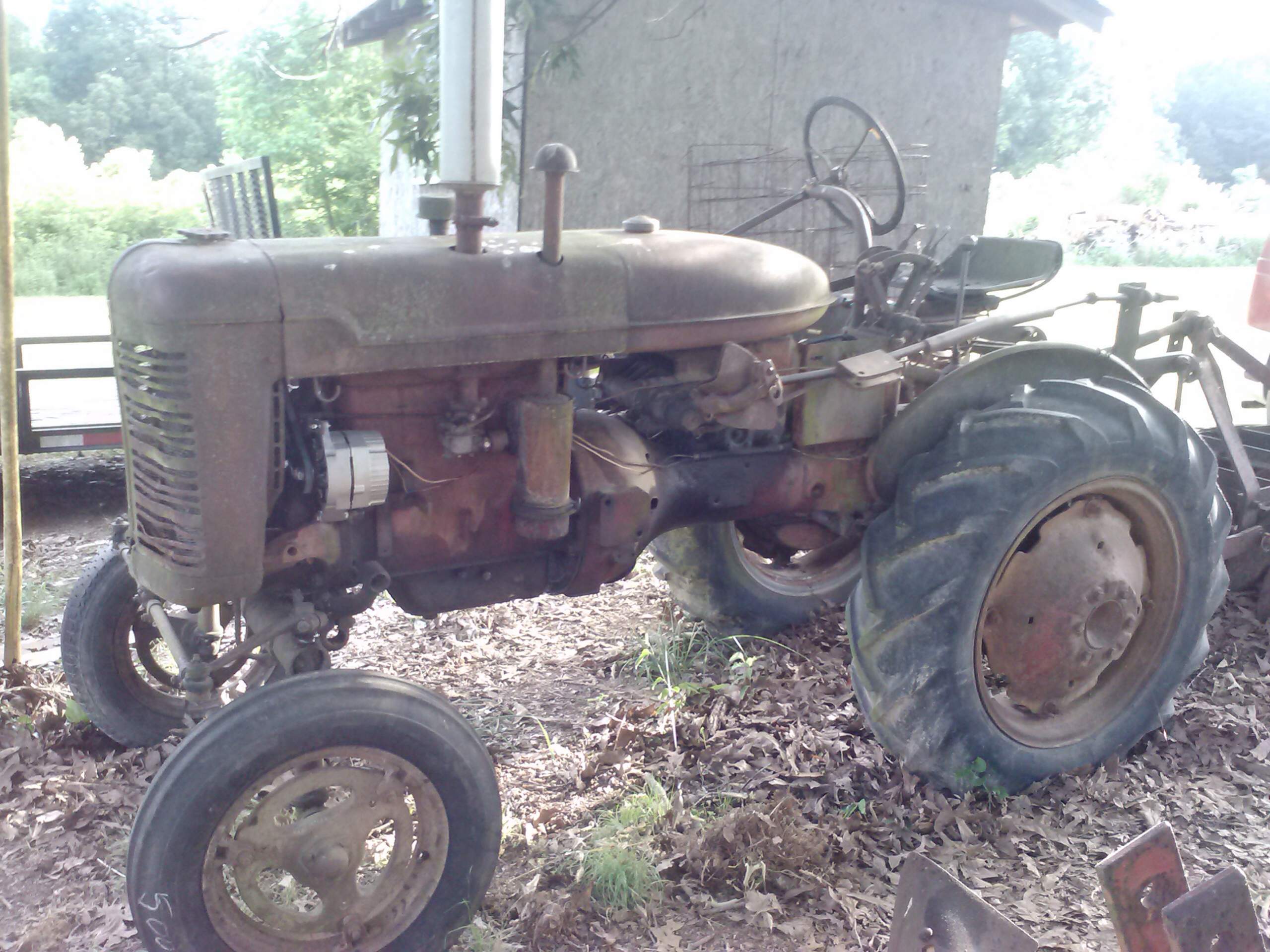

I am removing the jumper cables used to start the tractor battery connected to another vehicle. When I remove the jumper cables (the bat on tractor is too weak to start it) the tractor dies. image.jpg
Here is a photo of my tractor. It is a 1954 Model that originally came with the 1 point hitch, converted to 3 point.
