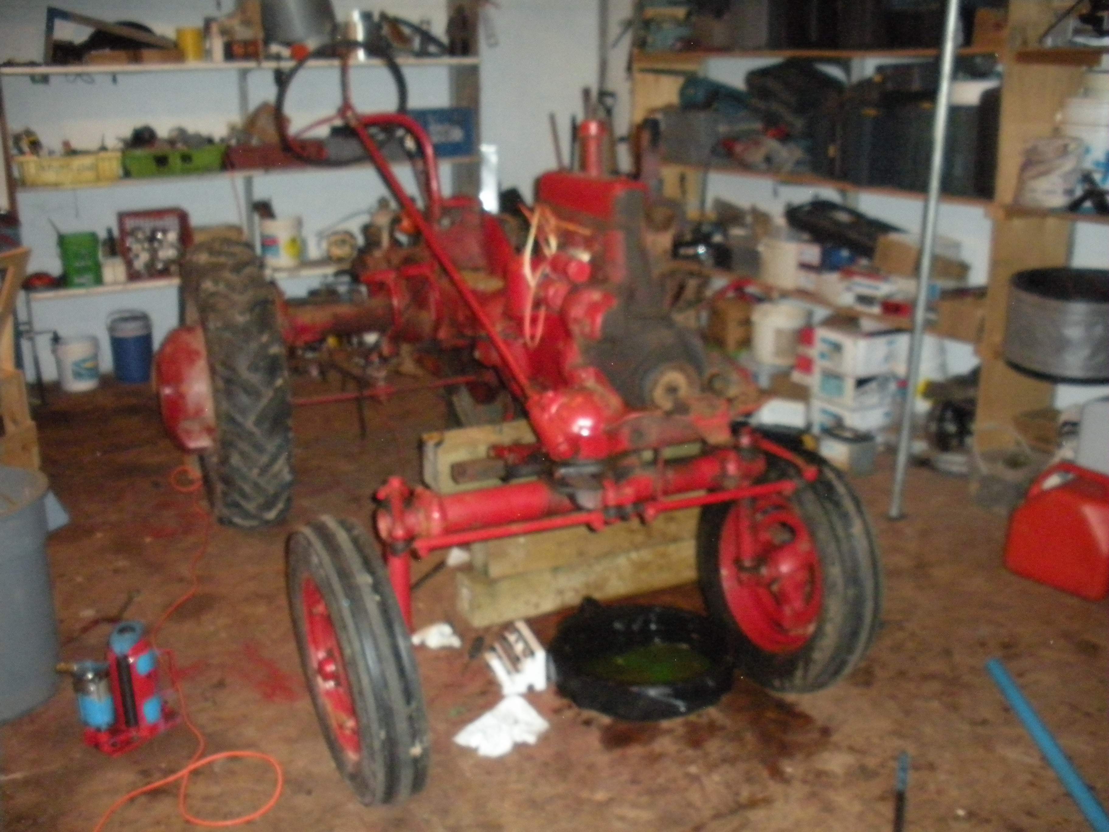

i just rebuilt the left hand side axle housing because i thought that was the noise, i had the shifting linkage plate off and flushed the whole thing out with diesel and put new 80-w90 in the rear end.

well there was a little piece of steel about half inch long 1/8 wide that came out of the transmission. and is the input bearing the one that is right up where you adjust the clutch? and no it does not make the noise when the clutch is out tractor.jpg

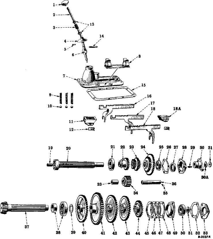

Click on image below to enlarge it. #25 is the input shaft bearing in the trans. This would be located inside the transmision on the main input shaft. If you could get a clear, up close picture of the piece, may help determine just what it is.

The IH part number is ST246 for that input shaft bearing. Crossed it through NAPA, and the universal part number is 6206NRJ.

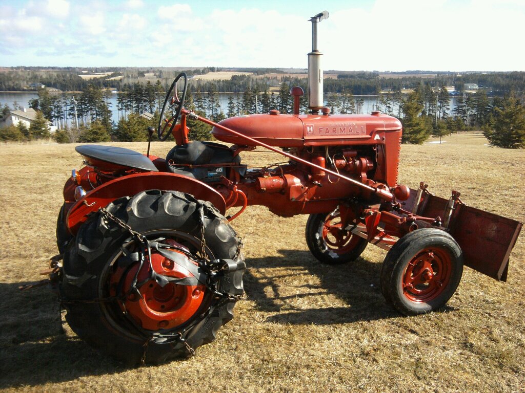

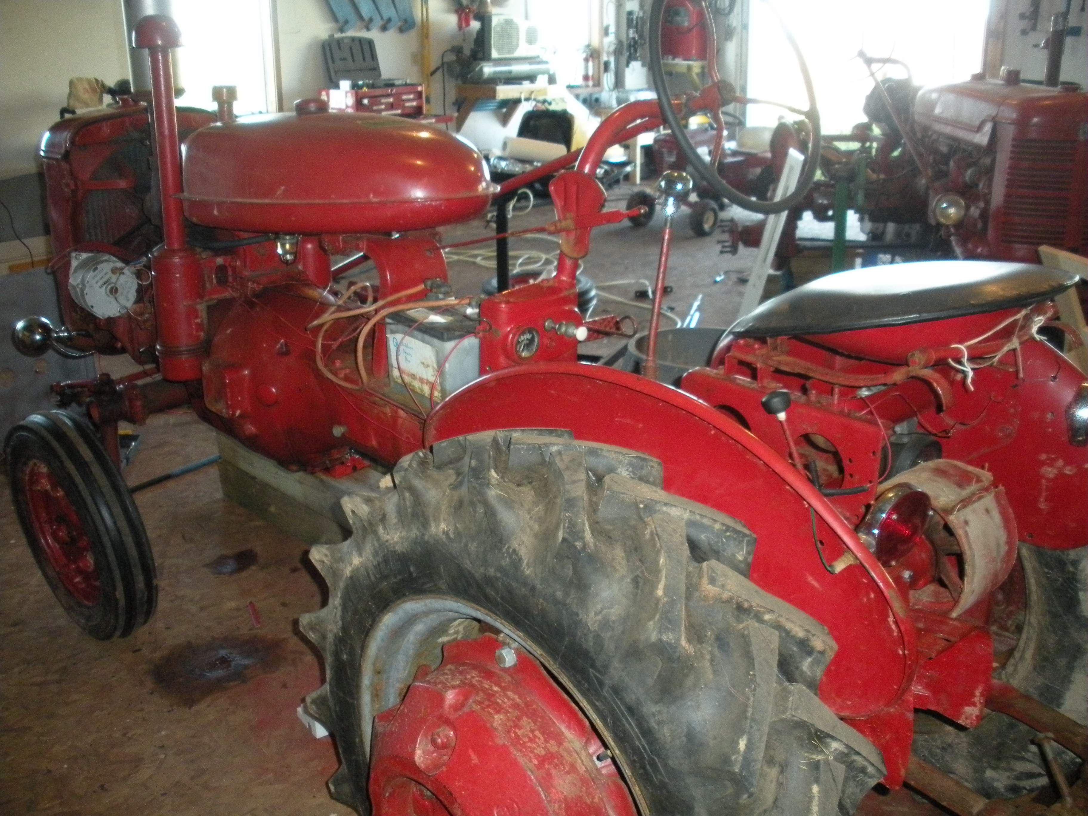

There is something I noticed after seeing the picture of your tractor, but keep forgeting to ask. You are saying it is a Super A. All I have ever seen had hydraulics, this one does not... Just curious...
Unless my eyes are deceiving me, the steering wheel looks a lot bigger than on my two A's I have. Looks more like one from and H or M. Nothing wrong with that, should help with the turning..!!
And don't see the lift mechanism for the front blade. Nice looking blade by the way... How do you raise it..?? I rigged up a Char-Lynn PTO driven aux. hyd. pump on mine, for the front blade. Works great..!!
And the engine on mine... A C-123 power unit from an IH 55-T baler. Just OH'd by an IH dealer a year before I bought the baler at auction. Probably the best running tractor I have, although not the prettiest, and a super sweet governor..!!

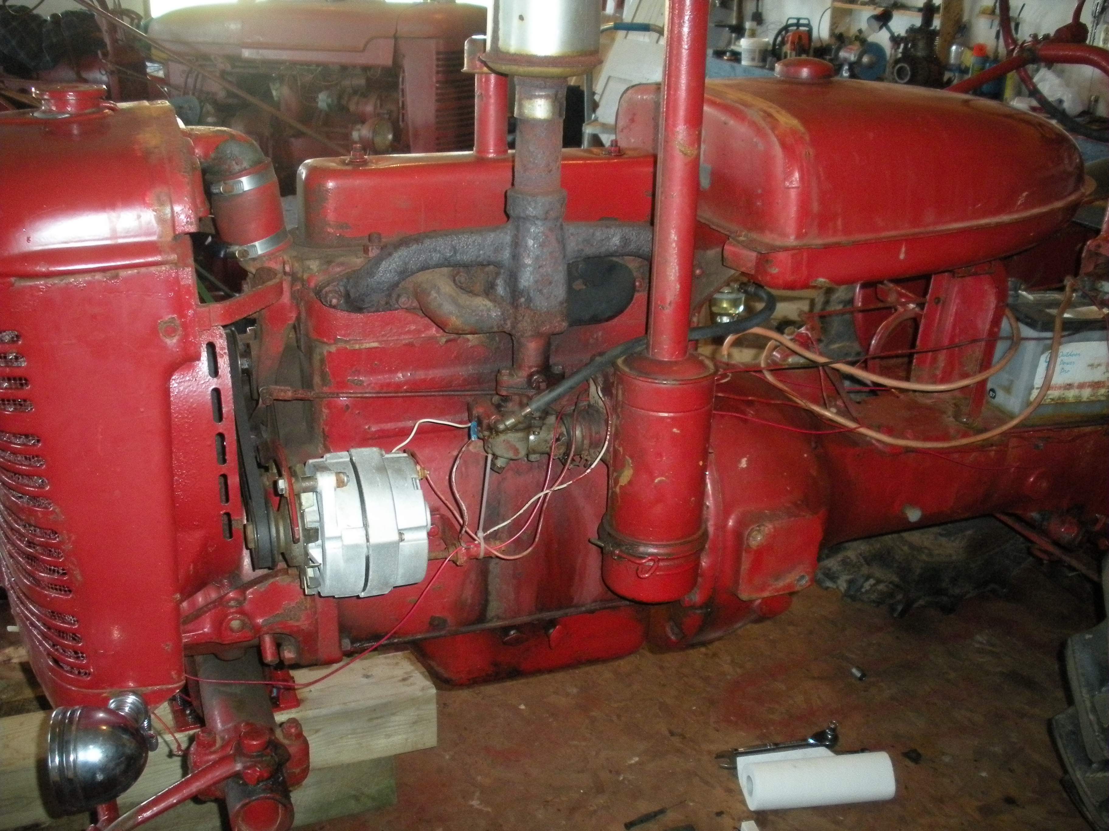

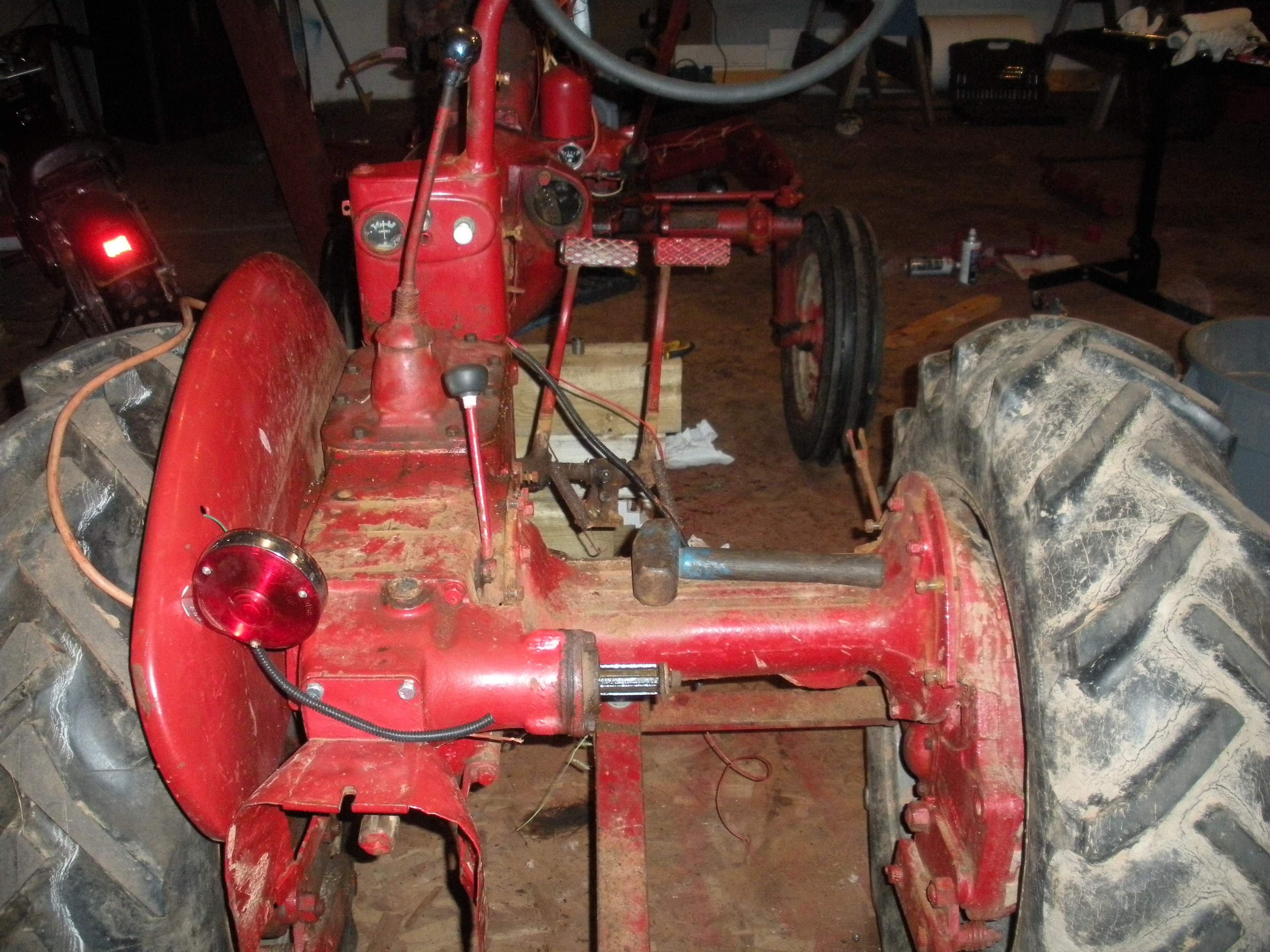

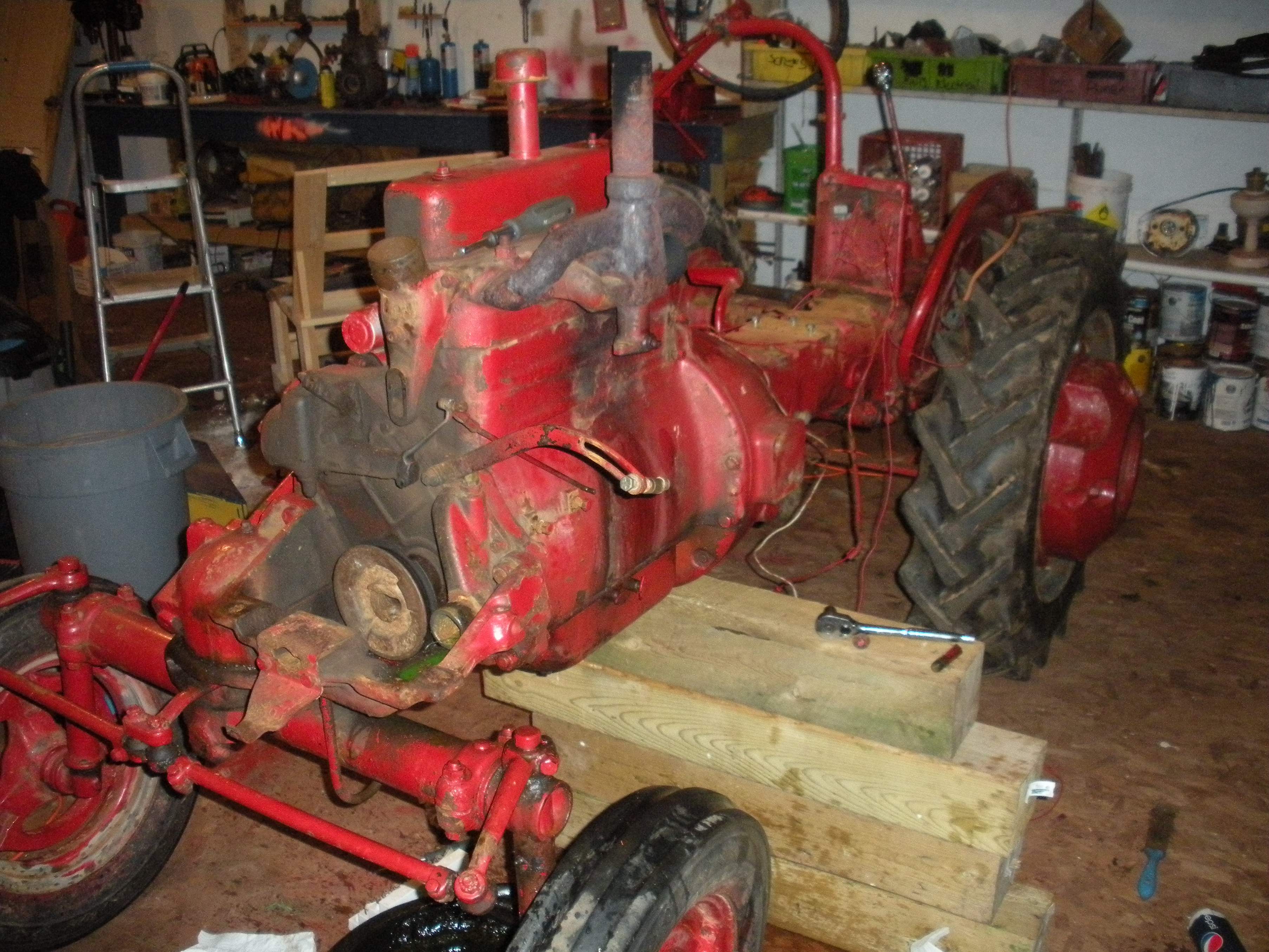

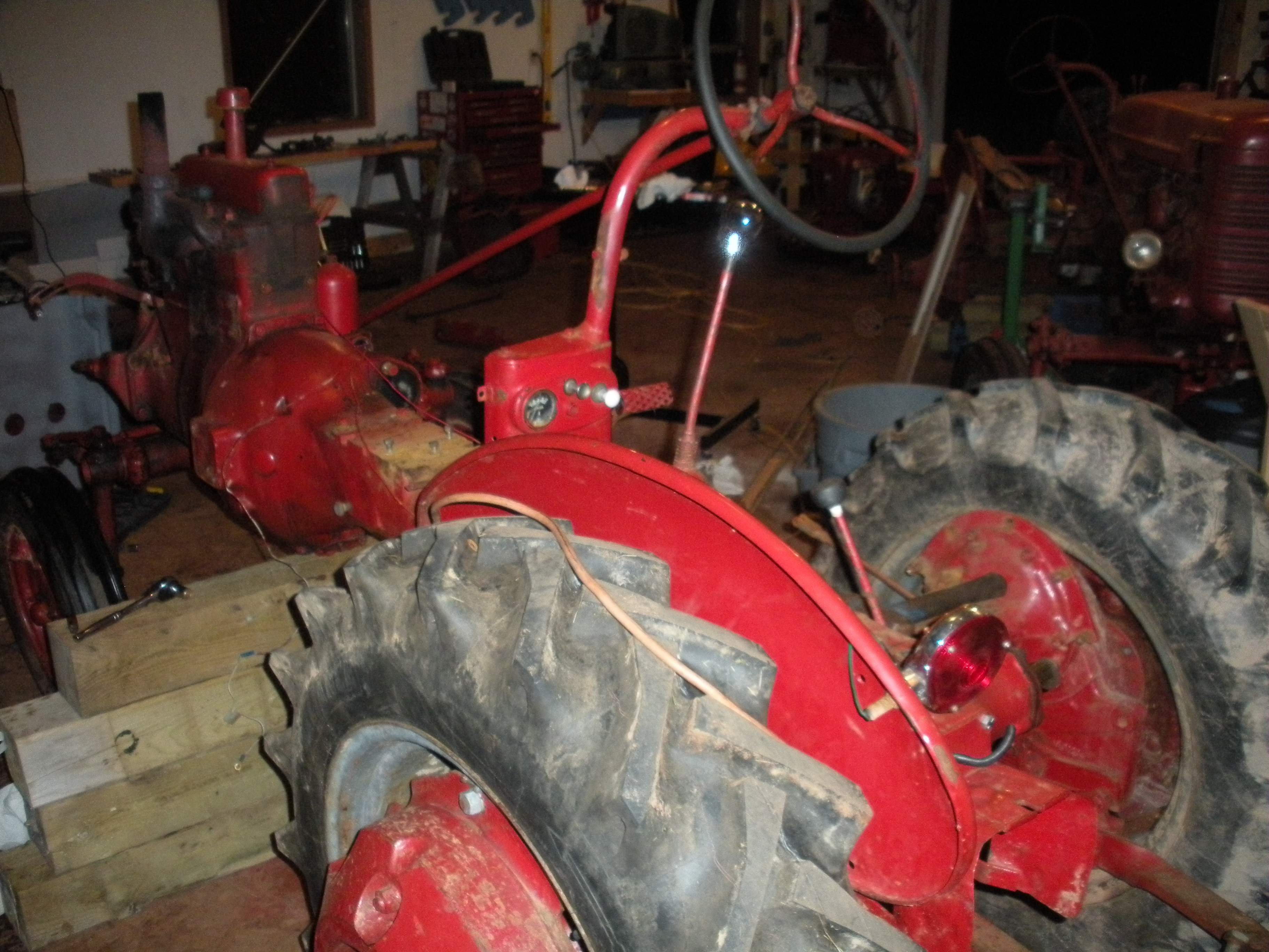

well, it was a super A and someone stole the hydraulics off of it prior to when i bought! there is some ways i can tell its a super a number 1 the serial number..and number two it has the thick fenders with the holes for where the hitch would bolt on. so today i ordered the bearing for the input shaft bearing (i hope that bearing is just the one that is right in the front of the transmission) and i ordered a clutch release bearing. i also went online and bought a transmission plate gasket and a decal set! heres some pictures of what i did today and it when it was together i did all the work you see done in 3 hours haha! DSCN0942.jpgDSCN0943.jpgDSCN0944.jpgDSCN0945.jpgDSCN0946.jpgDSCN0948.jpgDSCN0949.jpgDSCN0950.jpgDSCN0951.jpg

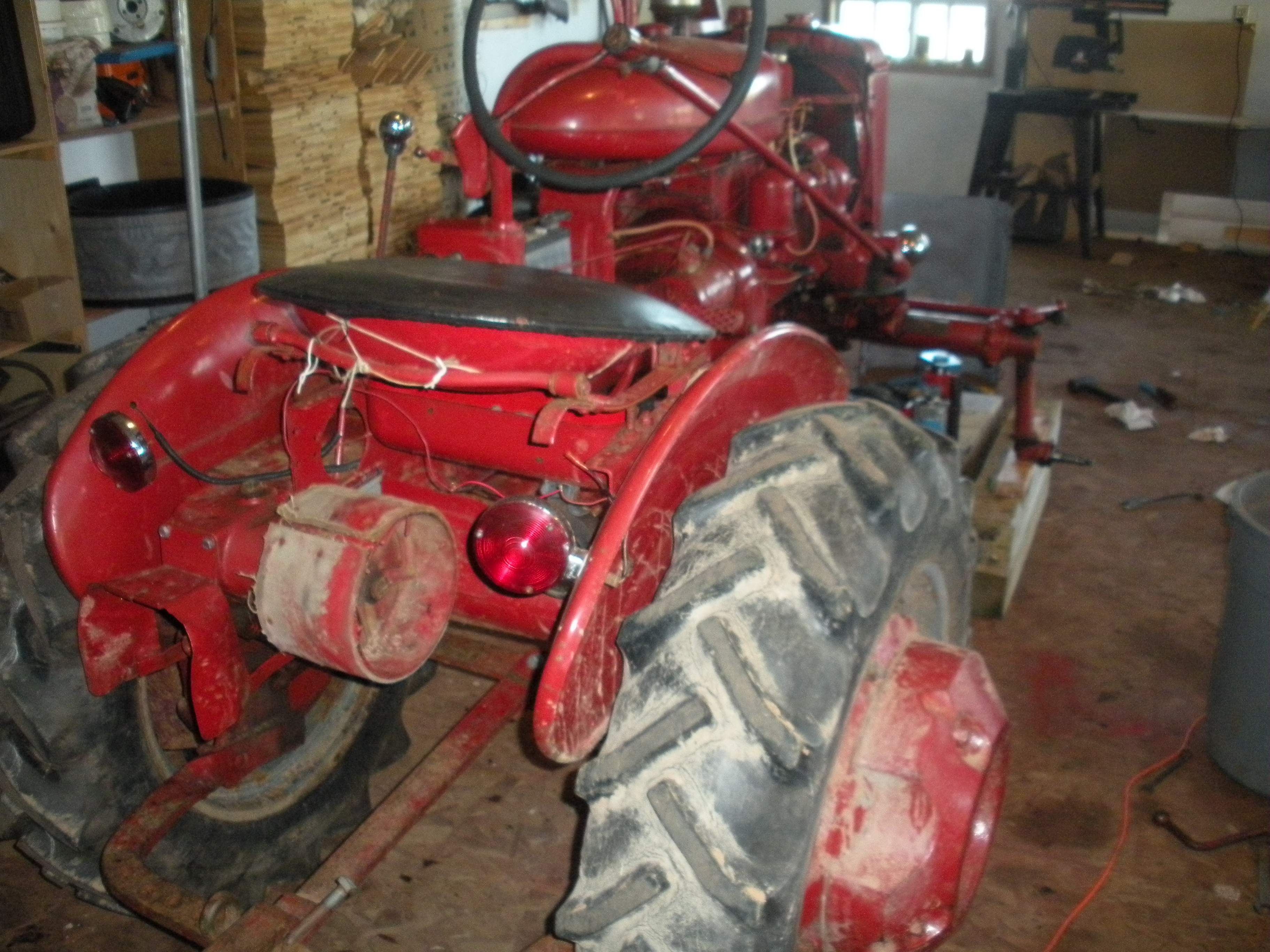

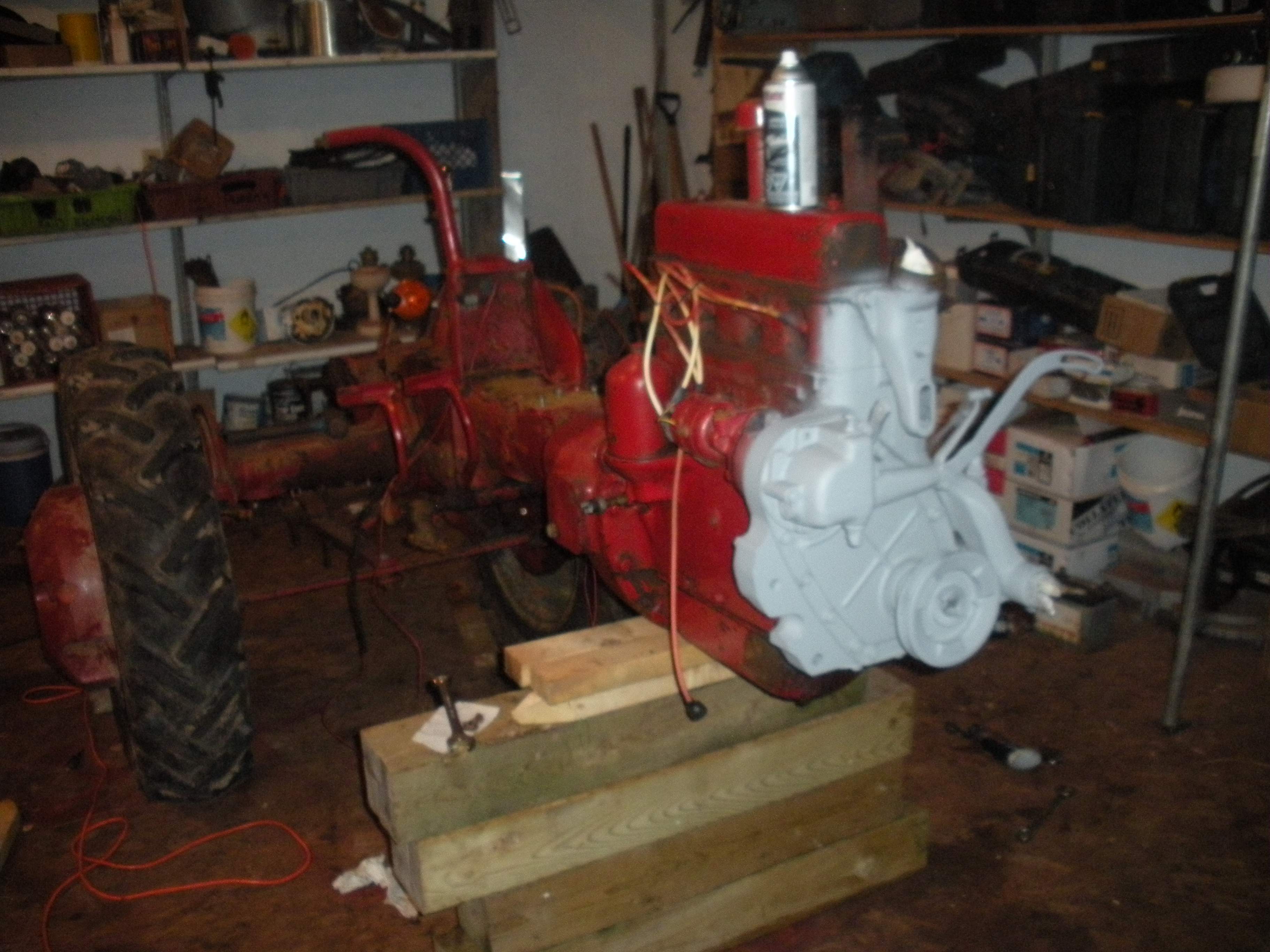

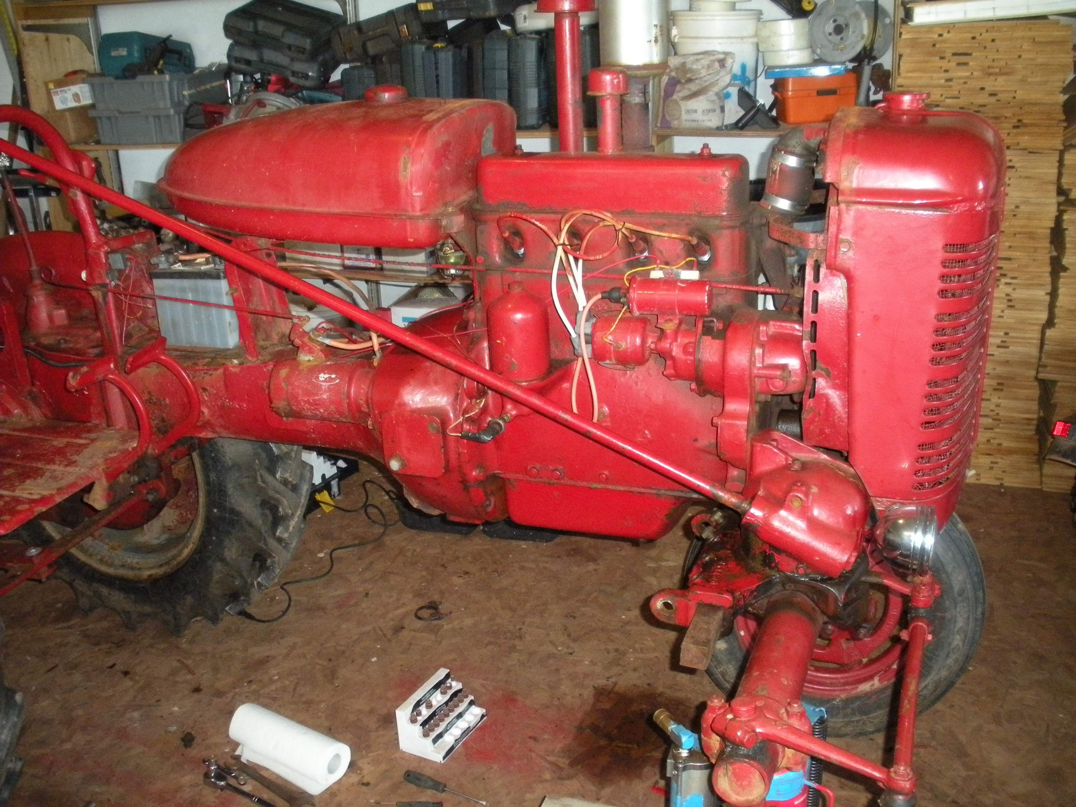

took the front end off today and primed the front of the motor and sandblasting the front end tomorrow hopefully, i think it will look good when im done DSCN0954.jpgDSCN0953.jpg
