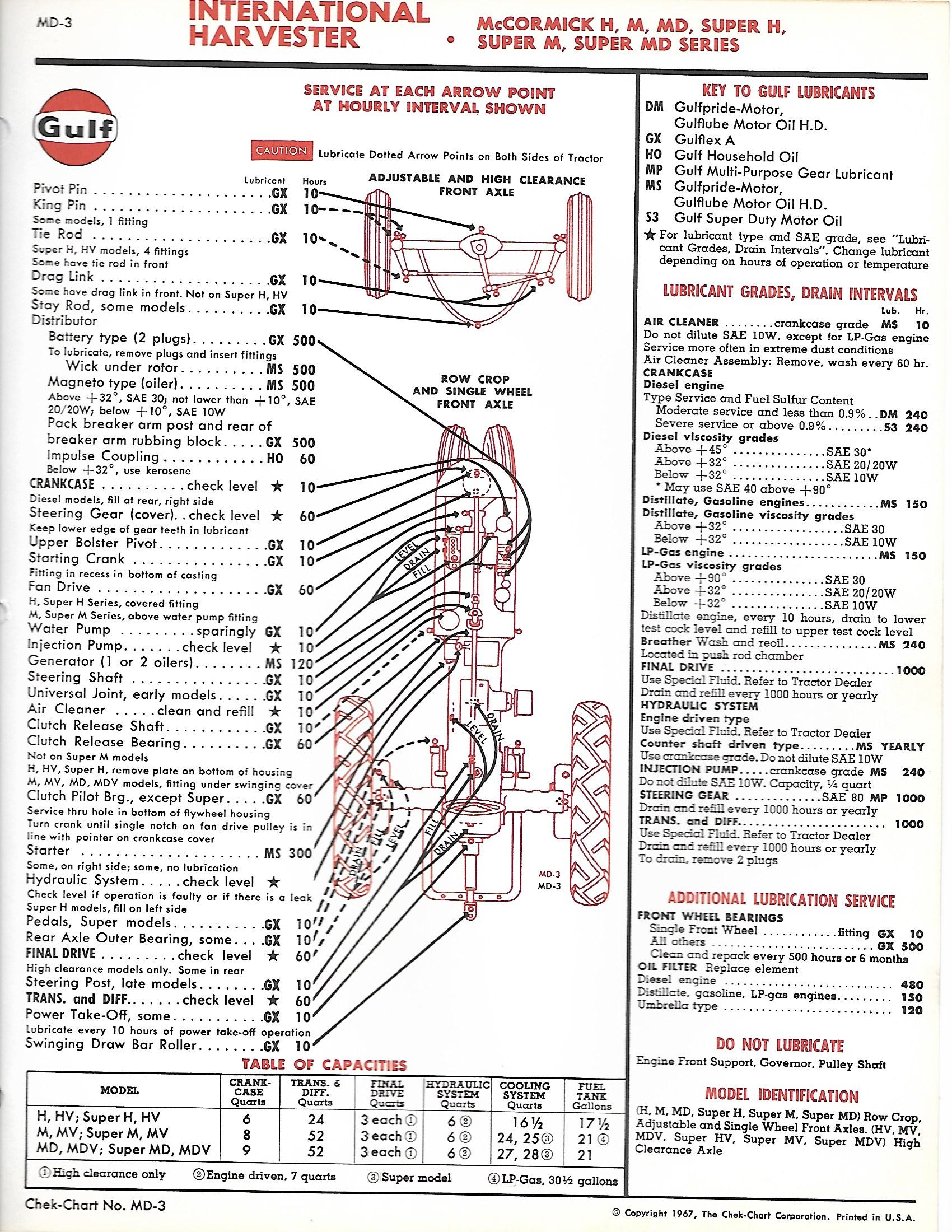

I recently purchased a Farmall H, and I was wondering if someone could fill me in on all the parts I need to add lubricant to/change. All I know of now is engine, coolant and transmission/gearcase. Thanks.

This should help. You can print it off, and it will print out a full sized page. Click on the picture, and it will enlarge if you're on a PC. Click again to enlarge it even more.
