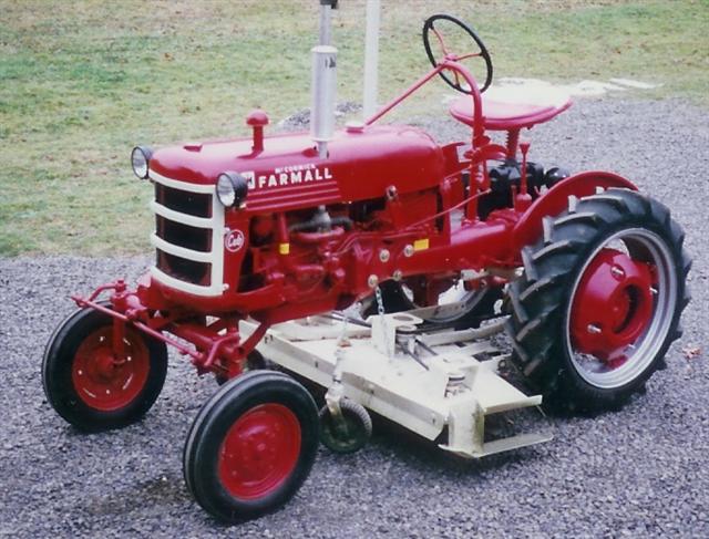

Great advice. I had the exact same thing happen to my farmall cub several years ago. Once I freed up the shifter I was careful to push it all the way in gear from then on.
