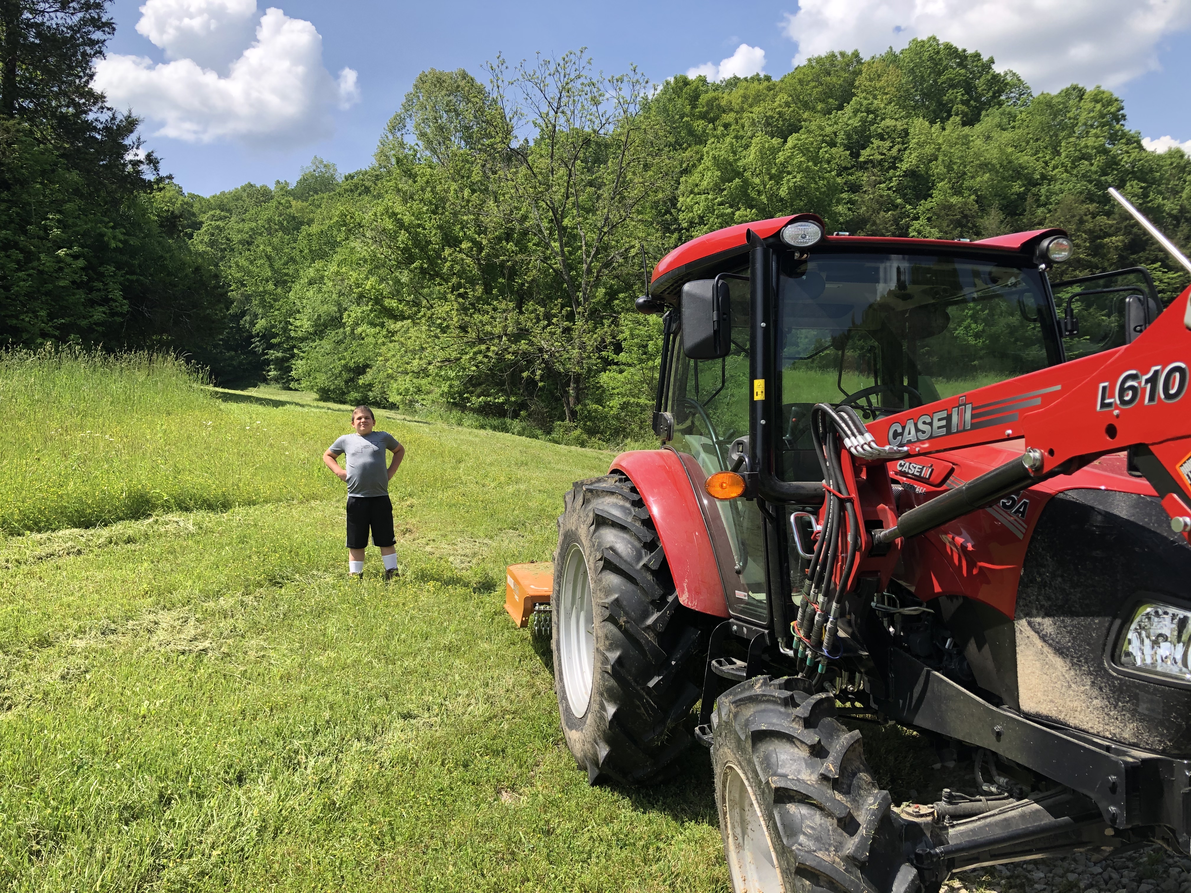

Finally got to do some mowing yesterday. Here are my thoughts on the 75A after about 3 hours of cutting- The cab is quiet. Even with the motor running at 2,000 rpm and the cutter turning, the a/c blower is the loudest thing you hear. And it's a good thing it's efficient. The cab has so much glass, it's a hot box without the A/C. Hope it never gives trouble.
The power shuttle is awesome. Most of my tractor use in the past has been traditional transmissions, along with some HST in compacts, but this is my favorite, at least for this use. Very smooth and perfectly placed controls. I used mid range 1 and 2 most of the time. I could have mowed with a faster ground speed, but this was the first time I've mowed this place, so I wanted to take it slow. Plus the grass (mostly fescue) was about 3' tall.
I mentioned the glass and said before the visibility is good- I'm still impressed, but the one place that's a little hard seeing is the outside edge of the front right tire. Due to the hydraulic connections for the loader, there's a narrow gap you have the look through to watch your track. Not bad, but when everything else is so openly visible, it's noticeably restrictive.
The buddy seat let my little buddy ride around a little too. His favorite thing on the tractor is the radio.
Nice tractor and a Fine lookin boy!!! A future football player for sure! :footballhelmet:
