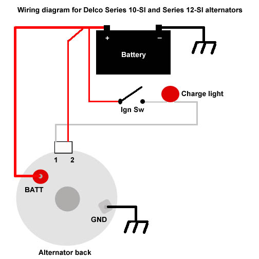

I spent a whole day and went through my wiring and fixed a lot of bad ground connections, including the battery ground! Lights not working, poor charging etc. I put the 3 wire 12si alternator in. You need to eliminate the external regulator because the 12si has it internal. I went through 2 of those smaller alternators so that made my decision. If your wiring is a mess, that would be the first thing I would clean up! Take the time, it's worth it.

I am bad at wiring.I wouldn't even know where to start. Anyone here have a link to step by step on switching over to the 12si alternator?

New and rebuilt units come with schematics. You will also have to purchase a field/sense pigtail for about $5.00. If you are really bad at wiring then you should probably have some extra help.
Another thing to check first; See if your voltage regulator has a little red LED on it, if it lights when you turn on the key switch you likely have a wiring (ground) issue, not a charging system issue. In the schematic I posted, you do not need the charge indicator light because you will have a voltmeter. Depending on which amp rating alternator you get, the heavy red wire should be at least 8 gauge. The small red wire (sense) should be 14 gauge. The small grey wire is the field circuit, it can be 16 gauge.
