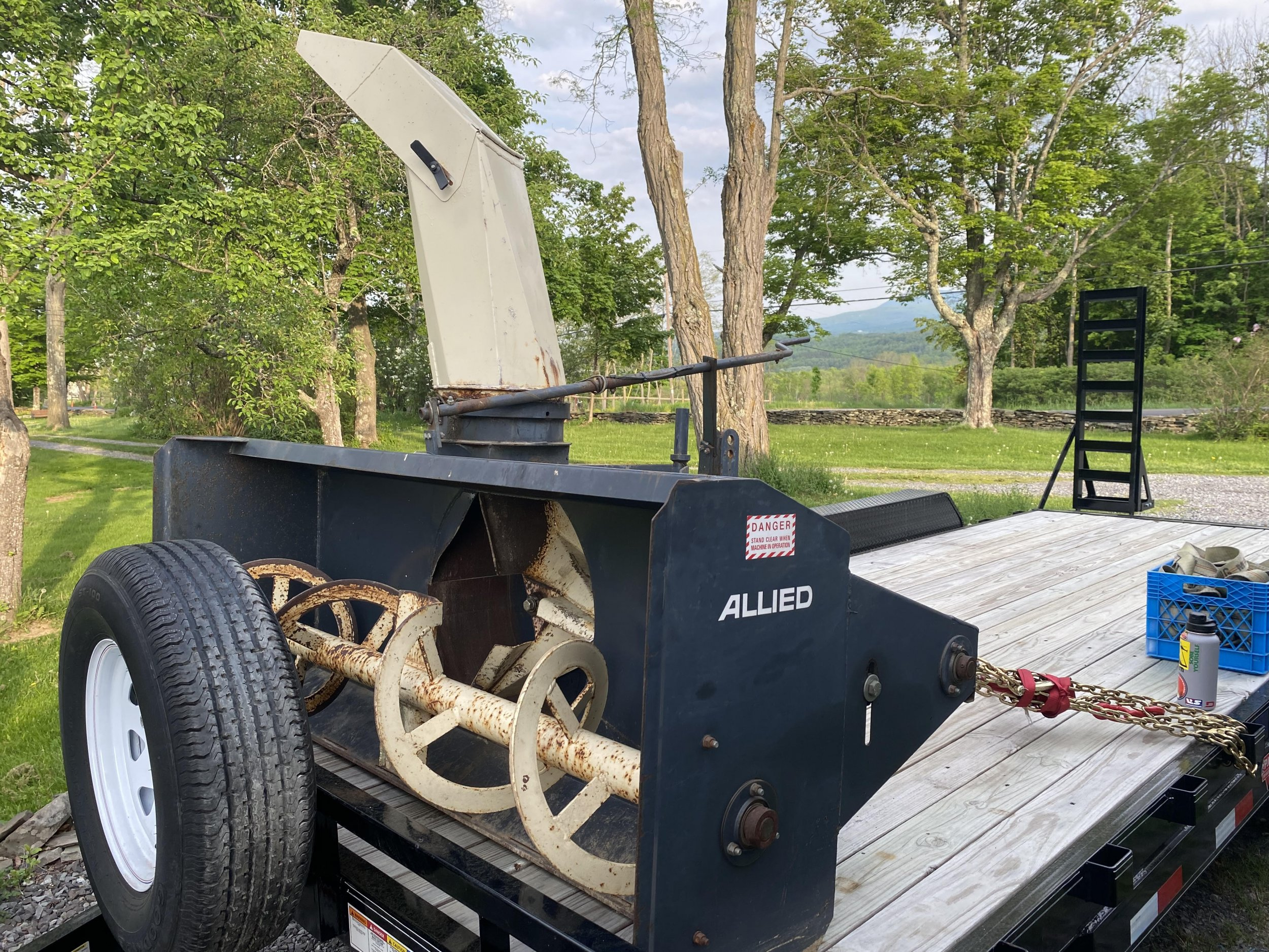

Hi, I just picked up the Allied 73" snow blower pictured below. Looks alot like yours. I know this is an old thread but if you are willing... I would love to have the electronic copy of the manual e-mailed.
