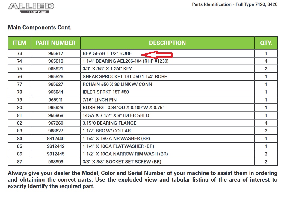

   / Farm King bevel gears #7
Open bevel gears have been used for decades. McKee Bros made many sizes of blowers. They made 48" ones painted orange and sold by Kubota utilizing open gears.
Do you not have a Farm King manual with the bevel gear part number?
Any dealer selling Farm King could order parts especially if you have the part number.
These open gear blowers are still being made today and converting to an oil bath gear box is not practical.
The design of the fan support is completely different
I know people who have had these blowers for 40 to 50 years and the gears never wore out.
