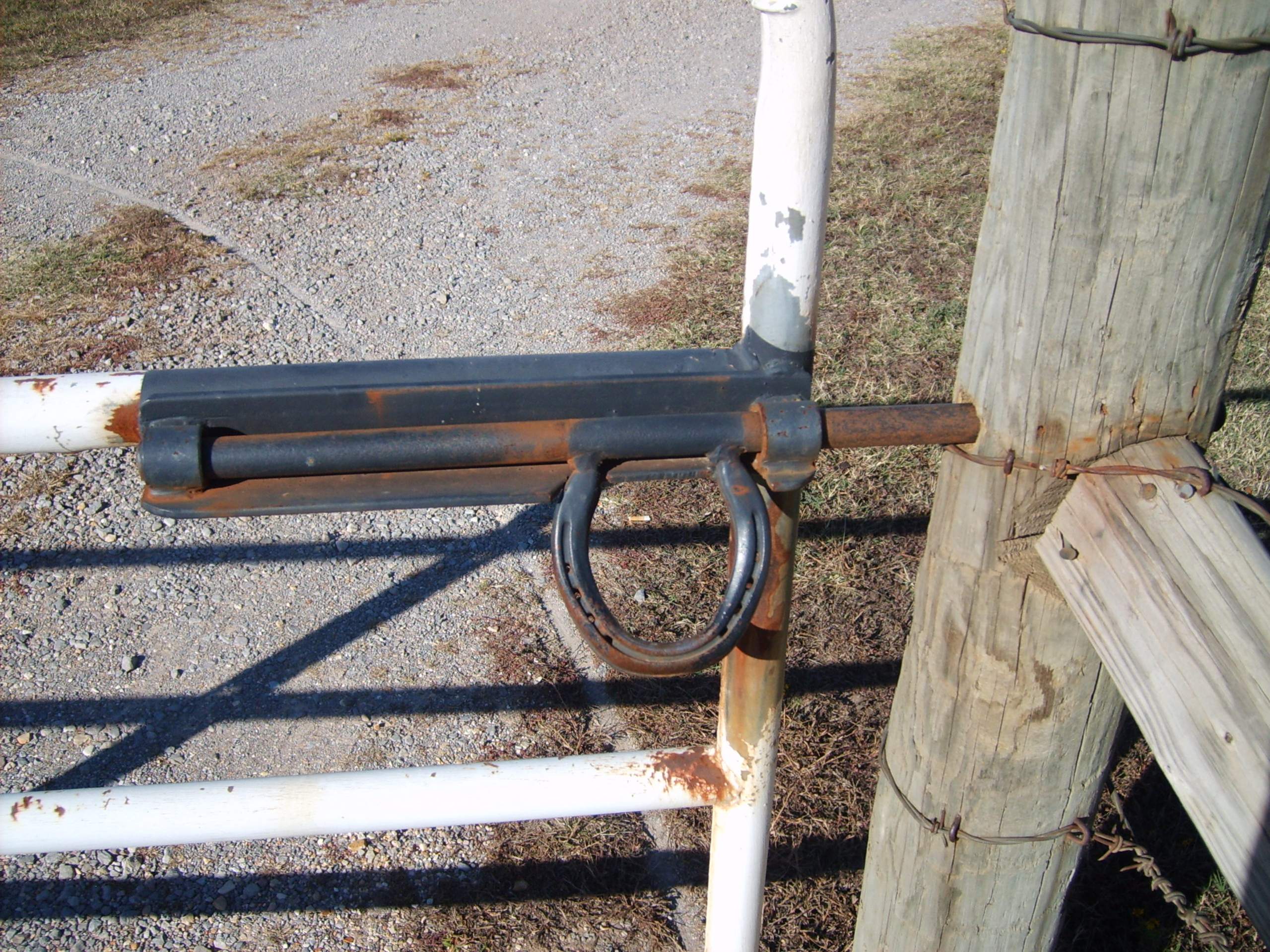

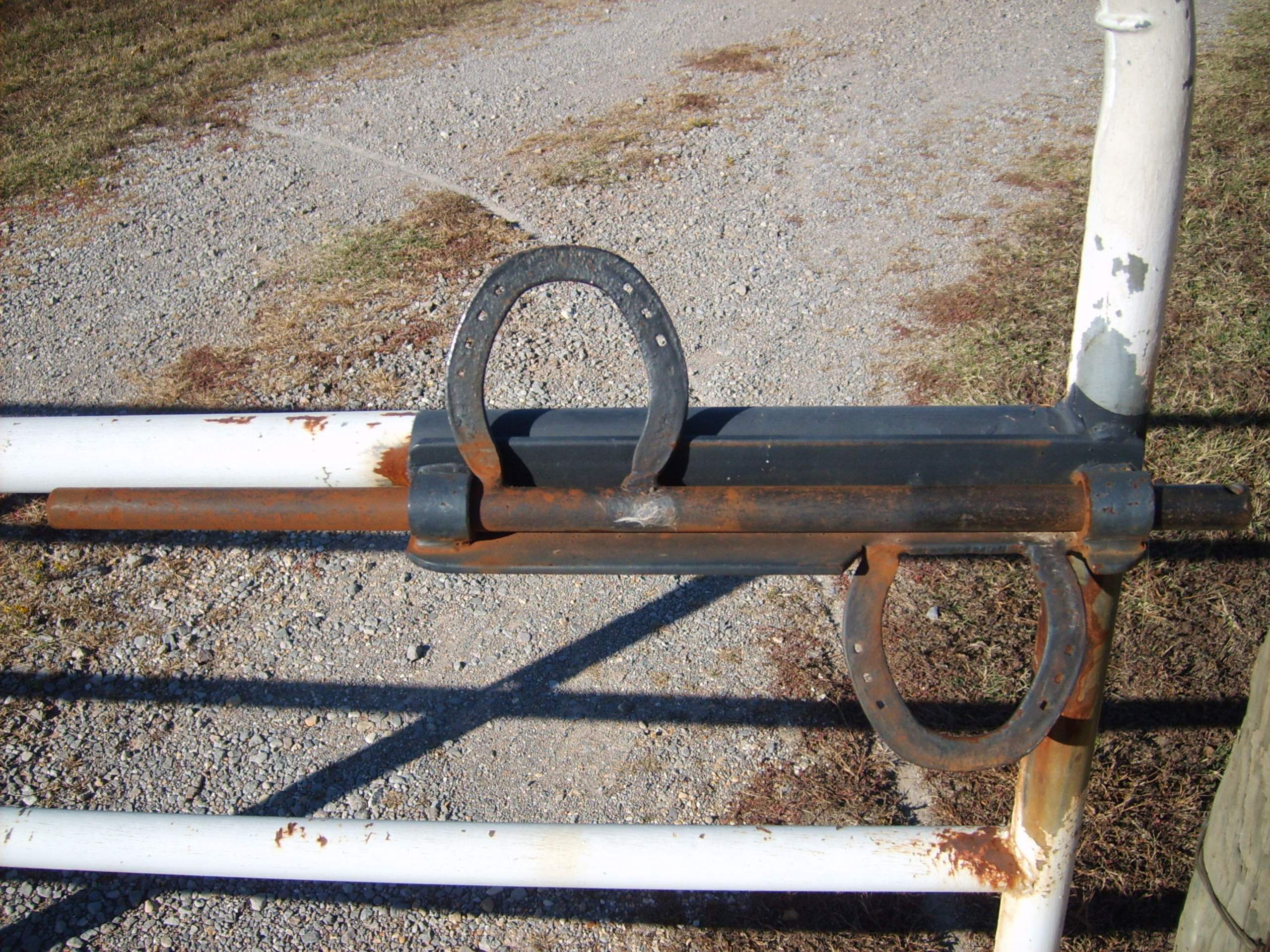

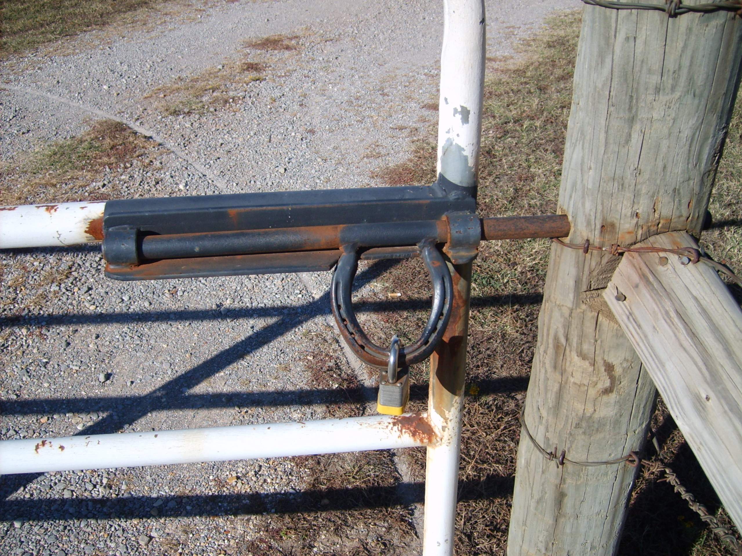

Tom, here's a pic of the one we have. The gate is a standard farm and ranch store tube gate and I fabricated the lock using an idea Harvey had and posted a few years back.
This one still allows the lock to be cut and will only keep out the lazy and sorry type of thief. Now for your average "hard working" thief it won't stop them. But lets face it if they want in bad enough....:mad:

Today while doing other stuff I came up with an idea that I think will drive thiefs crazy.
Look at this lock. I know you've seen them. Master Lock Co. Magnum Security Lock and Guarded Hasp - M736XKADCCSEN at The Home Depot
The way they work is the dead bolt is inside the lock itself.
Look at the horseshoe latch. Now imagine instead of horse shoe a round housing to hold the lock. A round housing with an opening for the keyhole in the round lock.
Now look at the shaft on the horseshoe latch. Instead of a horseshoe let us imagine a tab with a hole in it coming off of the shaft. That hole accepts the deadbold inside the round lock.
So what you have is a captured shaft that goes across the gate into a receiver on the post. On the gate you have a flat plate holding the round housing that holds the round lock. When you slide the bolt home the tab with the hole for the lock is captured by the lock.
You have no access to the deadbolt, the tab with the hole in it, or the round lock because of the housing.
This has to confuse a thief.

Harvey, I think I understand what you're saying and it sounds feasable. No real way to get at the lock with out tearing something up and making a lot of noise. I'm all for driving thieves crazy or some other far off place!:D

Tom, I really think you could make that setup work for a farm type gate. You would need to make it, not like mine, where it would swing one direction like your drawing and you'd have to position your "lock box" pipe and the plate that your "tee" pin drops through to allow one of your horizontal tubes on the gate to nestle between. I've seen the kind you're wanting to make on oilfield lease road gates and government land gates.:thumbsup:
