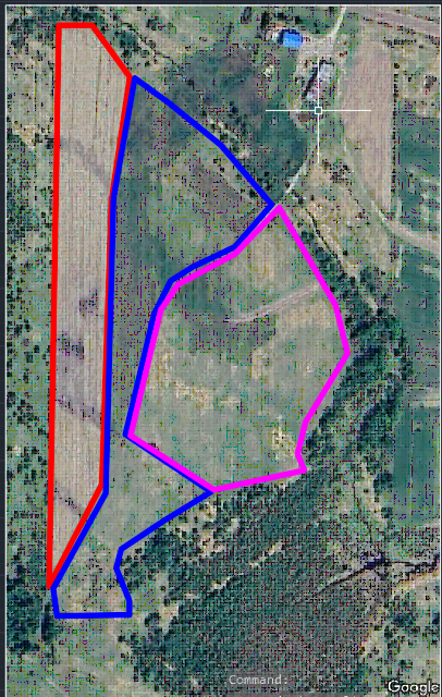

I have about 20 acres of farm field on our property in NW TN that has been fallow for a year now. Was planted for the last couple of decades with wheat, soybeans and corn. I'm looking to smooth it and plant with tall fescue ... more for a lawn than for haying. Right now it's a moonscape of crabgrass, johnson grass and every imaginalble type of prehistoric looking weed. This spring it was about four feet high and I knocked it down to about 5" with a Bush Hog, since then we've kept it rotating from about 8" down to 3" with a couple of zero turn mowers ... but of course we do it in sections.
I'd like to get it in fescue for the fall growing season (right now it's very dry). I'm trying to figure out how to approach this. The weeds really need to be turned under I think, they have formed large knots of roots that make discing with my small 5' cultivator a very long process, at least half a dozen passes. We are considering getting a tiller for the compact track loader, or for the Ford 1715 (if it has the HP) and tilling, smoothing and planting in managable size sections of a few acres at a time.
Equipment at my disposal are a Kubota BX2200, Ford 1715, rock rake, drag harrow, 5' disc harrow, SVL65 track loader, couple of ExMark ZTM, 55 gal sprayer, 100 lb broadcast spreader.
Come next spring I'll have to put down and effective pre-emergent and probably overseed.
I'm not looking forward to the slow process of tilling the entire field but I don't see any other way of really disposing of all the clumps of weeds to facilitate smoothing. Not a single rock within miles of our place so that at least is no worry.
Looking for suggestions or advice. Thanks

Hmmm, weird that you got no answers. You are close to the answers. Here is my take having done a similar recovery effort.
I would pull a series of soil tests at 6" deep. Make ten or so pulls, aggregate them into one test sample to send off. You need a base line to move forward from. No data, management is a guess. Apply any needed nutrient based upon agronomic rates provided by your test lab agronomist. Chemical or organics, your choice but organics would require more inputs over a longer number of years moving forward.
Resist the temptation to do deep plowing. Sure makes sense to zap the weeds that are each season creating a seed bank within the sward. As soon as you plow or disturb to any great depth they will come roaring back, plus the fact you are destroying the biological community of soil organisms that live in the top 6" of your soil, thus massive carbon release and soil structure degradation.
Consider your mowing as removing competition for the future fescue. Mow it down close during the optimal planting time for your area. (Out here in the islands we do fall planting from mid-August to mid or late Oct. just before frost. That way the fall rains help the germination.) So, how to get the seed in?
We mow to the lowest setting or over graze with sheep, then re-seed with a No-till drill. Look for someone with a ten or twelve food drill that you can rent or borrow. (You only need about 40hp tractor if you can find a Great Plains 606NT.) With adequate rain, soil temps above 50°F. you get germination, young seedlings can compete with existing sward. Combine your fescue seed with a robust, large leaf NZ type clover seed in the rear drill box such as Kakariki or Haifa, inoculated if possible. This will add long term nitrogen from the legume component and make the forage higher in Crude Protein.
Let the field respond, do not graze for the first year if at all. Let the new plants set in, deepen roots, it will blow you away how well it works. With adequate resources provided you may luck out and get a forage crop off of it the next year.

I’d do a complete burndown with herbicide, then no till drill with Tall Rebel Fescue if you want it to be clean. Then it can be a hay field, field, or lawn.
If you dont want to burn it with herbicides, then scalp it as low as possible and drill seed when climate is conducive to growth.

The OP will really set back the progress by tilling or plowing the soil. I would treat the broadleaf weeds by spray application of 2-4-D, then drill seeding the fescue grass. Avoid applying the 2-4-D under the drip canopy (and maybe 2 canopy widths) of desirable trees and continue to mow those areas short to manage the weeds.
