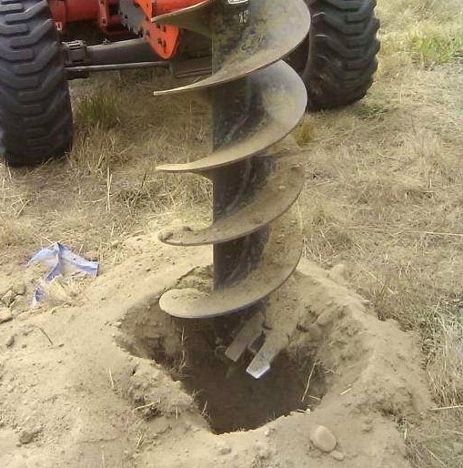

   / Farm fencing - augers vs post pounders #28
One of my properties has great soil and almost no rocks. My hydraulic auger on the FEL works wonders and the soil comes right up with the auger as a "cylinder". Another property has sandy and often rocky soil. In the dry season, the sand simply slides off the auger and any rocks seem to wallow out the hole wider rather than come up with the auger. There aren't any rocks in this hole, but some rocks I hit are 2 to 3 feet in diameter at which point the auger jams. I backhoe those out.

   / Farm fencing - augers vs post pounders #30
We had some nice rains lately and I drilled about 15 holes yesterday. The holes that were very sandy and without rocks came out nice and clean on the auger. That little bit of moisture held the sandy soil together. One hole had big rocks, so that one was still a pain.
