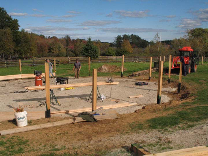

I needed to get a few projects completed (well, almost completed) before winter.

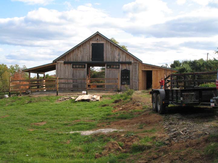

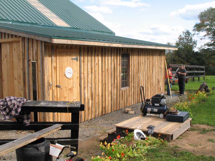

I invited a bunch of friends over - some local and some from the city. The city folk are going to be sore tomorrow. They tackled about 3.5 cords of wood - chunked and split - not stacked. My brother and his friend tackled the battens on the barn. My other country friends and wife tackled the new round pen.

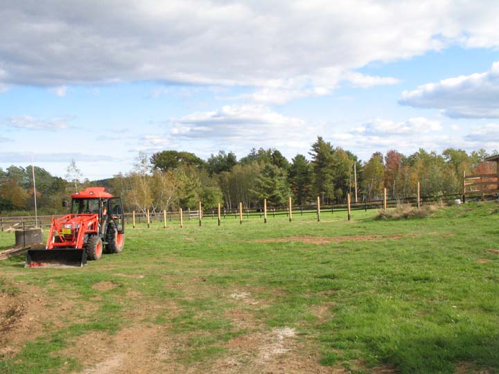

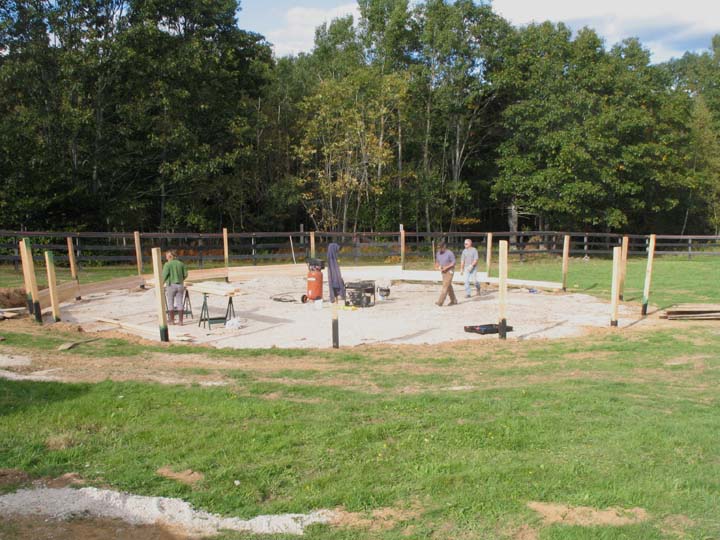

All the posts are in for two new sections of fences - 200' and 125' section; a good start on the round pen and 90% of the battens are on the barn addition - where the kioti lives.
The tractor carted the compressor and generator around as well as lumber and tools and augered the holes.
The posts are angled out in the round pen so when you are riding close to the rail you don't crack your knees.
We also brought in an addition 100 bales of hay.
Not bad for a days works - I expected more but I am not disappointed.

The posts are treated with copper 2 preservative and than painted with acrylic driveway sealer - thanks to Soundguy. I did a lot of research before going this way. Although arsenic treated posts are on the way out, some lumber yards are still getting ride of stock.
The new pressure treated posts use a copper base - much less toxic. In our area most posts rot around the 6" mark just above and below the ground area. I painted the posts to give them some protection. Only time will tell if it works.
