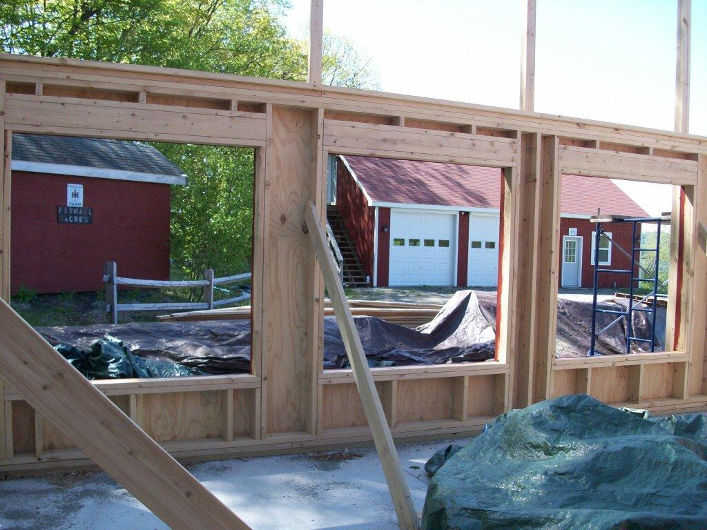

We decided on Anderson sliding windows. In the first picture, the front wall we will have two 4 ft by 5ft windows on either side of a 6 ft atrium door. Lots of glass to maximize the view. The long wall will have four 5 by 5 windows. And the back wall will have a 4 by 5 in the corner and then a 36" entry door and closest to the house and at the base of the stair case we will have one 3 bt 4 double hung.

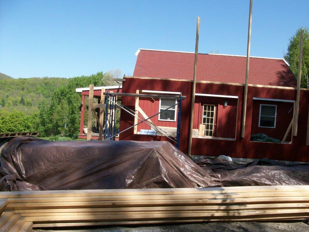

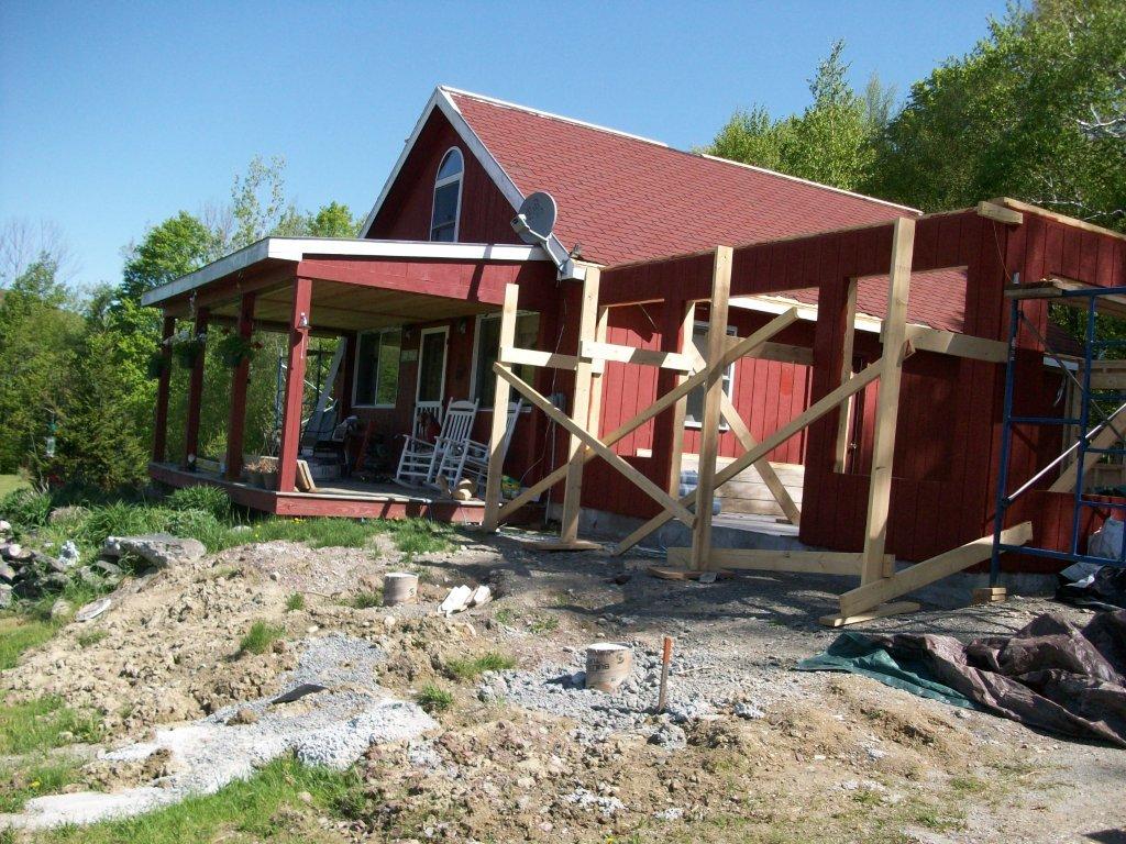

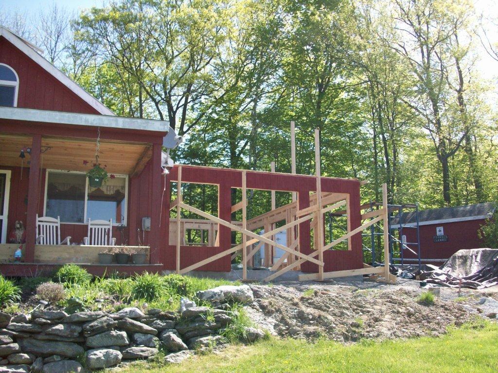

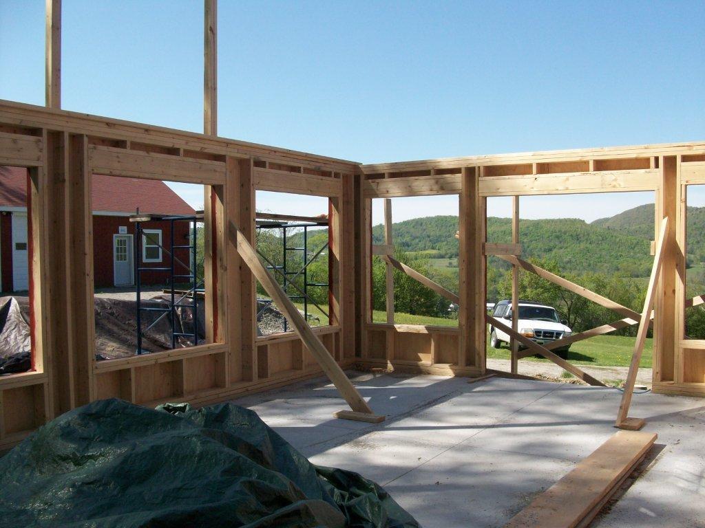

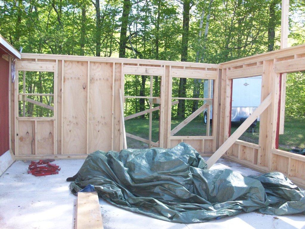

Lets try up loading some photos !
First pic, looking at front of addition, second pic looking at rear of addition, 3rd pic inside looking at front corner, 4th pic inside looking towards the barn, 5th pic looking at the right side, 6th pic looking at front right corner...
Sorry for the delay on posting the pictures...:)
Trusses will be next ,,,,,;)

Looks nice. You have a BIL in the window business? :laughing: It's going to be a very daylight room with nice views.
   / Familyroom Addition on our Cabin #6
Looks very nice, and well thought out…Beautiful country side Tony
Looks very nice, and well thought out?eautiful country side Tony

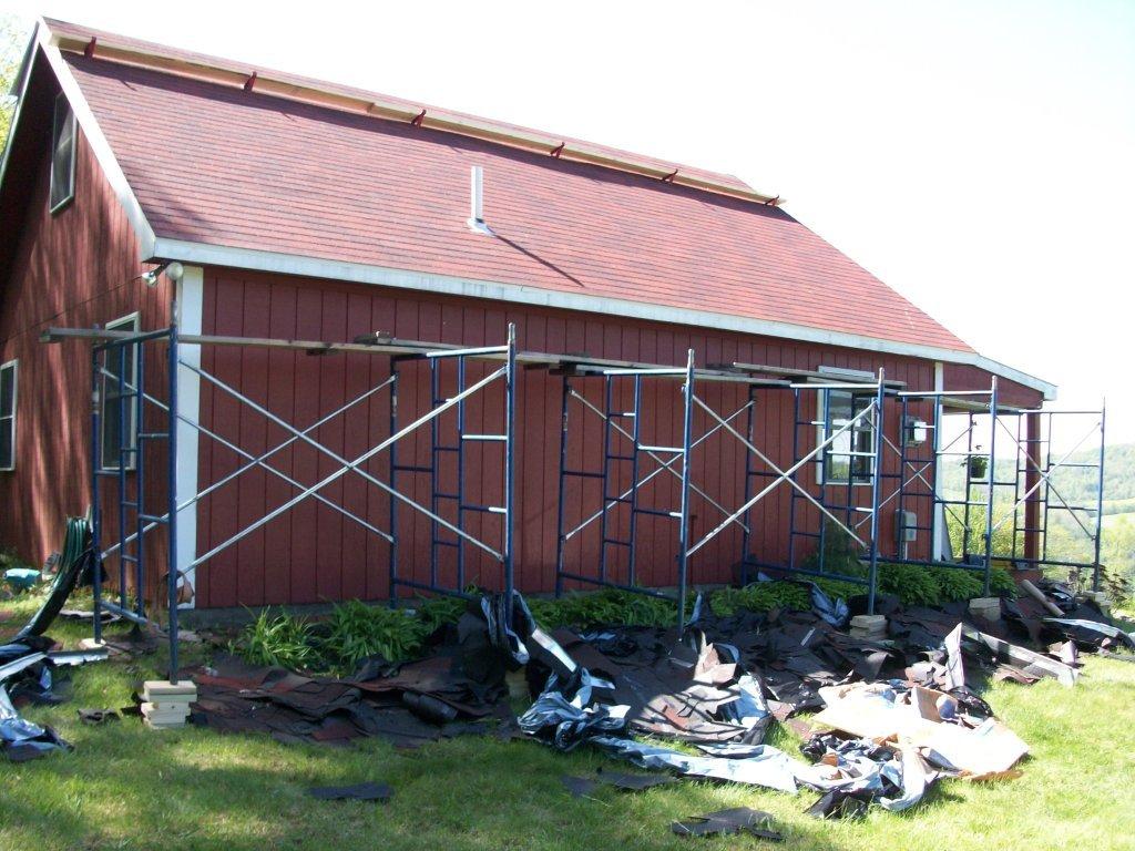

Good Morning Tony,
Thanks, so far the project has gone pretty well considering that the weather in new england does not always cooperate. We cant get a crane for the trusses until the end of the week so that slowed things up a little bit.
We did manage to get the left roof torn off and reshingled while waiting for the crane.
Dave, yes all the windows turned out to be expensive, but it would be a shame to stand in that room and not take advantage of the views !:)

Congratulations on an exciting project!!!!! We're hoping to do something similar next year. The planning is all done, it's just a matter of finishing off some other projects before we start a new one.
I'm a big fan of using lots of lumber in framing and believe you can't use too much, but your bottom and top plates have be wondering what you are doing? From the pics it looks like three layers of bottom plates and four top plates. Are you adding height or is their a structural reason for this?
I'm also wondering why you didn't wrap the house? Air infiltration is where most heat and cold air is lost and house wrap is really a very inexpensive way to seal the walls from wind getting in.

Good Morning Eddie,
Thanks !
The bottom plate is pressure treated and bolted to the slab with the foam foundation seal sandwiched in between, using J bolts.
That top 2 by 6 is going to position the end truss and then we are going to strap all the other trusses with 2 by 4's in the floor for strength.
The walls are 2 by 6 so plenty of insulation to keep out the cold air, I did the same thing in the shop section of the barn, and its pretty darn tight even in cold windy winter weather.
In the barn I packed insulation all around the windows before I finish trimmed them out, no drafts at all...
Will post some truss pics soon ! :)
OK sorry, so what we do is bolt that bottom plate to the slab, and then lift the wall into position with enough over hang on the T 111 to extend past the PT bottom plate.
