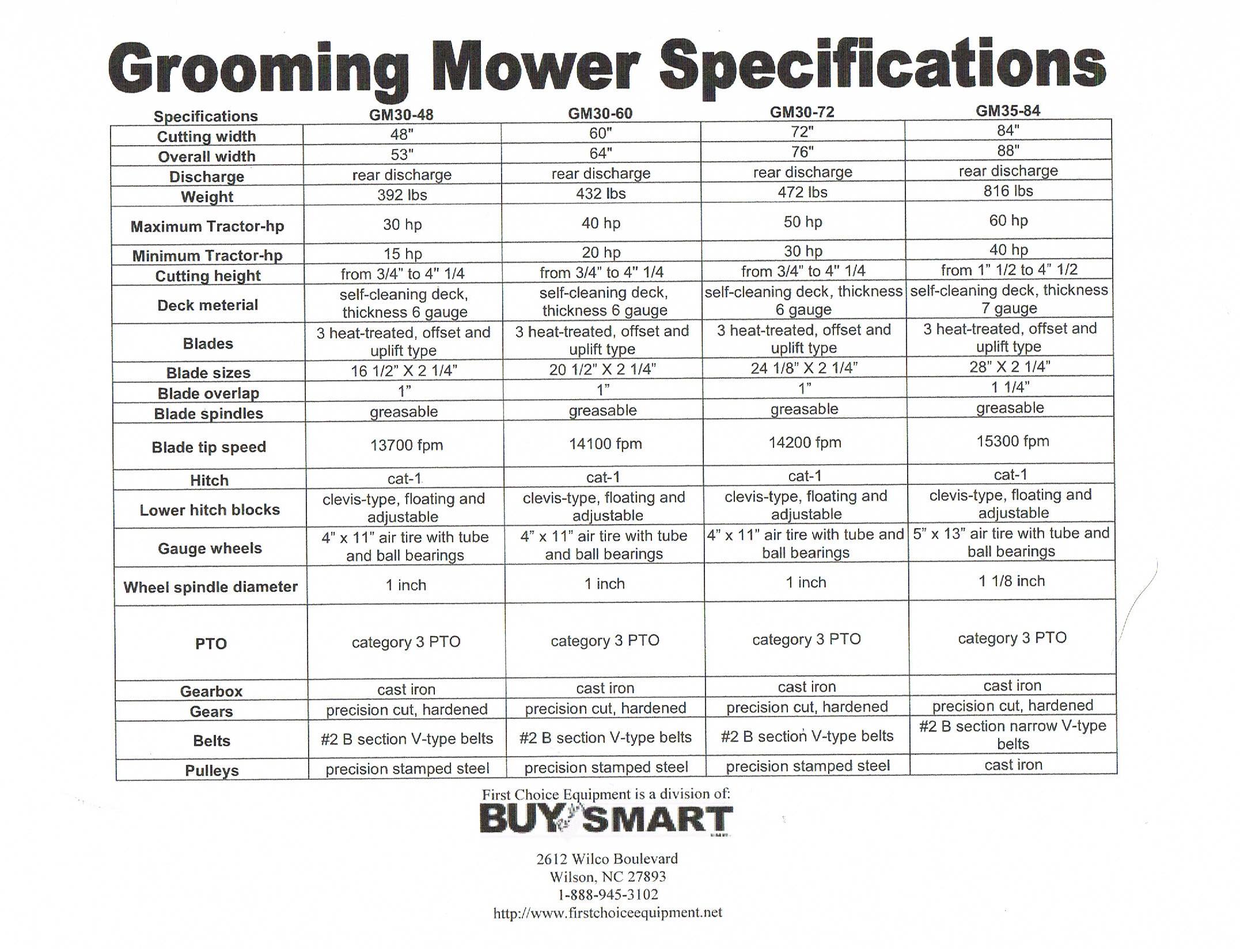

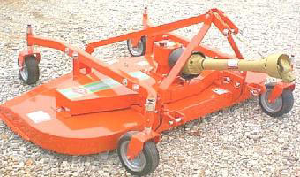

If you want Landpride/Woods quality and features below KK price, Here is the Finish Mower for you. Ken Sweet
