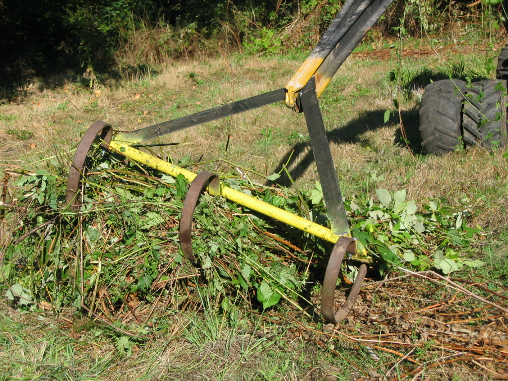

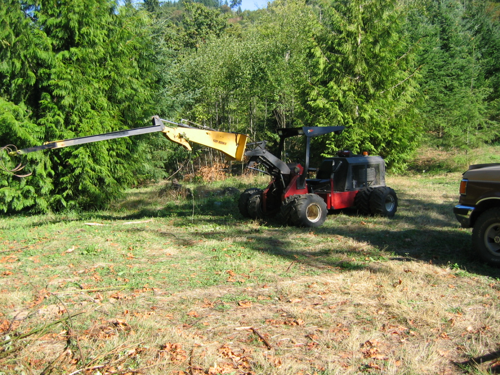

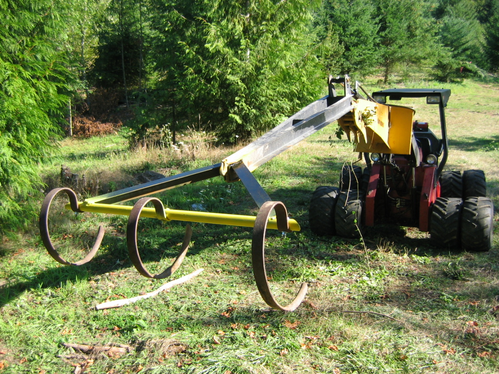

I have a huge blackberry issue, along with surprise ravines and major chuck holes hidden in my blackberries... I am trying to find the property without dumping my PT into a pit....

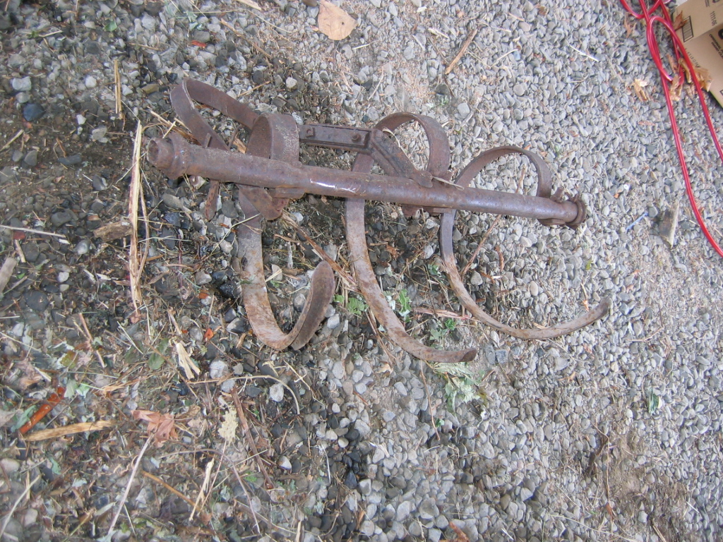

I found with my mower a piece off a spring harrow. Wanting to practice my welding skills I decided to build a device to reach up high into trees as well as over edges of ravines and pull out / level my blackberries and such...
Basically pipe, some angle iron, and a bit of plate and some bolts... I attached the boom attachment to the backhoe (I had been using just the backhoe to test the ground ahead before). Figured I could use the reach to get into the trees and down the ravines.
Well, it worked... Kinda... Here is the failures... The harrows are a bad idea for landscape rakes. They really hold onto everything... Second, I am a terrible (novice) welder, finally, the blackberries are really heavy and pretty firm into the ground.
Basically, I got about 15 minutes of use before I broke it. Snapped a weld. I could build it stronger, but the Tines are the failing. I also need to make the mount ambidextorus to work on both the back hoe and out on the long boom...
Also it is a PITA to remove the bucket head and then put on the boom pole. I know I am soft from having a PT where every implement is no more than a 45 second change, but....
the resolution will be to look for some different tines and figure out a more universal mounting system...

Interesting idea! I wonder if cutting about a foot off each tine might make it a little less aggressive and not hold on to everything quite as much, more of a raking effect? I've been mowing and cutting them back for 12 years now and still don't dare turn my back to them.

Carl,
That's quite the reach. Almost makes me wish I had got the lifting boom attachment.
Do you have your rake welded to the boom or bolted?

Bolted, and on further inspection I bent the heck out of that. Will need to beef it up in future designs...
Also, yeah, the length is Way Cool. until you have to drive it around. Trying to get in and out of trees... Heck, trying to get it out of the carport... But, it is cool to be 15 feet out ahead of your tires..
I just went out with the PT and backhoe... Found myself staring at some sort of man made pit... Glad for technique, wish this arm method would work.
Those tines would be a bugger to cut without a torch. I am going to just go buy some... Can't be that expensive...

What you need is a hydraulic line all the way out to the end, with a big pair of "Snippers" powered by a cylinder, actuated by a valve.
Maybe ditch the ctines, and go with a 2 foot piece of flat bar stock, ground sharp, and pull it back toward you, keeping it close to the ground?
