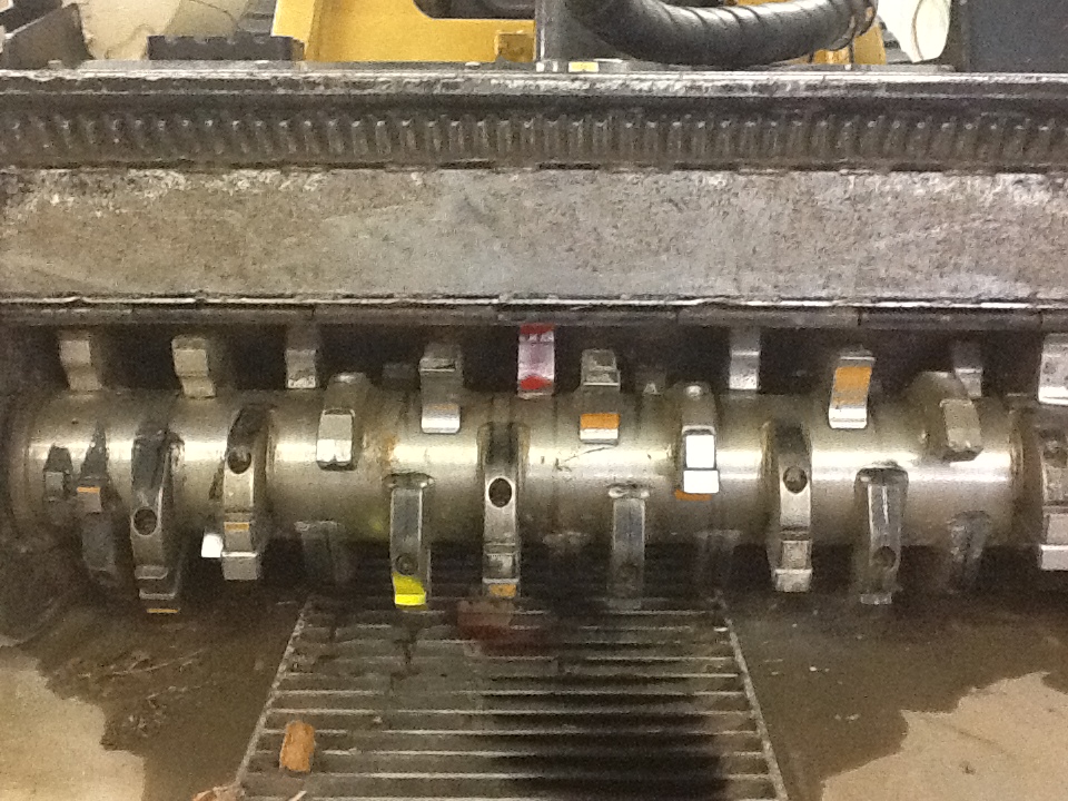

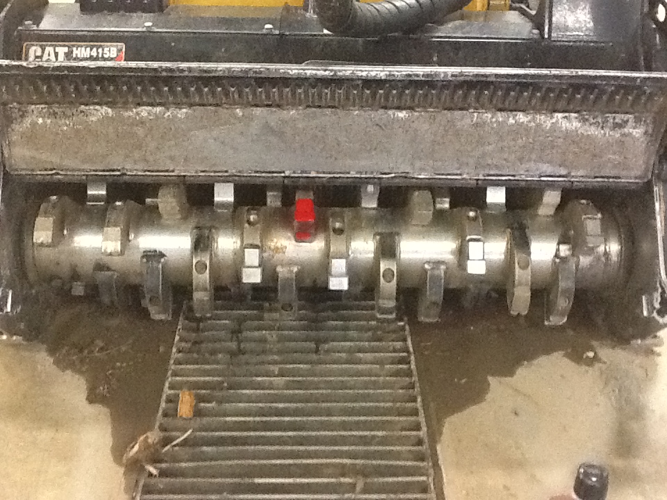

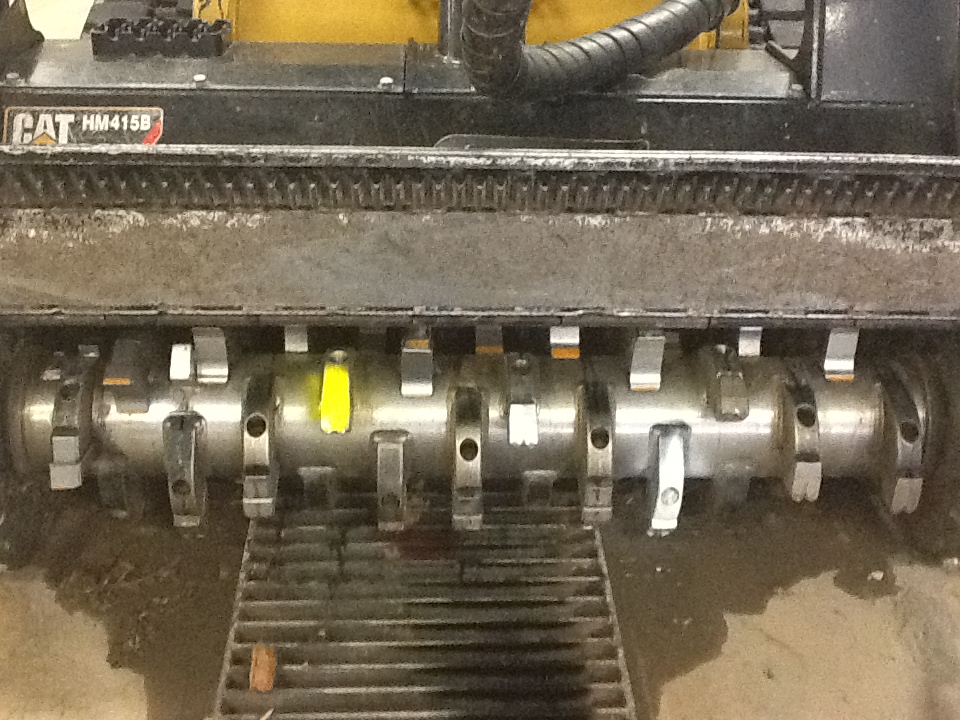

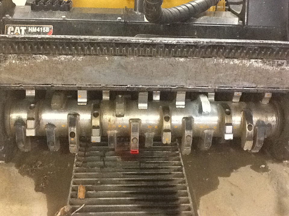

Finally found the pics of the rotor. It seems like you get twice as much done with the chippers on.
