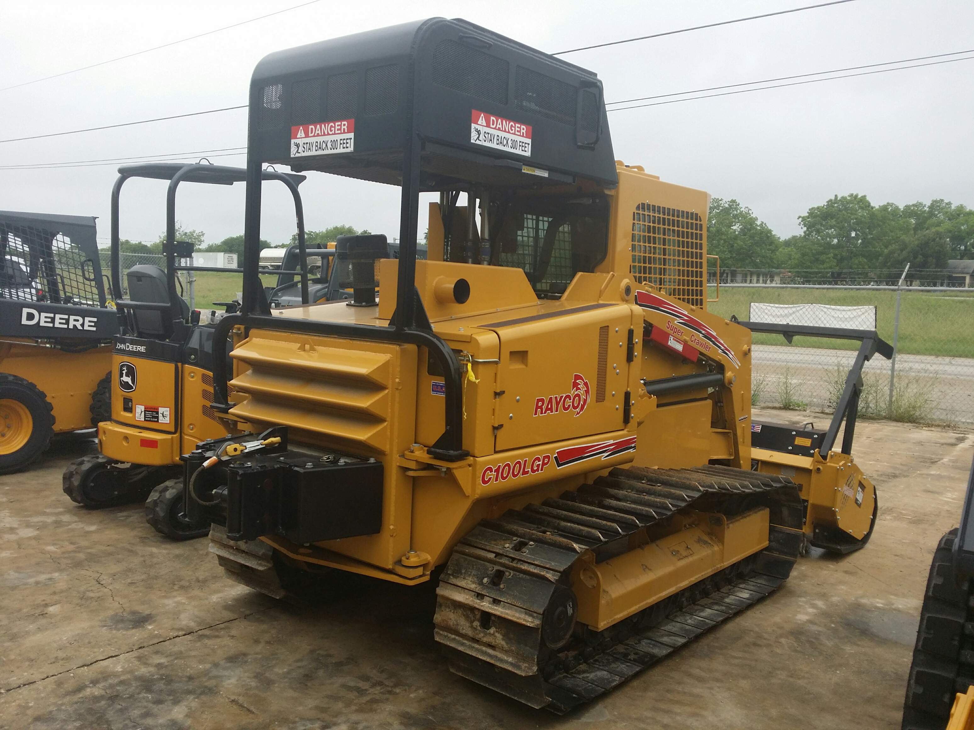

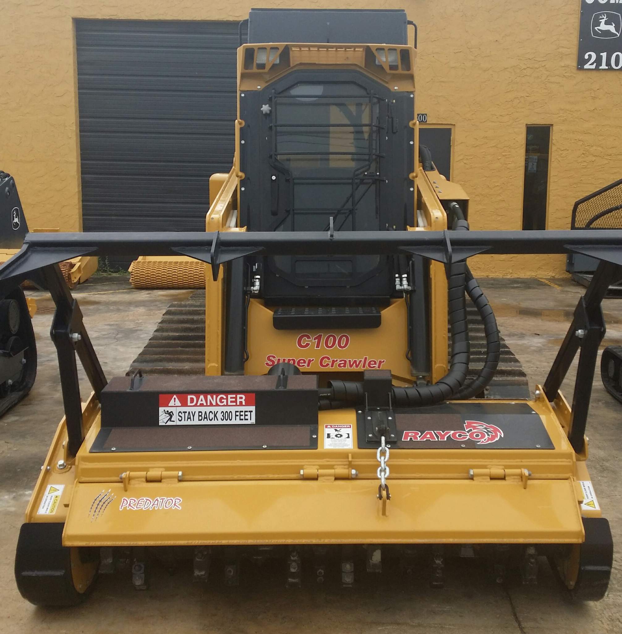

Oh, here's a couple of pics of the c100 that is selling at or near cost. I was impressed by the size of this machine compared to a JD 333 ctl.
