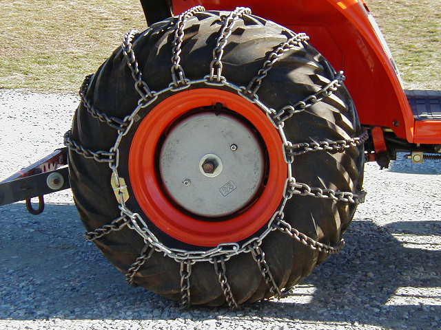

Used your method! Worked like a charm. Added 4 X 25 LBs per wheel. Weights from Wall Mart. Total project was less than $90.
