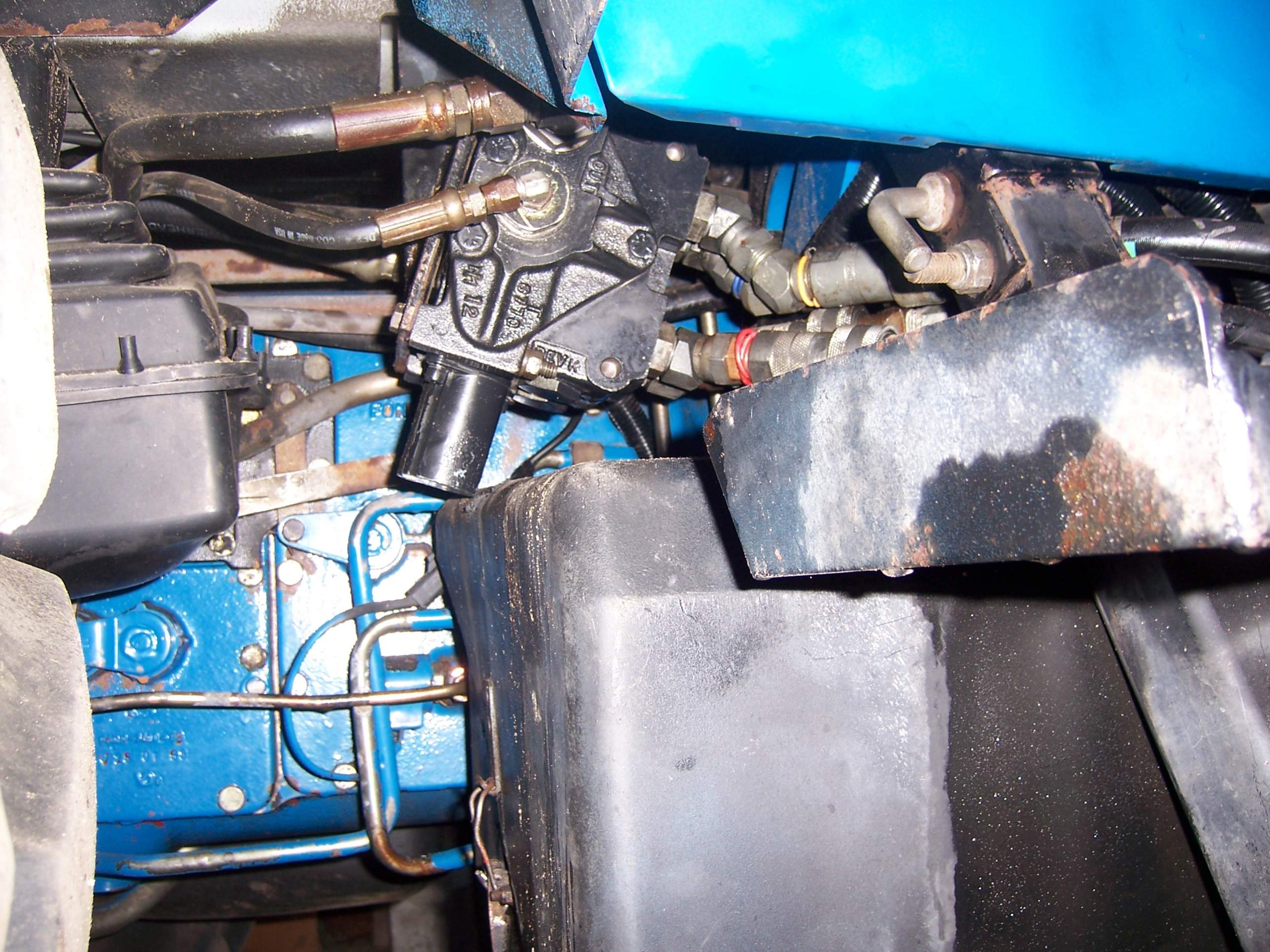

New valve and Joystick assembly arrived. We finished R&R it yesterday it was not a "five minute job". Started late afternoon Friday quit around 9 pm and finially finished around noon Saturday. Hardest part was connecting cables to the valve spools. Everything is working fine now including higher pressure readings at all outlets including rear remotes. Everything reads approx 2800 psi. So I must of had a bad internal leak in the loader spool valve.

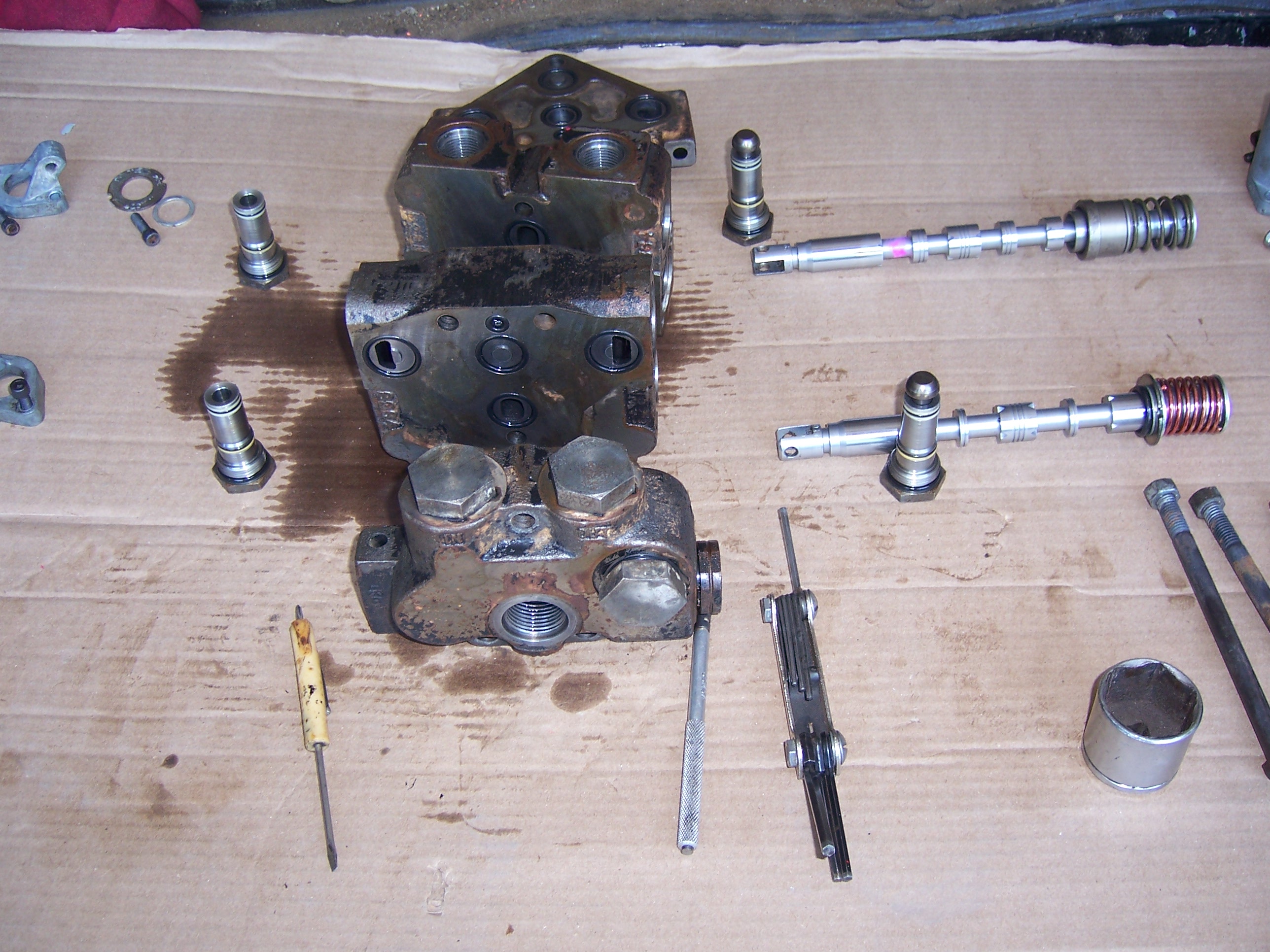

I was curious so I took the old valve apart this morning. No bulging or broken orings, the hoist/float spool had some scratches in it but nothing major It only had one load check (item 11) in it though not the two it shows in the parts diagram on Messicks site New Holland 7411-SERIES QUICK ATTACH FARM LOADERS (017 control valve)nor does it have the bleed off plug Item 58. I could see no cracks anywhere in any of the sections, no broken springs or other missing parts. Maybe a hairline crack that I can't see and only opens under pressure or spools worn so they leak by? I don't know what caused the problem in the first place which bothers me. Any Ideas?
Bottom line is, it is working fine now thanks to all who helped along the way.
We think we might of found a crack inside a galley of the old spool valve. I thought at first it was a casting mark but on closer inspection I think it might be a crack. Here are some pictures of it.
