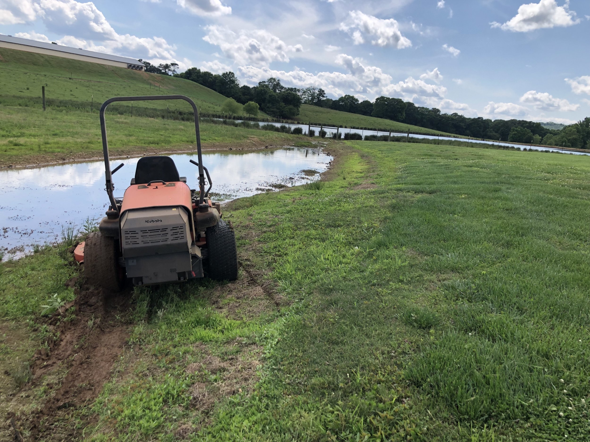

Right!!! Thats traction. An F gets better traction!
Got too close to the mush this afternoon :rolleyes:
The New F is torn down for deck wheel mod :(
Zoom in on my steep bank beside chicken house across the lake
   / F3990 vs newer F3710 4wd front deck mowers #152
You dummy 😂
That’s been the story of this Spring around here, too. I got stuck Monday and used my F to pull the ZD-1211 out. I know how you feel.
Wet & cold
