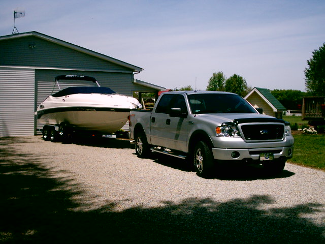

/ F250 superduty #9
This vehical will be used and a daily driver for me to get to work, about 30 miles a day. 4wd is a must and i feel more comfortable with standards. I will be towing a tractor and trailer with a combined weight of approx 8700lbs max distance of 80 miles one way. Top speed will never be over 55 and the mileage unloaded is more important to me then the loaded. Diesel would be idea but if most of my driving will be unloaded then why bother. My 96 dodge ram 1500 get 15 with 210,000 on it and if i could stay at that i would be happy.
For the driving you do and the occasional towing you need to look at a half ton 4x4 truck like a F-150. I have a 2007 F-150 FX4 4x4 with the 5.4L and 3.73 gears. It gets 16.4 mpg average, mixed driving. bought it new in May of 2007 and it now has 21,000 miles on it. We take it on a trip to Knoxville, Tn area from Northern Indiana a few times a year with 4 people on board in June, July, and August. On that 1,000 mile round trip towing the boat in the picture. It weighs 7,000# and we fill boat with our gear and the bed last trip had over 35 cases of water, pop, and beer. It got 11 mpg doing 70-75 on that trip. Towing around secondary roads like I do every weekend from late April to late October it gets 11mpg also at 55 max.
It is very comfortable and quite and rides like a dream. Easy to get around the parking lots for day to day use and I would not hesitate to put 9,000# behind it. By the way the tow rating is 9,300#.
