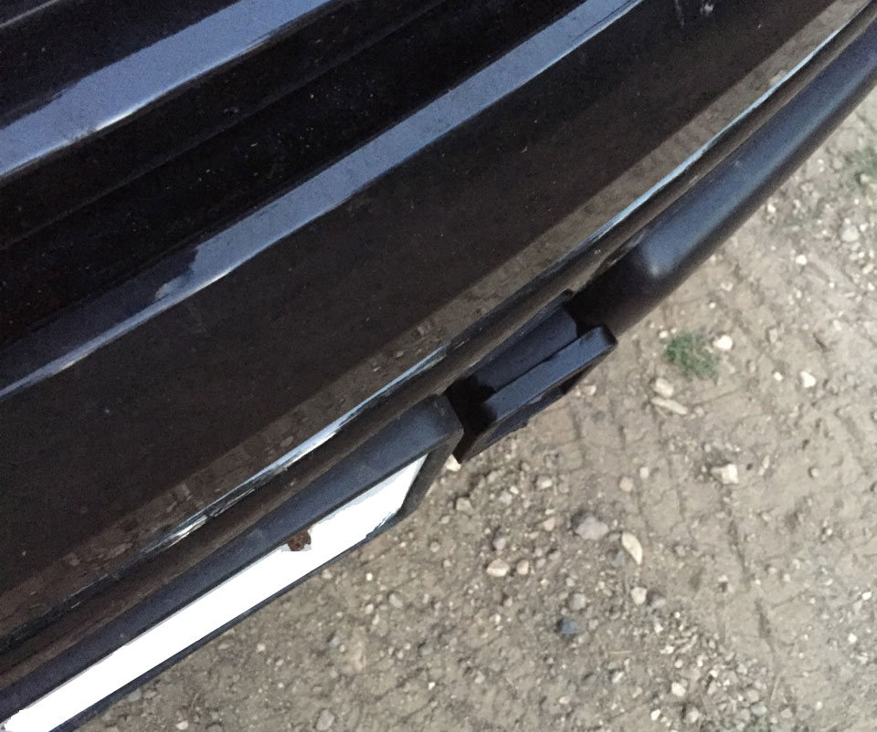

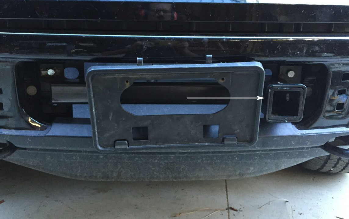

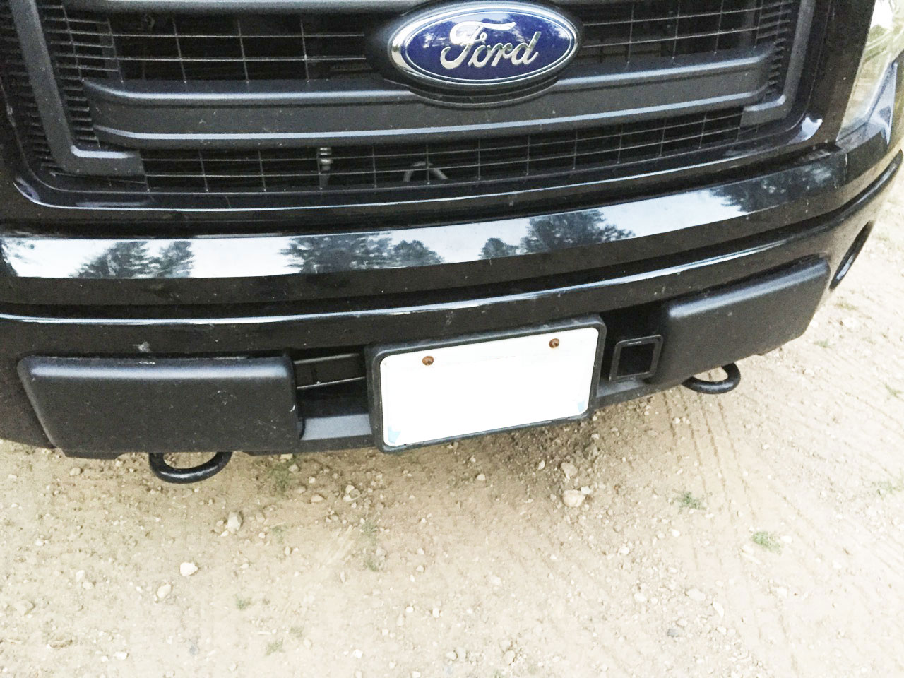

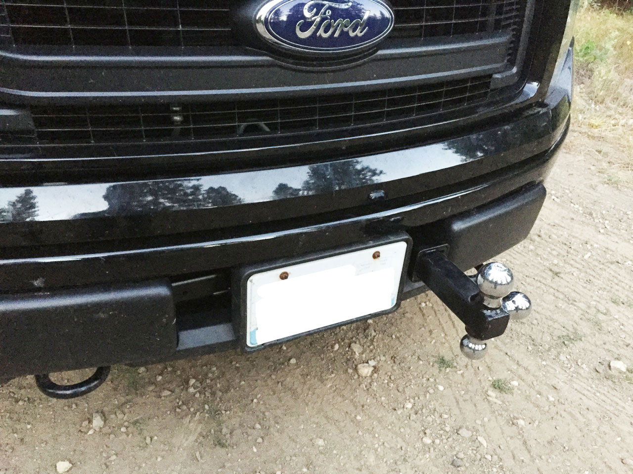

This is the build thread. ( research thread here). A smarter man would buy an Ecoboost license plate holder that mounts off to the right but I'm not that man (then I'd have to wait). Nor did I think of simply screwing the plate directly to that plastic rectangle. :duh: These are good options! Anyway yesterday was my project day, and I kinda had a little too much momentum :D but you V8 fellas can use both foresight & hindsight. Could be easier for Ecoboost owners, but I think the intercooler uses that opening?
There are a couple available to buy (Draw-Tite and Curt), and inexpensive but they are too LOW (10"off the ground!). I prefer it the same height as the rear hitch. You can also replace the entire bumper with a heavy-duty bumper that has a receiver feature. I wanted it to blend in and not be visible, so here it is.
436744d1438981110-f150-front-2-receiver-hitch-f150_front_8-jpg
Flush with License plate.

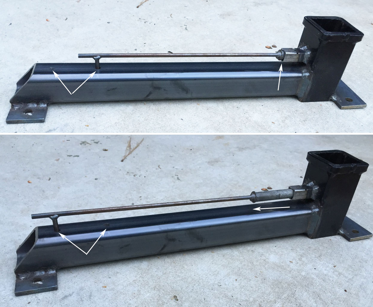

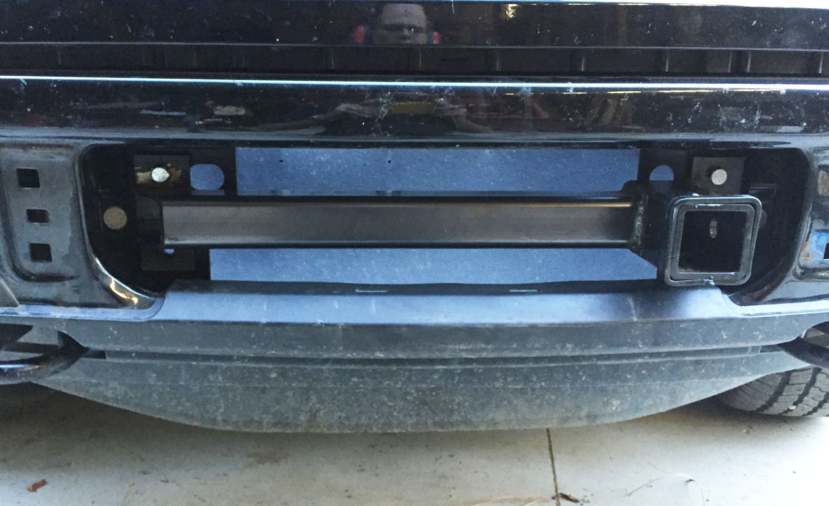

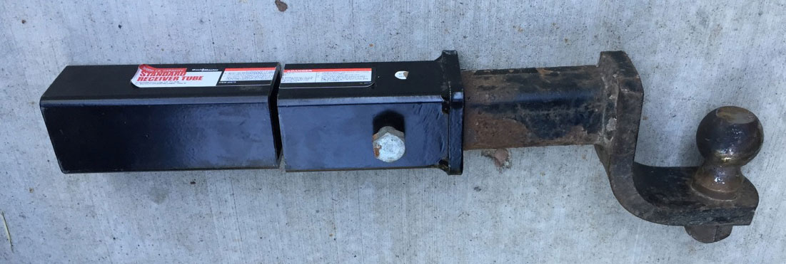

Started by cutting a Harbor Freight receiver hitch at the minimum length to hold one of ball hitches.

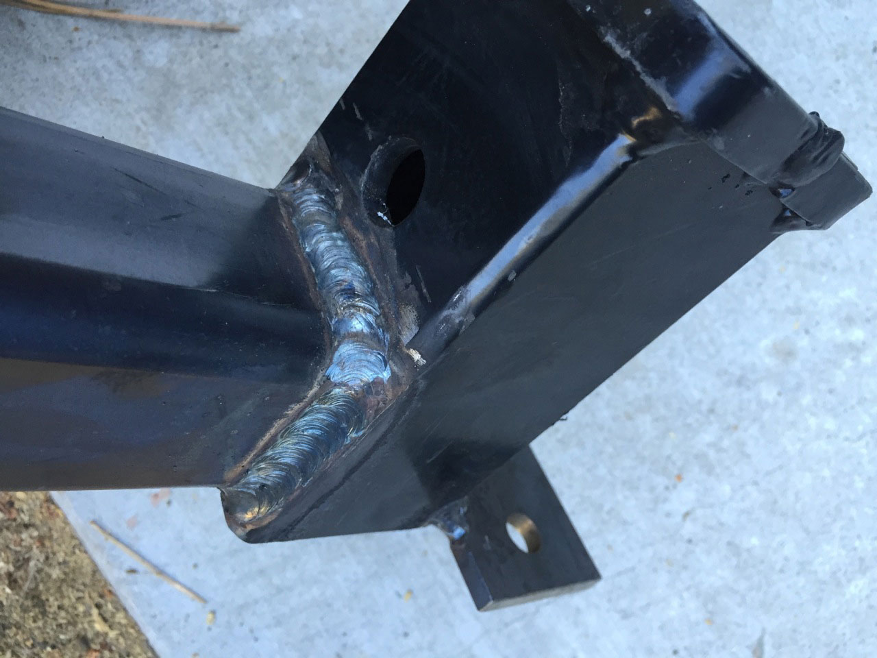

I use 7018 rod because it makes me weld like a hero. Cross bar is 2 x 2 x 3/16"

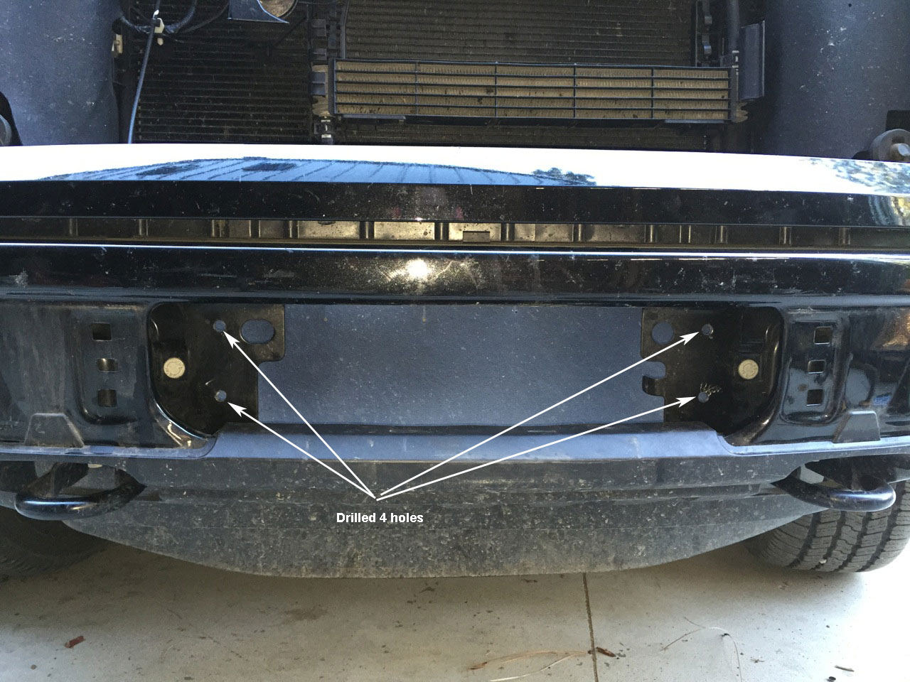

Drilled four 7/16" holes in the front plates behind the bumper. I gave a lot of thought to tying it into the frame, accessing the towhook bolts etc. The more I thought about it, it's NOT a trailer hitch, not towing 9,000 lbs down the freeway. Not a towbar receiver. In the end decided to simply bolt it to the front plates. It's going to be used to jockey a trailer around and some other non-towing uses.

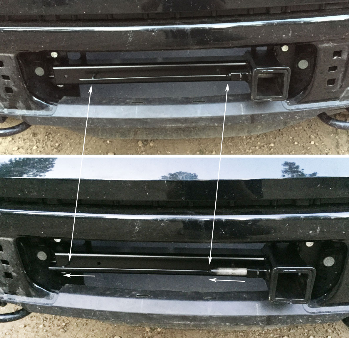

Checking access to get to the hitch pin.
This is the nicest sq tube material I've ever seen. I was apprehensive to use it on something so inelegant as a hitch. No scale at all, gun-metal blue, and even shinier than Steve's projects. :D
Decided to access the pin with an extension thru the hole at left side of the license plate. A solid 1/4" rod is welded to the pin. A peg is welded to the extension that engages a hole to retain it in either pin-out or pin-locked position. The spring-flex of the rod holds the peg in the hole, so there are no clips to lose.

Sodo that's excellent. Great work on accessing the pin from the other side. I like how the springiness of the rod is used to retain it in both positions.

Good thinking. I never would have thought of what you did with the pin. Clever.

Very Nice Work... I will have to remember this one...

All the work you went to, you coulda put one on the OTHER side, then (since you'd probly not use both at once) you could have made your "auto-pin thingy" so you moved it full stroke one way to lock one receiver, and the other way to lock the other side.

:laughing: :laughing: :laughing: Steve you are completely, utterly, OUT of control! Of course I like to think for two hours to find a way that saves 2 hours over the course of 50 years so that DOES appeal to me. Can't use the flex feature though.

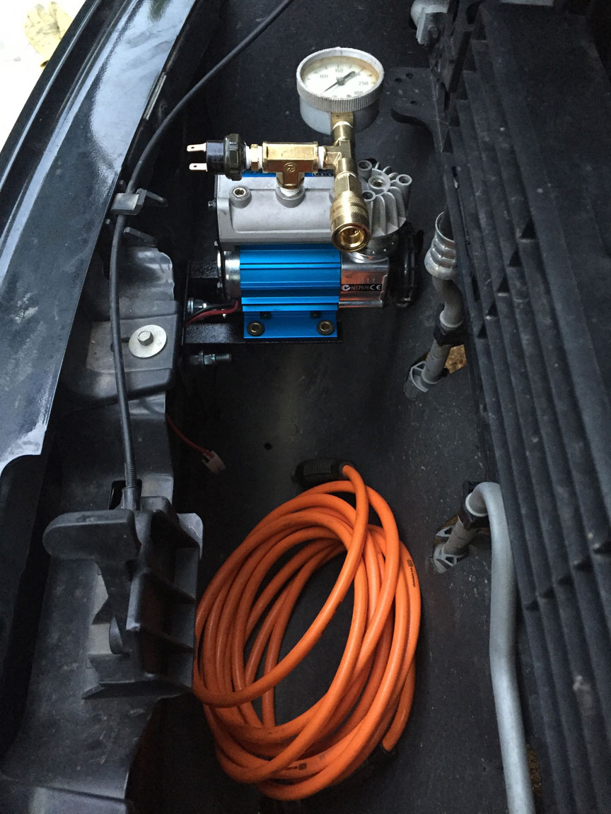

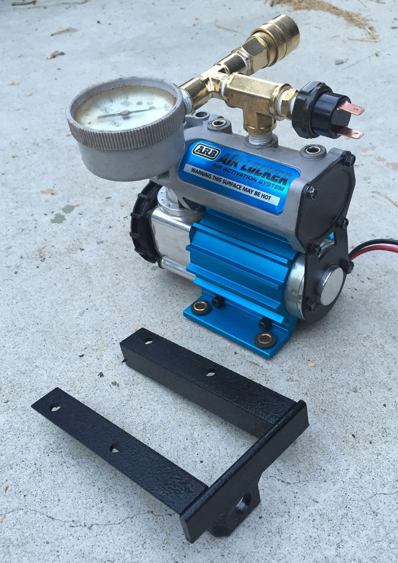

Thanks guys. There's so much space ahead of the radiator it's like a front trunk. So I mounted a 12v compressor in there. It's ARB brand, made for operating an air locker but it seems pretty stout. Wish I had a rollbar or some tank volume to pressurize. I think I'll make some kind of carrier for the hose and air chucks etc.
