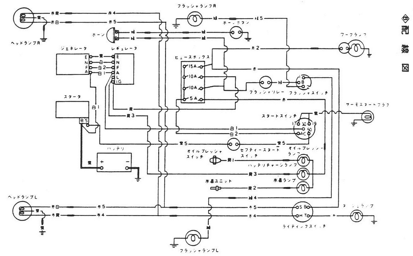

Why does Hoye show this for the YM2610 ???
Home/ YM2610_2610D» ELECTRIC» GLOW PLUG (THERMO-START PLUG)
GLOW PLUG (THERMO-START PLUG): Yanmar Tractor Parts
Does it have BOTH ??? I'm looking for any intake heater too. :)
Now, I'll have to look thru all of those scanned pages. :duck:

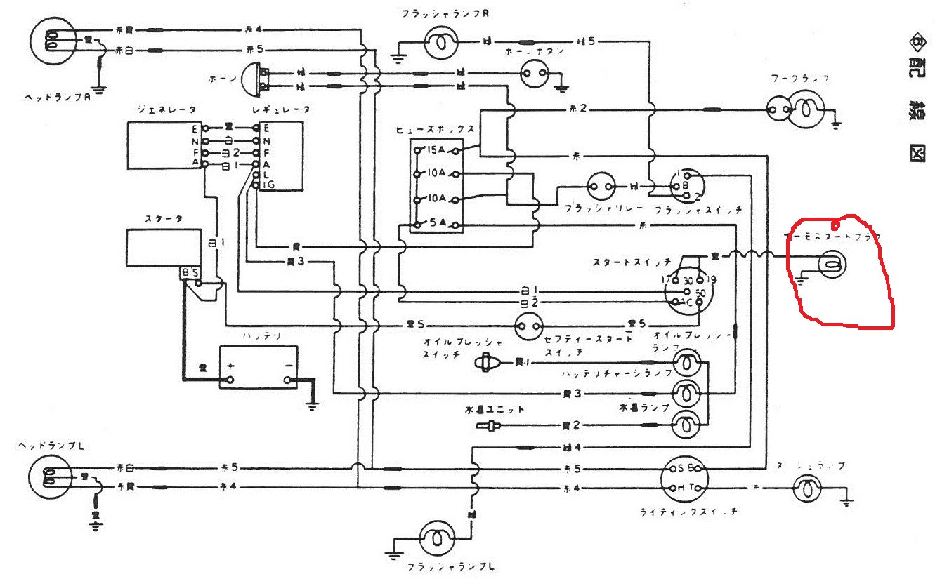

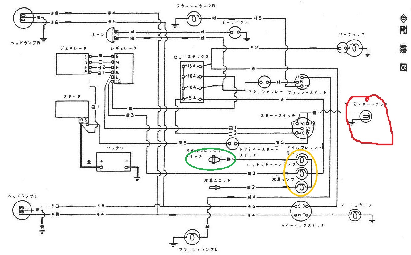

So, there isn't much to go by on the heater or glow plug in this ... Anyone got an idea in this image? Maybe R1 ???

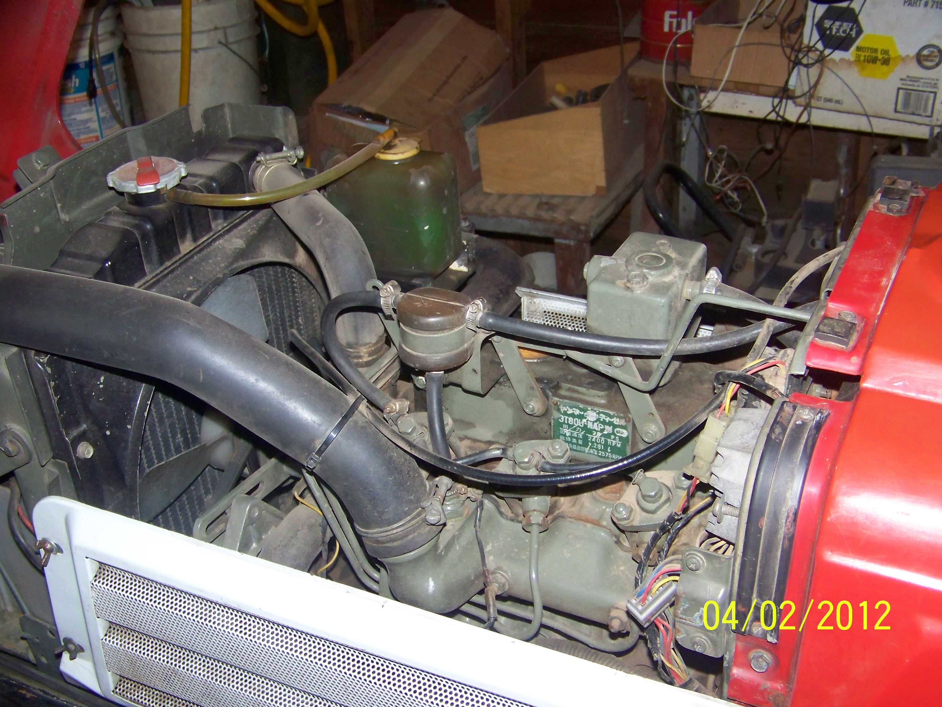

You only have a thermostart plug. Tried to circle it with paint but wasn't smart enough to do it. Just follow the little hose down from the bottom of the little container. The thermostart screws into the top of the intake manifold. Your 2610 may not be exactly like the picture of my old 2002D but will be similar.
