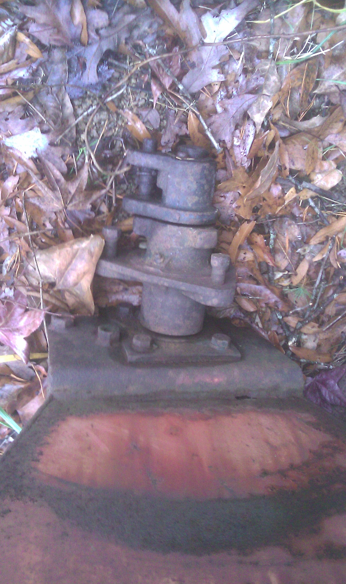

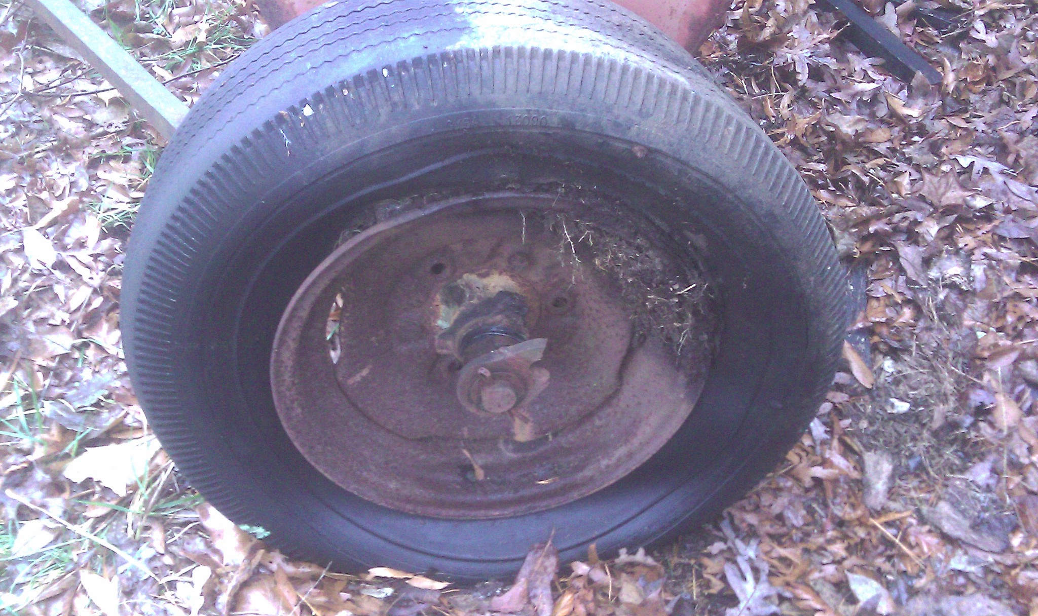

The wheels are spokies which have a specially designed hub to operate the agitators. They are held on by a single bolt.....which is also a shear bolt. (I have sheared one once when applying lime and I hit a tree.)

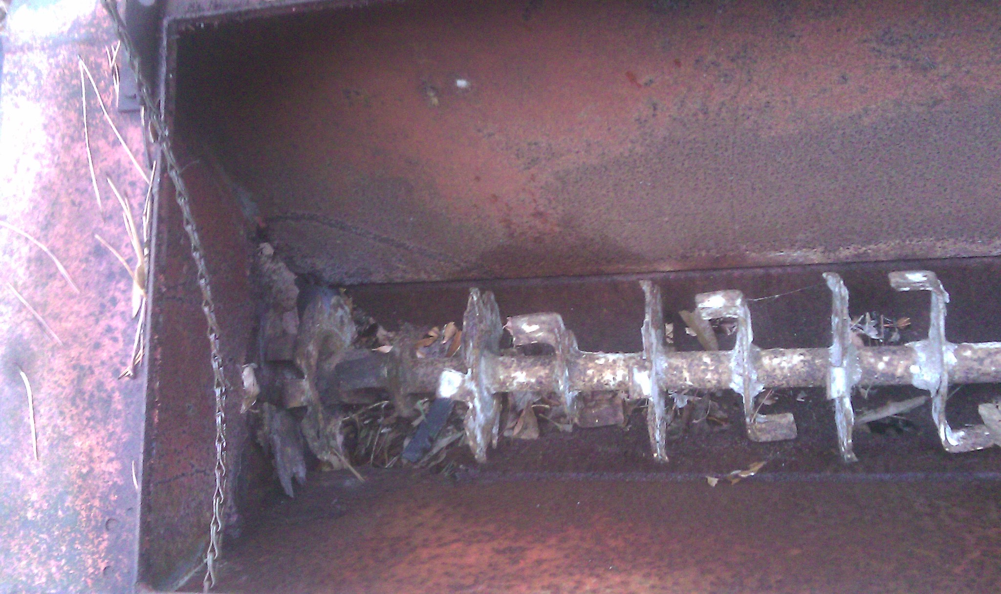

I took these pictures when I disassembled my spreader and cut two feet from both sides of the hopper - in order to turn a ten footer into a six footer.
I believe the pics detail the drive and hubs. Picture #2 shows the bearing block that is held in the center and it holds both agitators (which on my spreader are driven by the left and right wheels).

Thanks. I hope you can figure a way to get yours operating. I got to thinking about the wheel hubs.....and that is going to be a challenge for you. IIRC about 2/3rds of the wheel hub rides on that outer, bolt-on section shown in picture #1 (which is about 3" diameter)......and 1/3 of the wheel hub is of smaller diameter and drives the agitator shaft (which is about 1 1/4" diameter).
I remember the inside of the hub was made with a bronze sleeve and it is a novel arrangement. There is one grease zerk in each wheel hub to feed either end. The tire size is unusual and in quite close relationship to the hopper in places....but I found some low-cost car tires to fit the wheels.

You likely could have some hubs machined on a lathe to fit the EZ Flow and weld some car wheels to the hubs (?). I can see this working for food plotting and occasional use ( unless your going to use it over many miles of spreading) .
FWIW As for disengaging the agitators......there are a few models that do have this feature. (I think New Idea and John Deere had disengagements maybe others?) But most of the EZ Flow's have a continuously operated agitators.

I've been trying to remember the details of how that hub works.....and I think if you refer to the first pic with the spoke wheel. What is missing from this pic is that (IIRC) there is a (all these dimensions are guess-work) 1.5" long x 3" OD x 1.25" ID "spool" that inserts into the wheel hub and abuts the larger bolt-on tube laying on the floor. It has a cross hole that aligns with the wheel hub's hole and the hole in the agitator shaft.
Thus even if you shear the cross bolt (say a rock gets caught in the agitators) the wheel is supported by the hub (at least for a short time).

The hubs were a three bolt setup that looked like it takes a standard 6 lug AG wheel, but only three of the holes are used.
It also looks like it has a means of disconnecting the agitators from the wheel hub.

The pic you show is of me holding the center pillow block / shaft support. Mine had no bearing or bushing in it. It simply supports the ends of the shafts and has a collar with a set screw.
The collars on mine were frozen on the shaft(s) so when I reduced the shaft length I bought new collars. I had the (reduced lenth) shaft ends cleaned up to insert into the block (I think I had to remove some aggitator sections?). I beleive the original collars may have had some type of curves along the sides to mate with the pillow block (shown) which acted as a grease seal. The collars I bought do not have such....and are just flat. The pillow block has a grease fitting and I will keep it lubed with a few strokes from the gun.
Keep in mind the shaft is retained (in and out) by the wheel hub / cross bolt assembly on the outboard end of this shaft. The collars primarilly "just" keep he material from getting into the pillow block.
