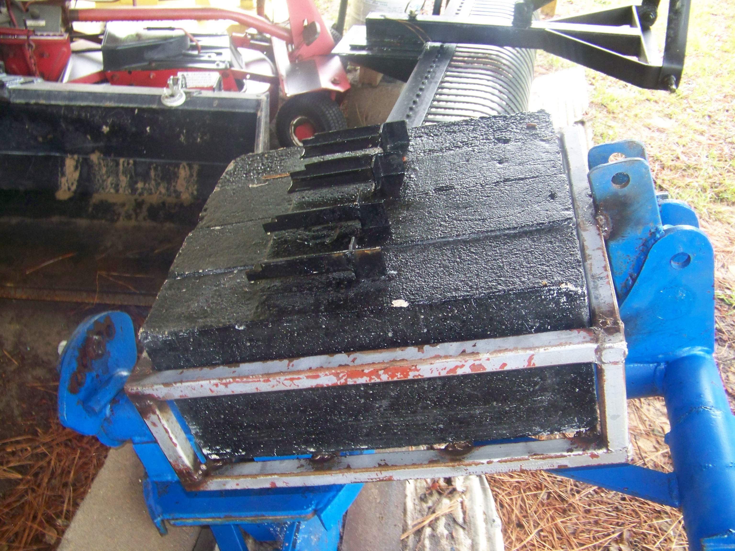

   / Extra weight on a scrape blade #4
Here is what I added to mine. I made the weights to hang on the front of my tractor but later bought a couple of suitcase weights so these got moved to my blade. They weigh about 50 lbs each. 200 lbs on there definitely makes a difference.

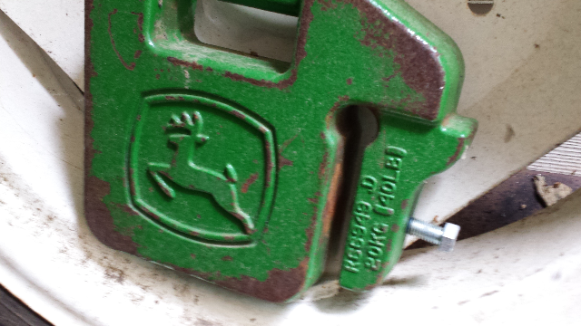

   / Extra weight on a scrape blade #5
I took a similiar approach with suit case weights so I could use them on my back blade and to add more weight to a box blade. I drilled and tapped the weights which allows it to slip on both attachments and lock them in place.
