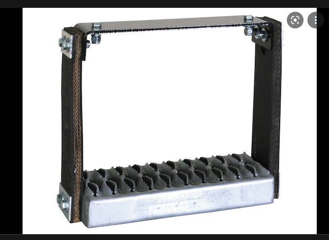

Don't know if there is prefab one but I would suggest to make side wall with flexible material like rubber (belt or mud flap) so you don't get it bend when you go over uneven ground. something like this below
here is the link ...

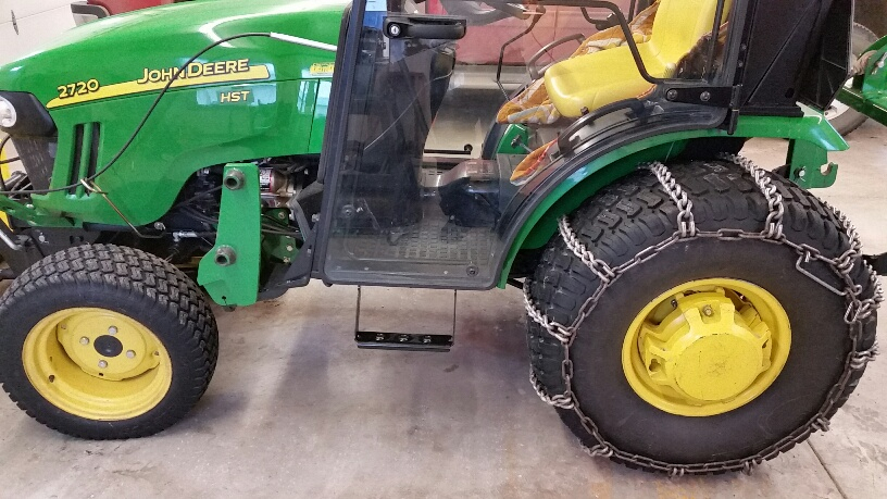

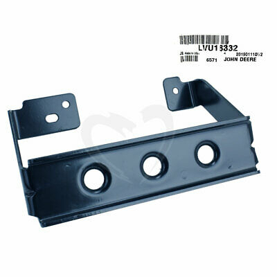

John Deere makes a nice one...LUV18332
I put one on my 2720 for less than $50

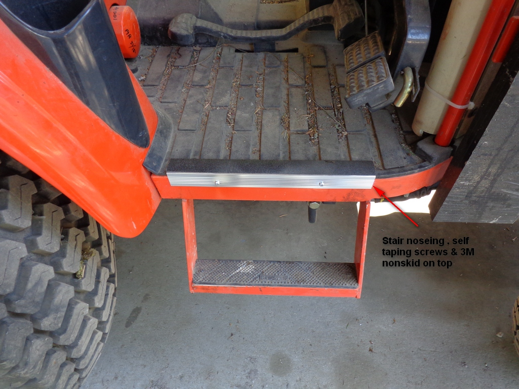

I made this one as well as one for my last 2 tractors , but would have bought one if there was one that would fit for less than $100.
